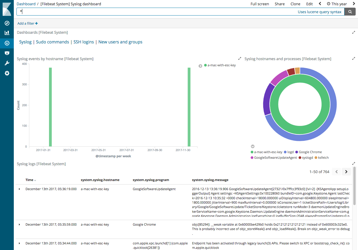

Example dashboards
This module comes with sample dashboards. For example:
kibana system
