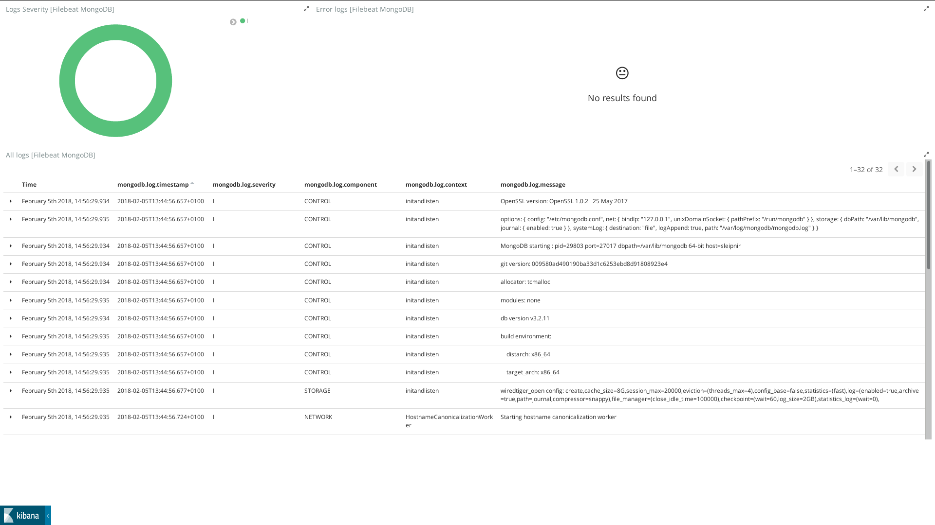

Example dashboardedit
This module comes with one sample dashboard including error and regular logs.
filebeat mongodb overview
