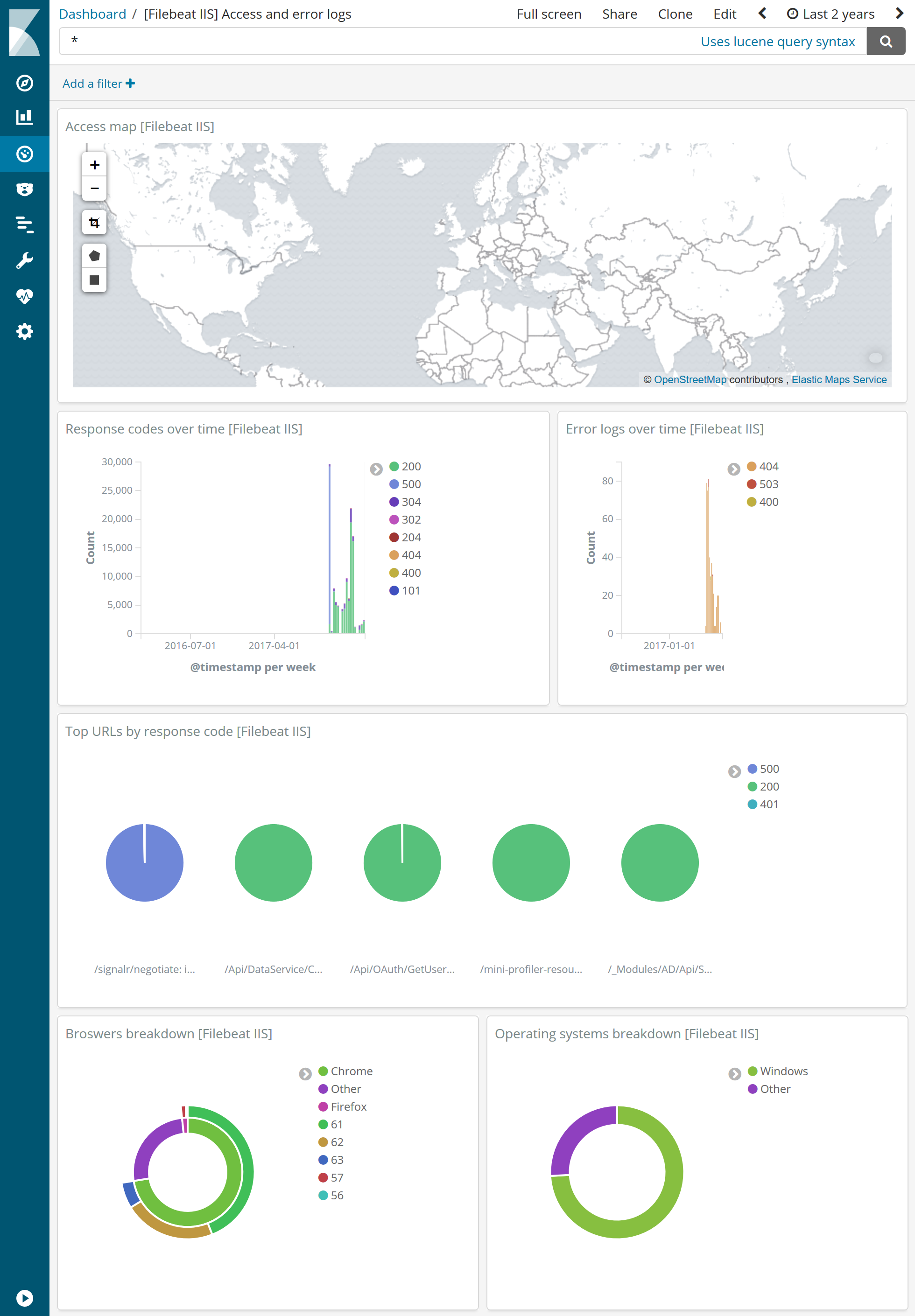

Example dashboardedit
This module comes with a sample dashboard. For example:
