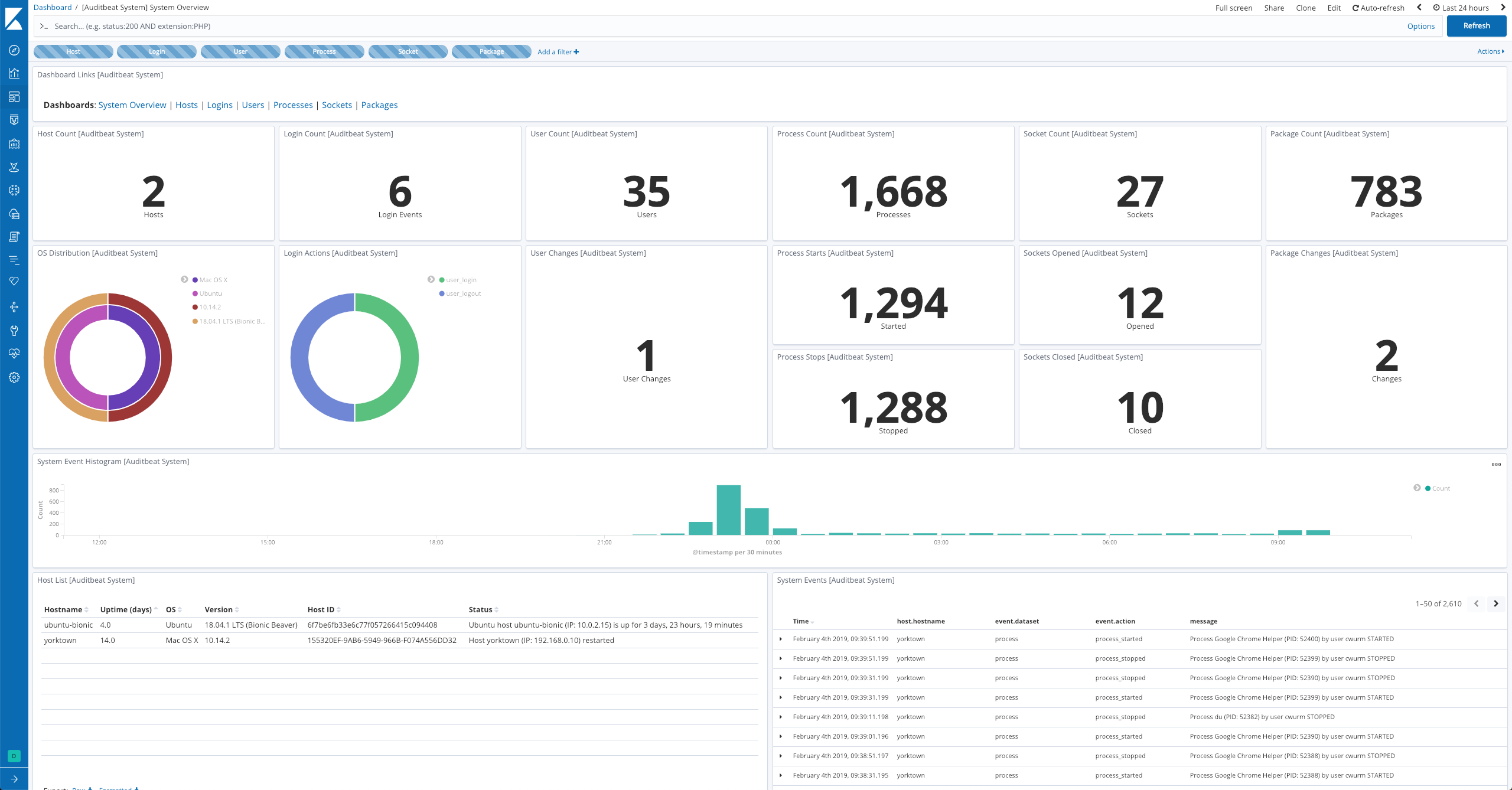

Example dashboardedit
The module comes with a sample dashboard:
Auditbeat System Overview Dashboard
