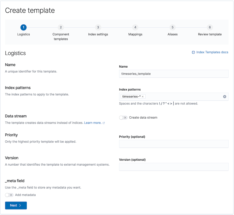

You can use the Kibana Create template wizard to add the template. To access the wizard, open the menu and go to Stack Management > Index Management. In the Index Templates tab, click Create template.
The create template request for the example template looks like this:
