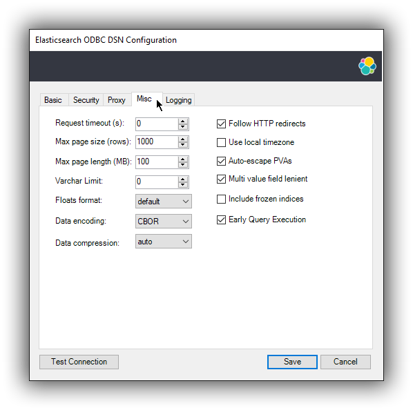

2.5 Connection parametersedit
The connection configuration can further be tweaked by the following parameters.
Request timeout (s)
The maximum time (in seconds) a request to the server can take. This can be overridden by a larger statement-level timeout setting. The value 0 means no timeout.
Max page size (rows)
The maximum number of rows that Elasticsearch SQL server should send the driver for one page. This corresponds to the SQL search API’s
fetch_size
parameter. A0
value indicates a server default. -
Max page length (MB)
The maximum size (in megabytes) that an answer can grow to, before being rejected as too large by the driver. This is concerning the HTTP answer body of one page, not the cumulated data volume that a query might generate.
Varchar limit
The maximum width of the string columns. If this setting is greater than zero, the driver will advertise all the string type columns as having a maximum character length equal to this value and will truncate any longer string to it. The string types are textual fields (TEXT, KEYWORD etc.) and some specialized fields (IP, the GEOs etc.). Note that no interpretation of the value is performed before truncation, which can lead to invalid values if the limit is set too low. This is required for those applications that do not support column lengths as large as Elasticsearch fields can be.
Floats format
Controls how the floating point numbers will be printed, when these are converted to string by the driver. Possible values given to this parameter:
scientific
: the exponential notation (ex.: 1.23E01); -
default
: the default notation (ex.: 12.3); -
auto
: the driver will choose one of the above depending on the value to be printed. Note that the number of decimals is dependent on the precision (or ODBC scale) of the value being printed and varies with the different floating point types supported by Elasticsearch SQL. This setting is not effective when the application fetches from the driver the values as numbers and then does the conversion subsequently itself.
Data encoding
This value controls which data format to encode the REST content in. Possible values are:
CBOR
: use the Concise Binary Object Representation format. This is the preferred encoding, given its more compact format. -
JSON
: use the JavaScript Object Notation format. This format is more verbose, but easier to read, especially useful if troubleshooting.
Data compression
This setting controls if and when the REST content - encoded in one of the above formats - is going to be compressed. The possible values are:
on
: enables the compression; -
off
: disables the compression; -
auto
: enables the compression, except for the case when the data flows through a secure connection; since in this case the encryption layer employs its own data compression and there can be security implications when an additional compression is enabled, the setting should be kept to this value.
Follow HTTP redirects
Should the driver follow HTTP redirects of the requests to the server?
Use local timezone
This setting controlls the timezone of:
- the context in which the query will execute (especially relevant for functions dealing with timestamp components);
the timestamps received from / sent to the server.
If disabled, the UTC timezone will apply; otherwise, the local machine’s set timezone.
Auto-escape PVAs
The pattern-value arguments make use of
_
and%
as special characters to build patern matching values. Some applications however use these chars as regular ones, which can lead to Elasticsearch SQL returning more data than the app intended. With the auto escaping, the driver will inspect the arguments and will escape these special characters if not already done by the application. -
Multi value field lenient
This setting controls the behavior of the server in case a multi-value field is queried. In case this is set and the server encounters such a field, it will pick a value in the set - without any guarantees of what that will be, but typically the first in natural ascending order - and return it as the value for the column. If not set, the server will return an error. This corresponds to the SQL search API’s
field_multi_value_leniency
parameter. -
Include frozen indices
If this parameter is
true
, the server will include the frozen indices in the query execution. This corresponds to Elasticsearch SQL’s request parameterindex_include_frozen
Early query execution
If this configuration is set, the driver will execute a statement as soon as the application submits it for preparation - i.e. early - and is functionally equivalent to a direct execution. This will only happen if the query lacks parameters. Early execution is useful with those applications that inspect the result before actually executing the query. Elasticsearch SQL lacks a preparation API, so early execution is required for interoperability with these applications.
