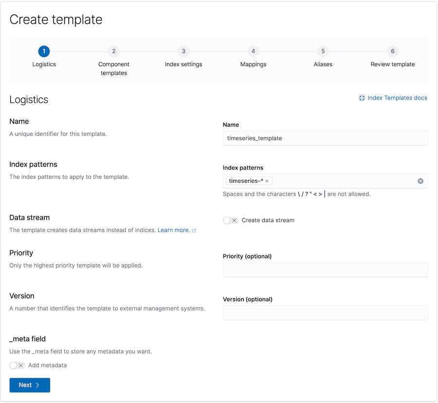

You can use the Kibana Create template wizard to add the template. From Kibana, open the menu and go to Stack Management > Index Management. In the Index Templates tab, click Create template.
This wizard invokes the create or update index template API to create the index template with the options you specify.

You can use the Kibana Create template wizard to add the template. To access the wizard, open the menu and go to Stack Management > Index Management. In the Index Templates tab, click Create template.
The create template request for the example template looks like this:
PUT _index_template/timeseries_template { "index_patterns": ["timeseries-*"], "template": { "settings": { "number_of_shards": 1, "number_of_replicas": 1, "index.lifecycle.name": "timeseries_policy", "index.lifecycle.rollover_alias": "timeseries" } } }
