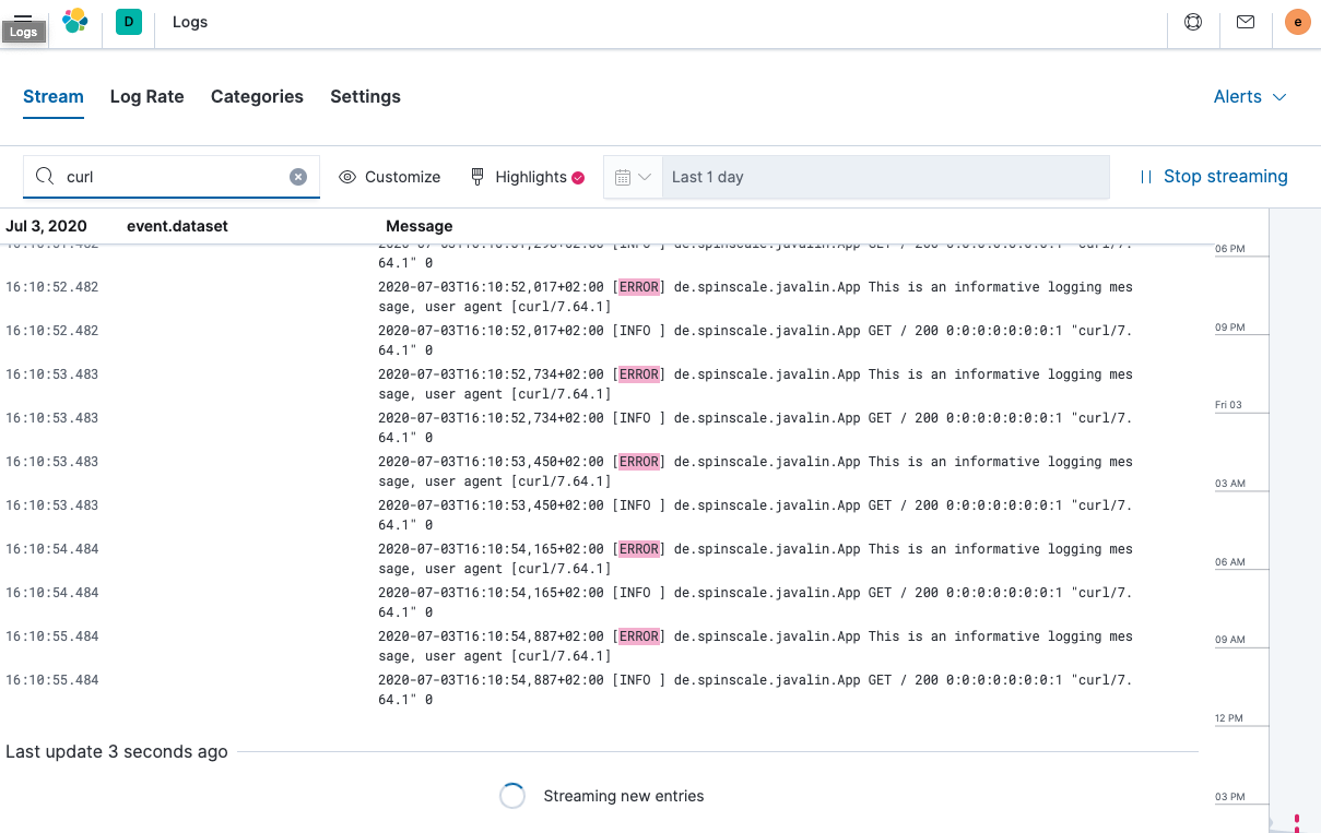

  2. Restart the application and send a request. The logs will be sent to /tmp/javalin/app.log.

  2. Now let’s have a look at the Logs app in Kibana. Select ObservabilityLogs.
    If you want to see the streaming feature at work, run the following curl request in a loop while sleeping.
    while $(sleep 0.7) ; do curl localhost:7000 ; done
  3. To view a continuous stream of log messages, click Stream live. You can also highlight specific terms, as shown here.
    Kibana Logs UI Streaming
    Looking at one of the documents being indexed, you can see that the log message is contained in a single field. Verify this by looking at one of those documents.
    GET filebeat-*/_search
      "size": 1
    Things to note:
    • When you compare the @timestamp field with the timestamp of the log message, you will notice that it differs. This means that you don’t get the results you expect when filtering based on the @timestamp field. The current @timestamp field reflects the timestamp when the event was created within Filebeat, not the timestamp of when the log event occurred in the application.
    • One cannot filter on specific fields like the HTTP verb, the HTTP status code, the log level or the class that generated the log message

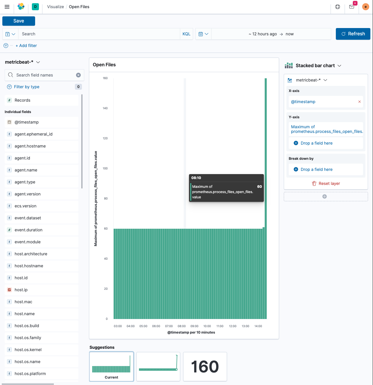

Visualize open files over time
The second visualization is to be a check for the number of open files in our application.
As no one can remember all the field names, let’s again look at the metrics output again first.
curl -s localhost:7000/metrics -u metrics:secret | grep ^process
process_files_max_files 10240.0
process_cpu_usage 1.8120711232436825E-4
process_uptime_seconds 72903.726
process_start_time_seconds 1.594048883317E9
process_files_open_files 61.0
Let’s look at the process_files_open_files metric. This should be a rather static value that rarely changes. If you run an application which stores data within the JVM or opens and closes network sockets, this metric increases and decreases depending on the load. With a web application, this is rather static. Let’s figure out why there are 60 files open on our small web application.
  1. Run jps that will contain your App in the process list.
    $ jps
    14224 Jps
    82437 Launcher
    82438 App
    40895
  2. Use lsof on that process.
    $ lsof -p 82438
    You will see more output than just all the files being opened, as a file is also a TCP connection happening right now.

  5. Below Add filter, select the metricbeat-* index pattern. This will likely use filebeat-* as the default.
    The x-axis uses the @timestamp field - which in turn will create a date_histogram aggregation again. The y-axis should not be the document count, as that one will always be stable, but the maximum value of the documents in the buckets. Click on the right of the field name on the y-axis and select Max. This gives you a similar visualization than shown, with a peak where you ran the wrk command above.

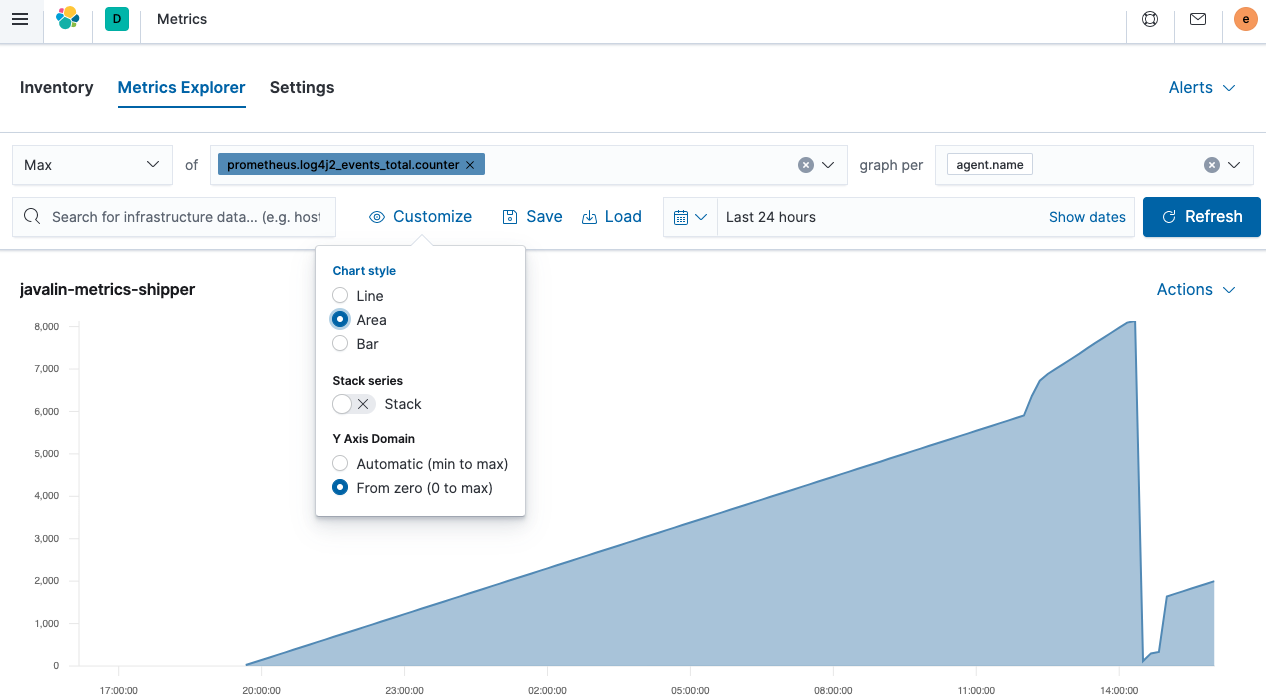

  6. Now let’s have a look at the Infrastructure app in Kibana. Select ObservabilityInfrastructure.
    You will only see data from a single shipper. Still, the moment you are running several services and the ability to group this per Kubernetes pod or host enables you to spot hosts with elevated CPU or memory consumption.
  7. Click Metrics Explorer, you can start exploring your data for specific hosts or the CPU usage across your nodes.
    Metrics UI Log Counter
    This is an area chart of the total events counter the Javalin app emits. It’s rising because there is a component polling an endpoint that, in turn, produces another log message. The steeper peek was due to sending more requests. But where is the sudden drop-off coming from? A JVM restart. As those metrics are not persisted, they reset on a JVM restart. With that in mind, it’s often better to log the rate instead of the counter field.

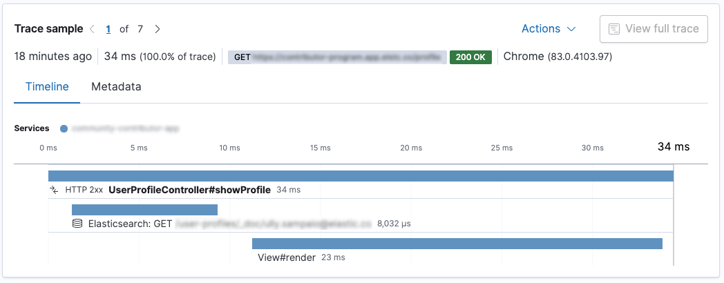

Data Model
Despite a heavily fragmented APM landscape, the terminology often is similar. The two most important terms are Spans and Transactions.
A transaction encapsulates a series of spans, which contain information about the execution of a piece of code. Let’s take a look at this screenshot from the Kibana APM app.
A transaction with spans
This is a Spring Boot application. The UserProfileController.showProfile() method is called, which is marked as the transaction. There are two spans within. First, a request is sent to Elasticsearch using the Elasticsearch REST client, and after the response is rendered using Thymeleaf. The request to Elasticsearch is faster than the rendering in this case.

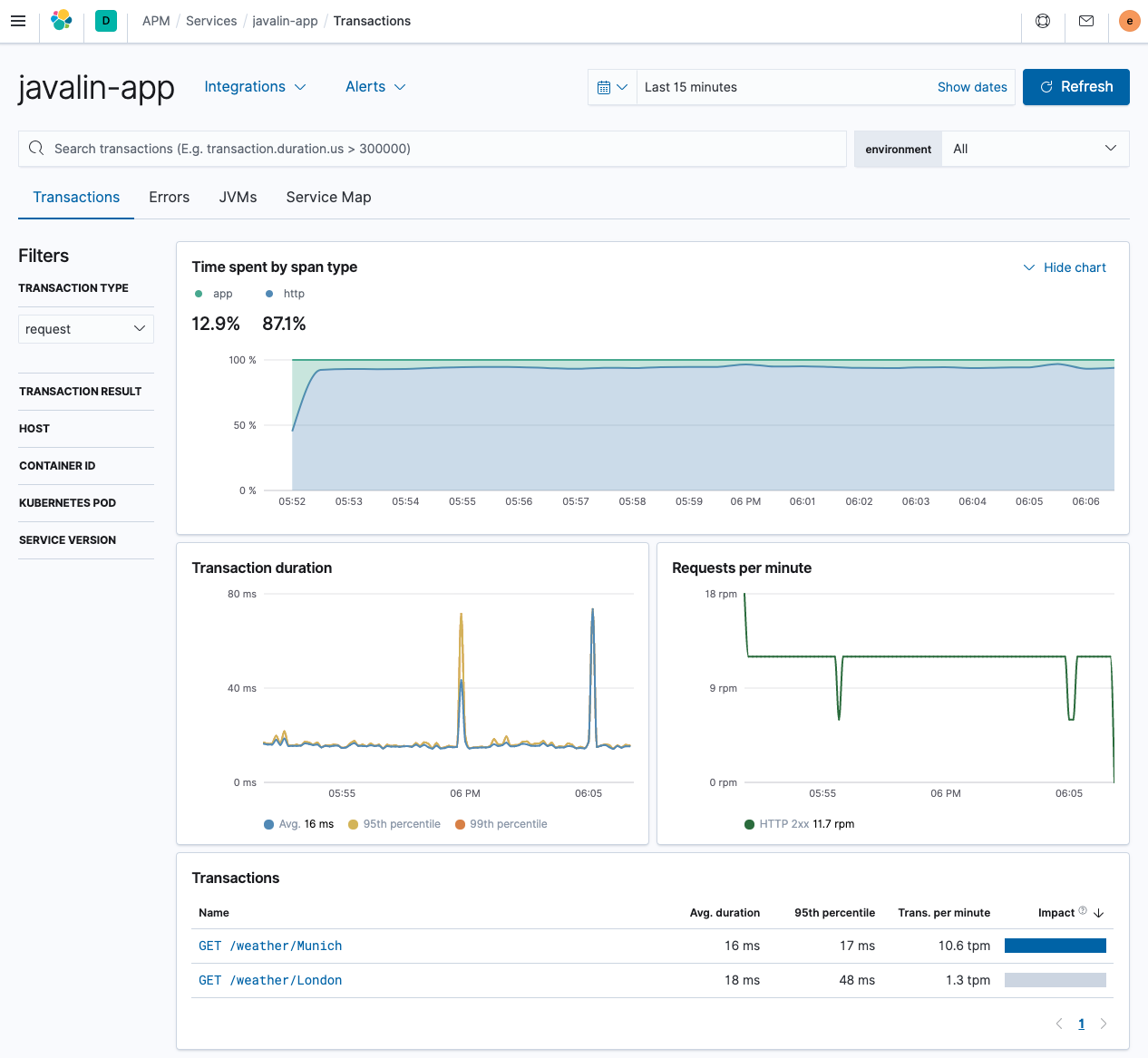

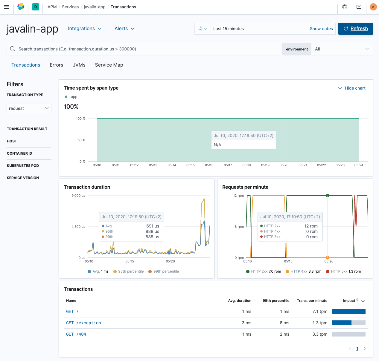

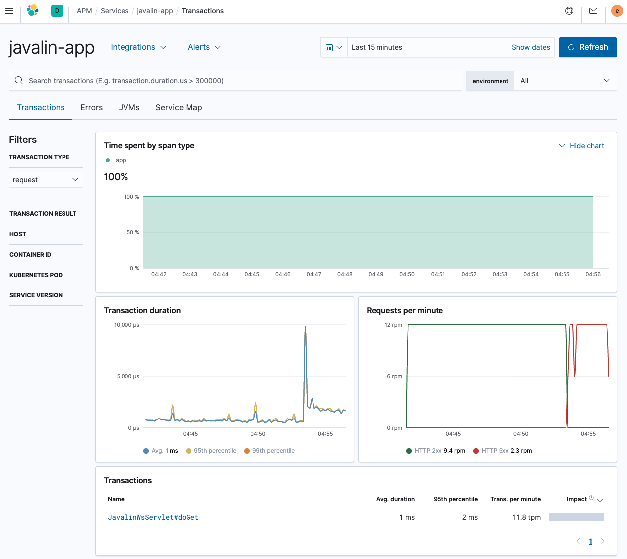

    Wait a few minutes and let’s finally take a look at the APM app.
    Javalin App APM UI
    As you can see, this is quite the difference to the Spring Boot application shown earlier. The different endpoints are not listed; we can see the requests per minute though including errors.
    The only transaction comes from a single servlet, which is not too helpful. Let’s try to fix this by introducing custom programmatic transactions.
Custom transactions
  1. Add another dependency.
    dependencies {
      implementation 'co.elastic.apm:apm-agent-attach:1.17.0'
      implementation 'co.elastic.apm:apm-agent-api:1.17.0'
  2. Fix the name of the transactions to include the HTTP method and the request path
    app.before(ctx -> ElasticApm.currentTransaction()
      .setName(ctx.method() + " " + ctx.path()));
  3. Restart your app and see data flowing in. Test a few different endpoints, especially the one that throws exceptions and the one that triggers a 404.
    APM UI with correct transaction names
    This looks much better, having differences between endpoints.

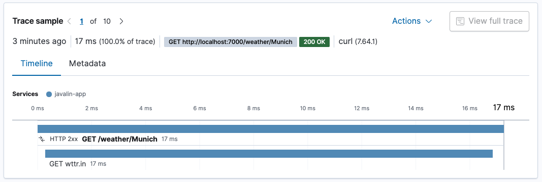

  5. Curl http://localhost:7000/weather/Munich and see a one-line response about the current weather. Let’s check the APM UI.
    In the overview, you can see that most time is spent in the HTTP client, which is not surprising.
    Overview
    Our transactions for the /weather/Munich now contain a span, showing how much time is spent on retrieving the weather data. Because the HTTP client is instrumented automatically, there is no need to do anything.
    Transaction with span
    If the city parameter if that URL is of high cardinality, this will result in a high amount of URLs mentioned instead of the generic endpoint. If you would like to prevent this, a possibility would be to use ctx.matchedPath() to log every call to the weather API as GET /weather/:city. This however requires some refactoring by removing the app.before() handler and replacing it with a app.after() handler.
