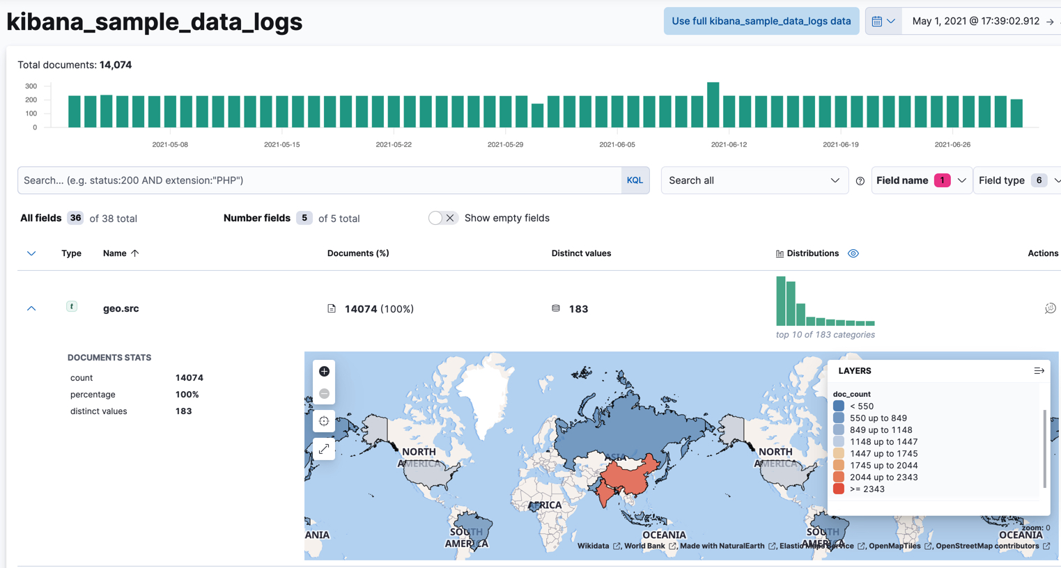

Explore your data
editIf you have fields that contain valid vector layers, you can use the Data Visualizer in the Machine Learning app to see a choropleth map, in which each area is colored based on its document count. For example:
