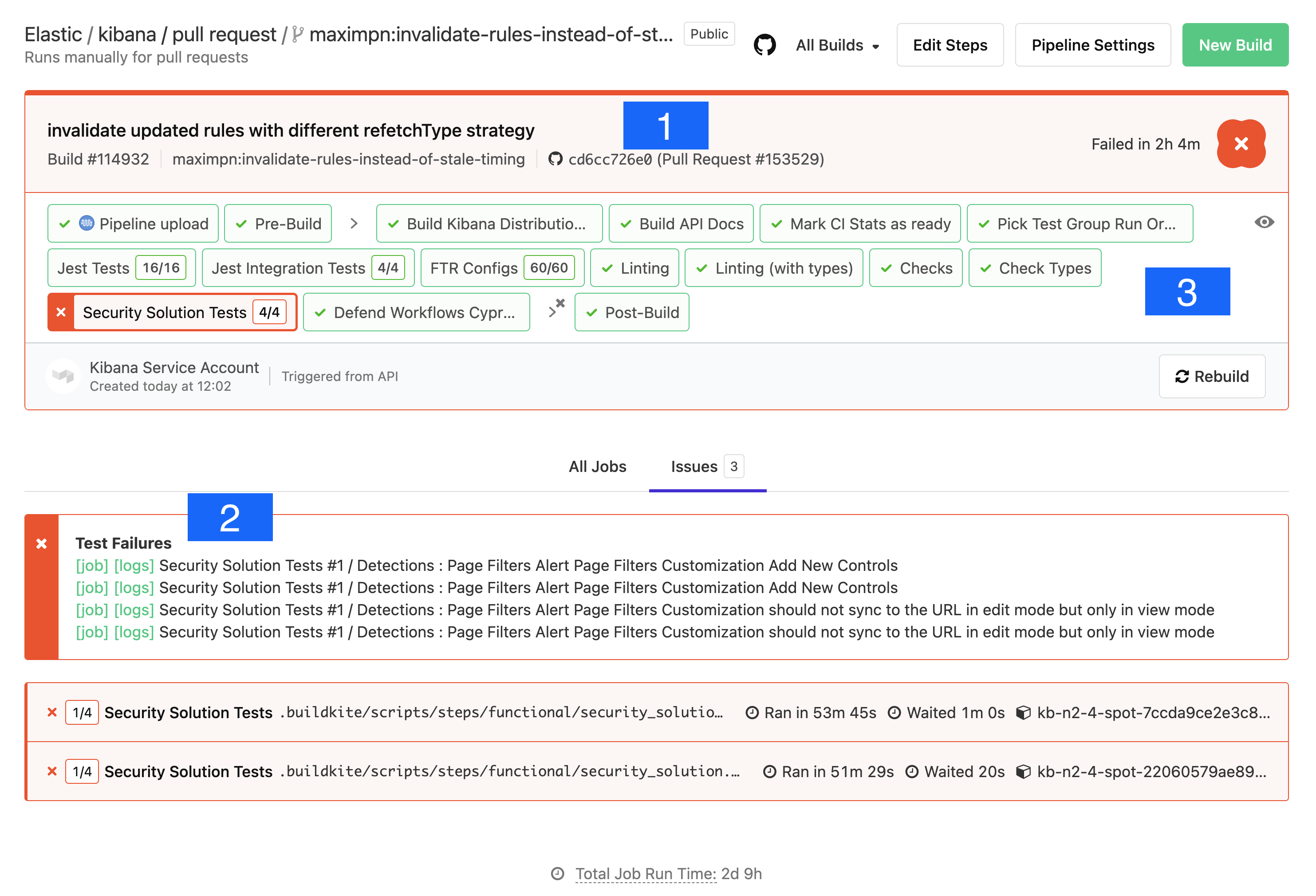

To view the results of a job execution in Buildkite, either click the link in the comment left by @elasticmachine or search for the kibana-ci check in the list at the bottom of the PR. This link will take you to the top-level page for the specific job execution that failed.
Buildkite pipeline view showing a few test failures
  1. Git commit: the git commit that caused this build.
  2. Test Results: A link to the test results screen, and shortcuts to the logs and jobs of the failed tests. Functional tests capture and store the log output from each specific test, and make it visible at these links.
  3. Pipeline Steps:: A breakdown of the pipeline that was executed, along with individual log output for each step in the pipeline.

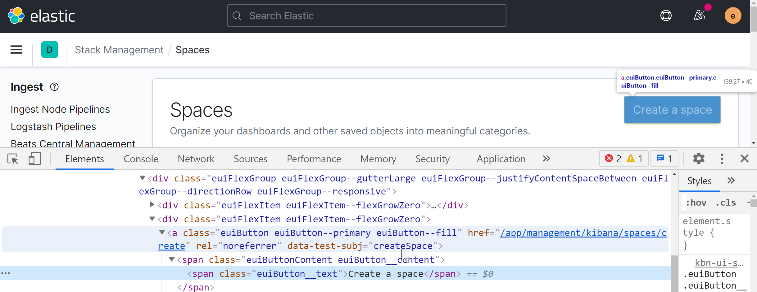

If we use a running Kibana instance and inspect elements, we find that the createSpace data-test-subj attribute is on this button in the Spaces page in Stack Management:
Kibana screenshot of Spaces page with developer tools open
We know the test was not on the correct page to find the element to click. We see in the debug log the repeated attempts to find the element. If we scroll to the start of those repeated attempts, we see that the first thing the test did was this attempt to click on the createSpace element.
