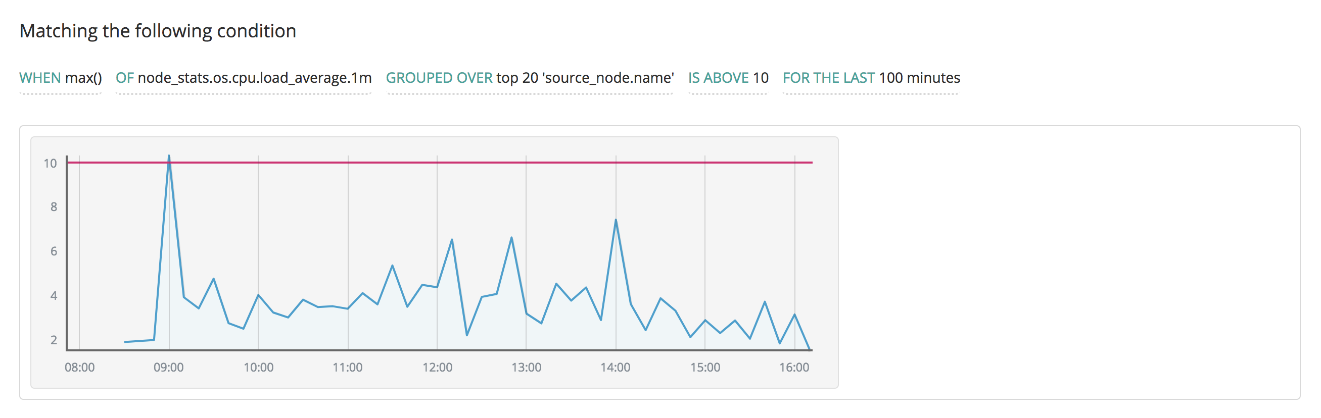

Here are a few examples of common alerts based on x-pack monitoring data:
  • High heap usage: Threshold Alert Example High Heap Usage
  • System load: Threshold Alert Example System Load

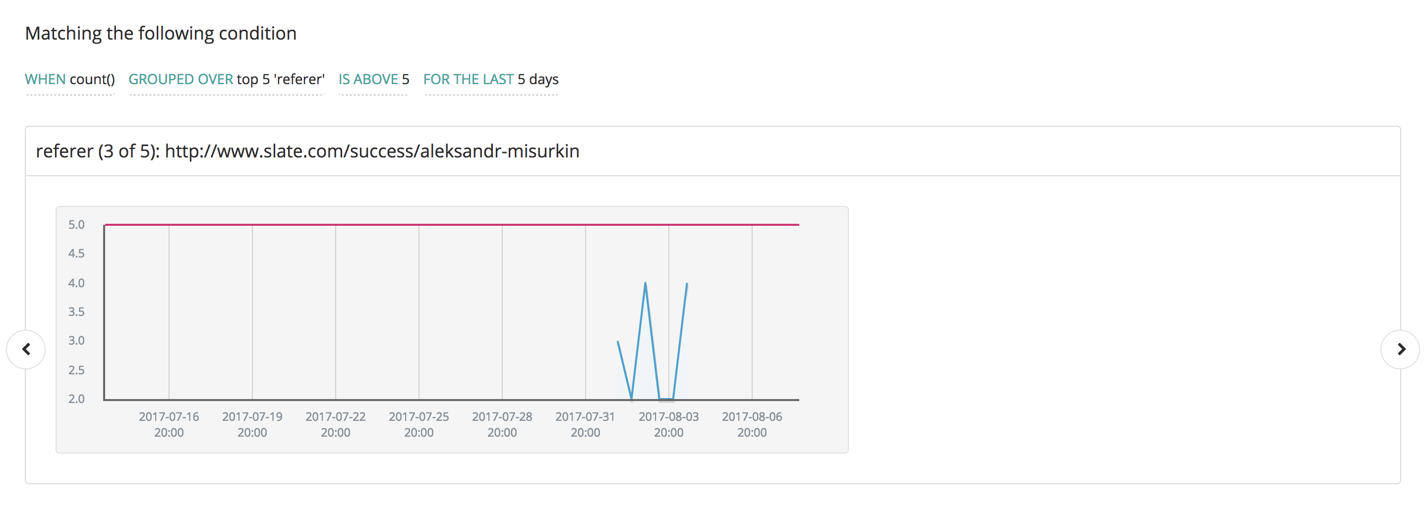

Here are some specifics of how the visualization works:
  • The time window that is used in the visualization is calculated by taking the duration defined in the expression and multiplying it by 5. So, if you select FOR THE LAST 5 hours, the visualization will show data from the last 25 hours.
  • In the chart, you will see a blue line that represents the aggregated data. There is also a red line that represents the threshold value.
  • If you use the terms aggregation to aggregate over a specific field, there will be multiple visualizations available and pagination controls will appear as shown below.
    • Threshold Alert Group By pagination

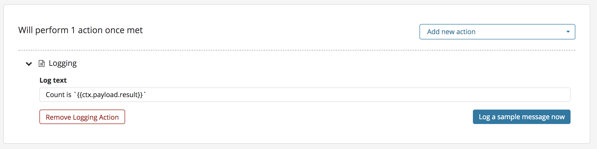

Actions
Here you can configure the various actions that will occur when the alert fires.
Click Add new action to trigger a dropdown selection:
Threshold Alert Select Action
Selecting an action will allow you to customize settings for the respective action.
Threshold Alert Logging Action
All fields for an alert support using mustache syntax and expose a {{ctx}} variable which exposes various properties of the alert
