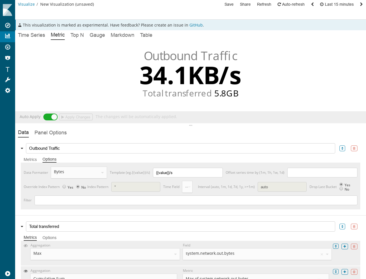

Metricedit
A visualization for displaying the latest number in a series. This visualization supports 2 metrics; a primary metric and a secondary metric. The labels and backgrounds can be fully customizable based on a set of rules.

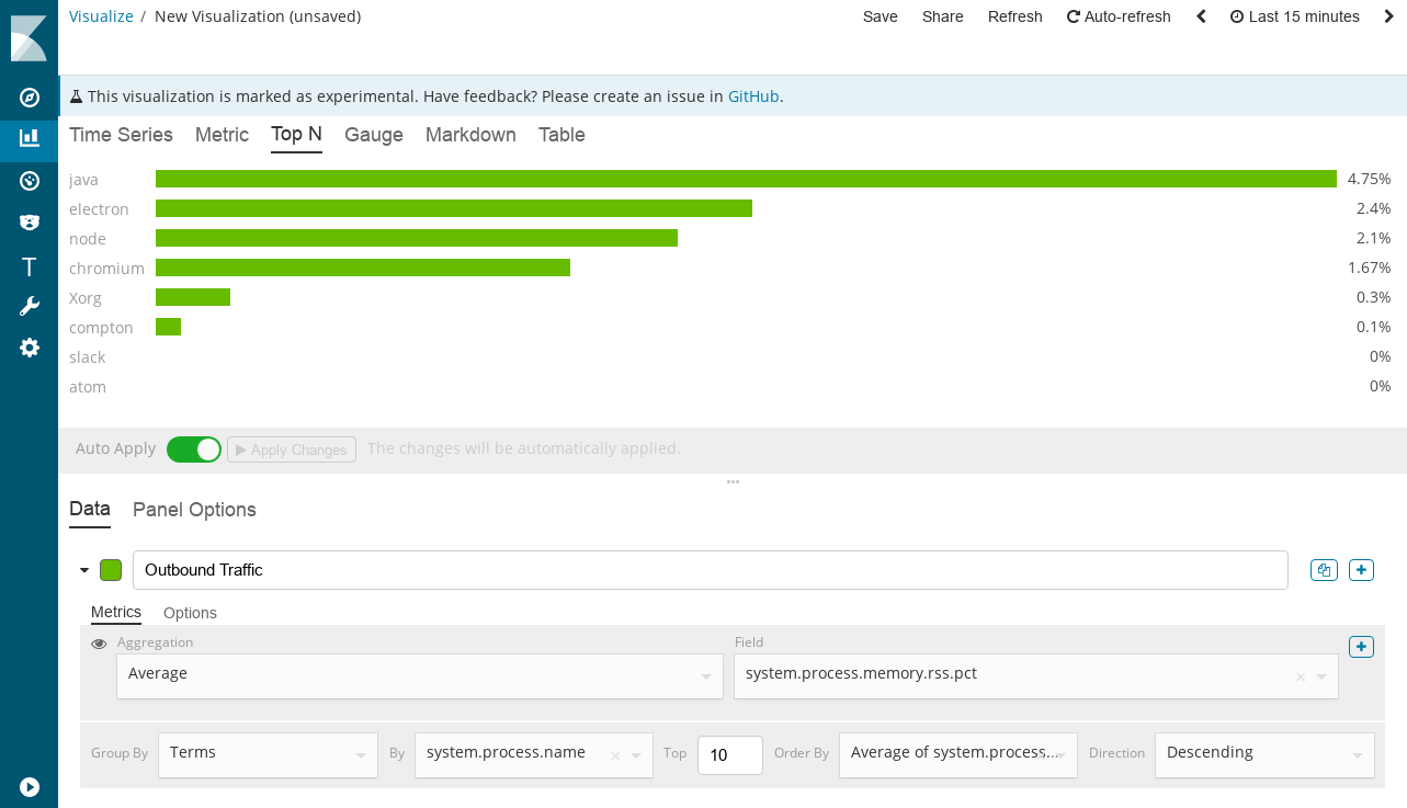

Top Nedit
This is a horizontal bar chart where the y-axis is based on a series of metrics and the x-axis is the latest value in those series; sorted in descending order. The color of the bars are fully customizable based on set of rules.

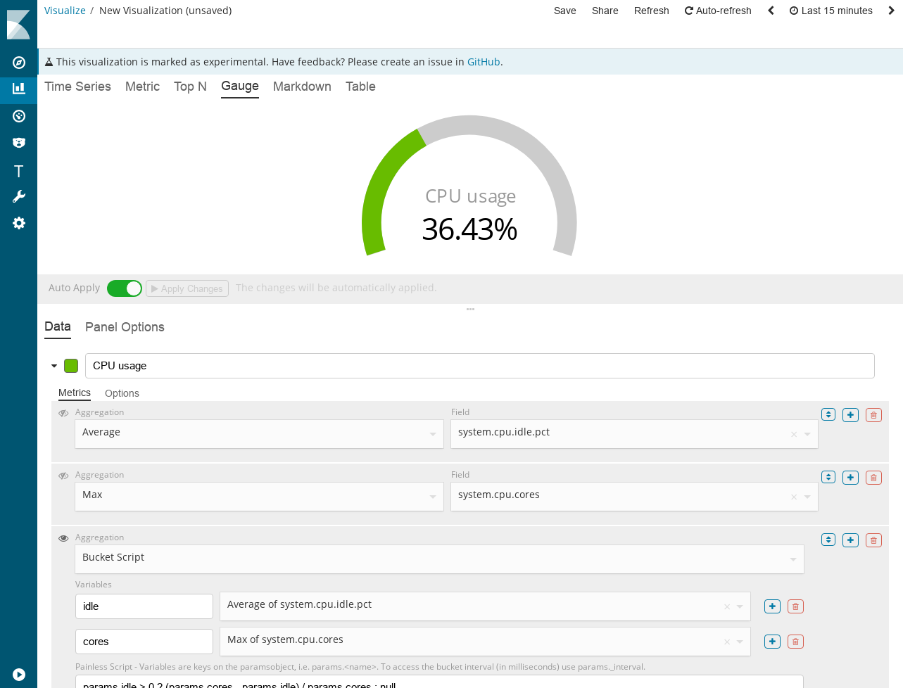

Gaugeedit
This is a single value gauge visualization based on the latest value in a series. The face of the gauge can either be a half-circle gauge or full-circle. You can customize the thicknesses of the inner and outer lines to achieve a desired design aesthetic. The color of the gauge and the text are fully customizable based on a set of rules.

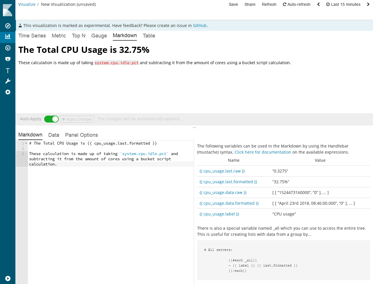

Markdownedit
This visualization allows you to enter Markdown text and embed Mustache template syntax to customize the Markdown with data based on a set of series.

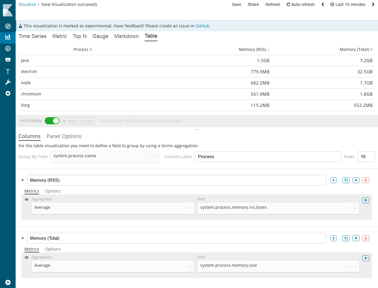

Tableedit
A table visualization allows you to display data from multiple time series. You define which field group to show in the rows and what columns of data to display.
