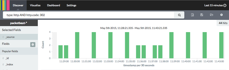

Creating Queries
The search field on the Discover page provides a way to query a specific subset of transactions from the selected time frame. The query syntax is based on the Lucene query syntax. It allows boolean operators, wildcards, and field filtering. For example, if you want to find the HTTP redirects, you can search for type: http AND http.code: 302.
Kibana query

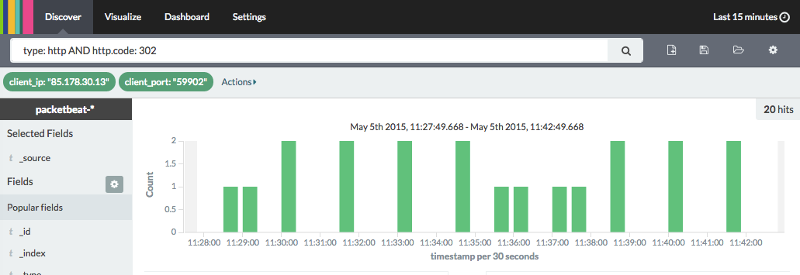

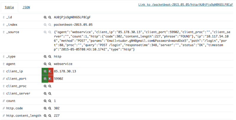

Creating Filters
In Kibana, you can also filter transactions by clicking on elements within a visualization. For example, to filter for all the HTTP redirects that are coming from a specific IP and port, click the "Filter for value" icons (highlighted in green below) for the client_ip and client_port fields in the transaction detail widget. To exclude the HTTP redirects coming from the IP and port, click the icons highlighted in red.
Filter from context
The selected filters appear under the search box.
