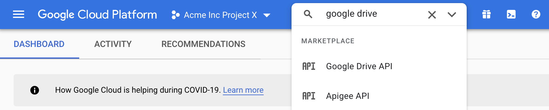

Step 3. Using the search bar located at the top of the console, navigate to the Google Drive API:

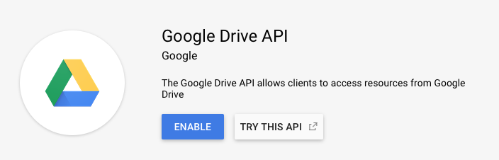

Step 4. Enable access to the Google Drive API for this project:

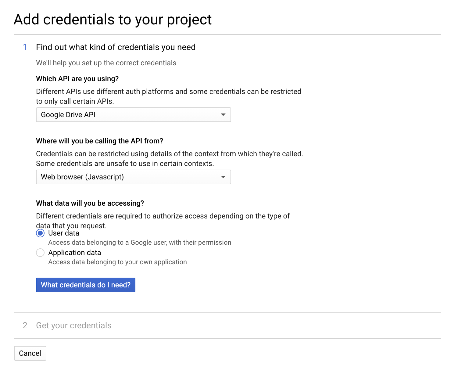

Step 6. Select Google Drive API as the API you are using. You will call it from Web browser to access User data:
Step 7. Click What credentials do I need?, and select the Set up consent screen option:

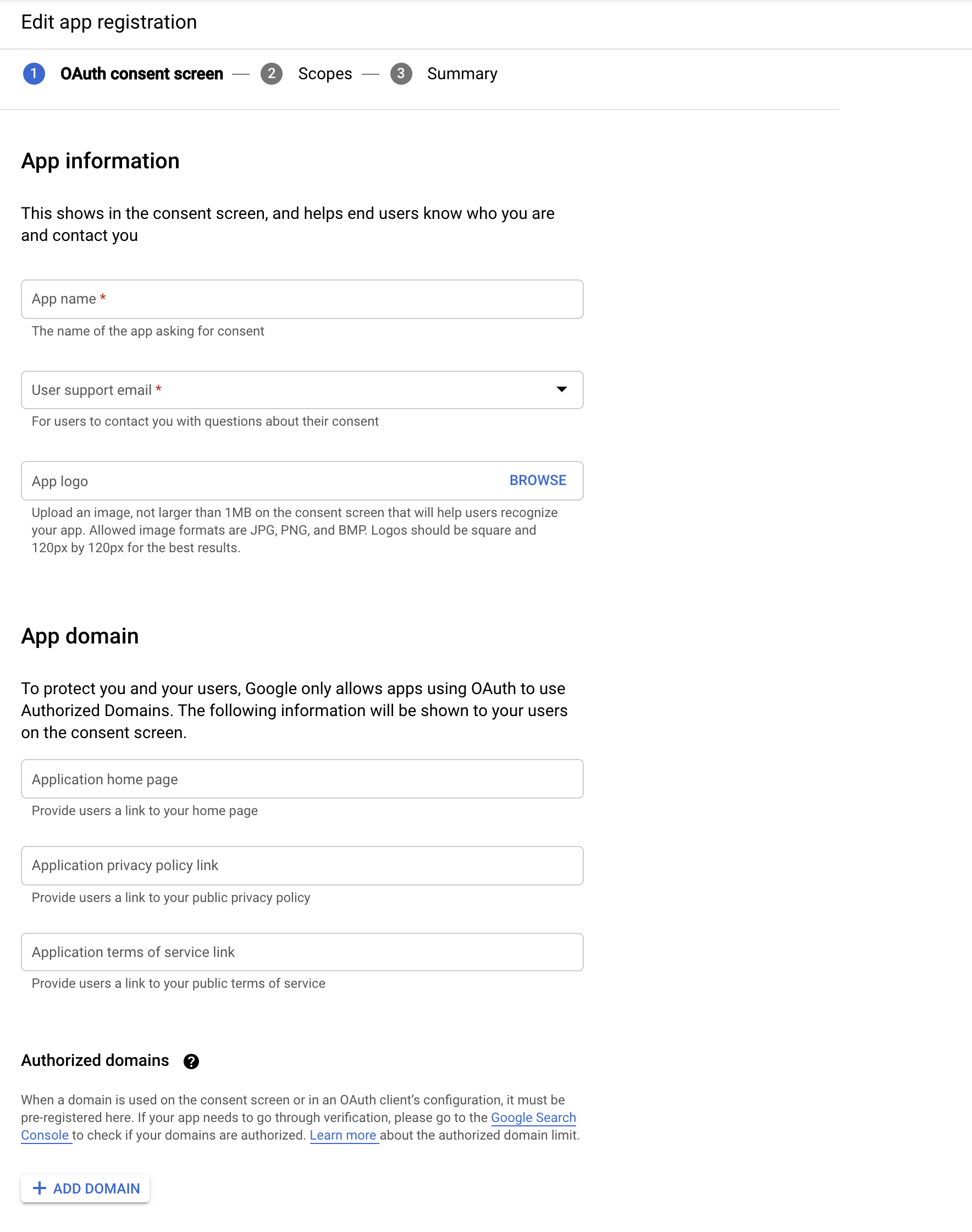

Step 9. Fill out the information in the OAuth Consent Screen form.

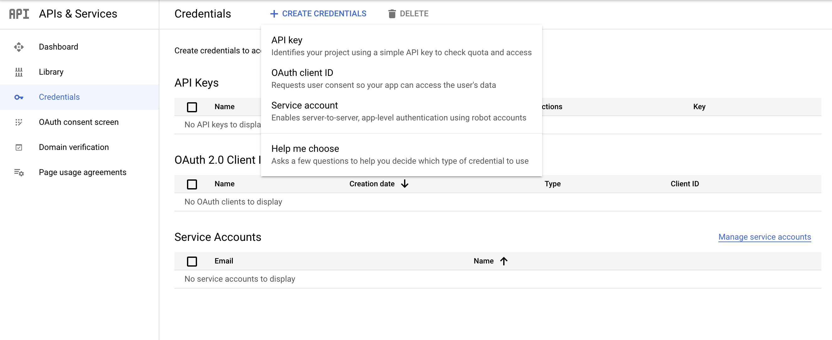

Step 11. We must now create credentials for the OAuth application. Locate the Credentials menu item in the left sidebar, click Create Credentials and select OAuth Client ID.

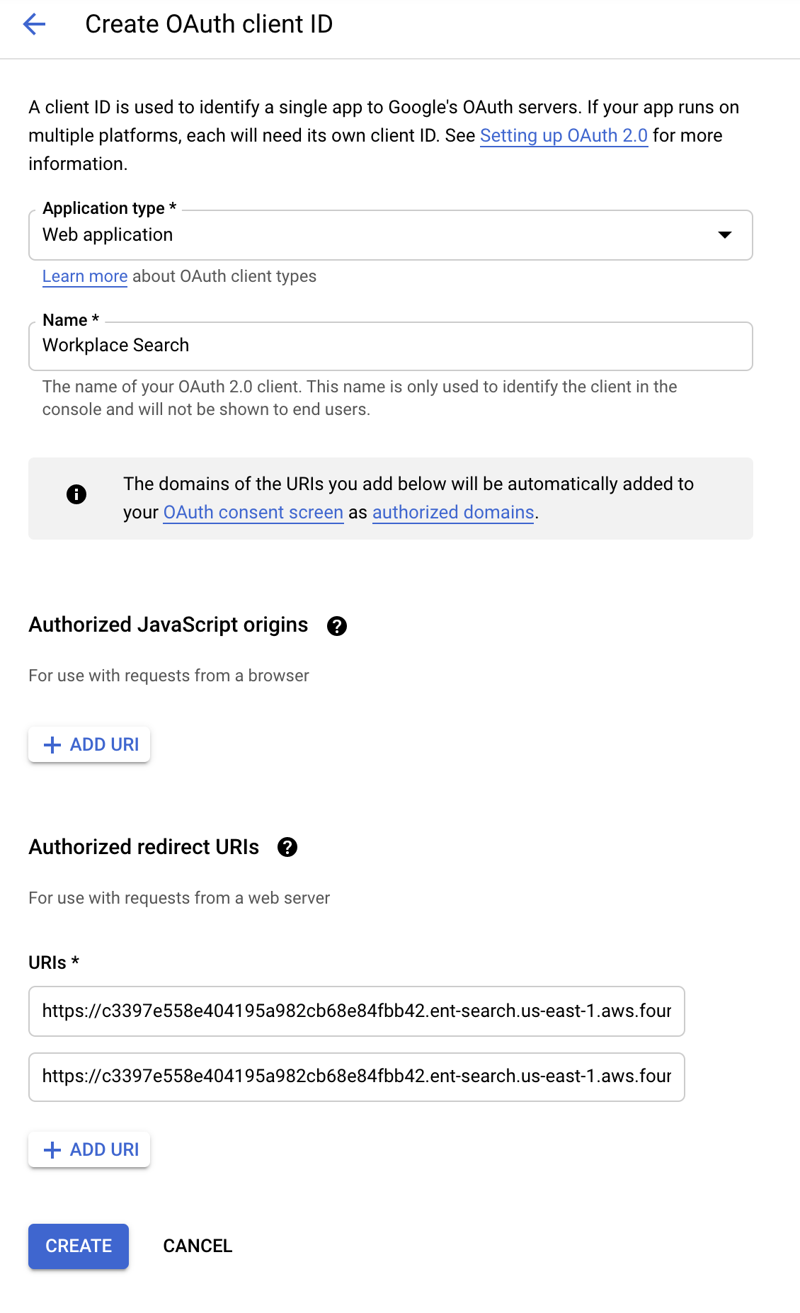

Step 12. Fill out the OAuth form:
- Application type: Web application.
- Name: Whichever feels best for you. Workplace Search makes sense, keeps things clear.
Authorized redirect URIs: The redirect URIs for your Workplace Search installation.
The redirect URIs required vary by which user interface you are using to manage Enterprise Search. Enterprise Search in Kibana and standalone Enterprise Search use different redirect URIs. See user interfaces for details on each UI.
When using standalone Enterprise Search use the following two URLs, substituting
<WS_BASE_URL>with the base URL at which Workplace Search is hosted (scheme + host, no path).<WS_BASE_URL>/ws/org/sources/google_drive/create <WS_BASE_URL>/ws/sources/google_drive/create
Examples:
# Deployment using a custom domain name https://www.example.com/ws/org/sources/google_drive/create https://www.example.com/ws/sources/google_drive/create # Deployment using a default Elastic Cloud domain name https://c3397e558e404195a982cb68e84fbb42.ent-search.us-east-1.aws.found.io:443/ws/org/sources/google_drive/create https://c3397e558e404195a982cb68e84fbb42.ent-search.us-east-1.aws.found.io:443/ws/sources/google_drive/create # Unsecured local development environment http://localhost:3002/ws/org/sources/google_drive/create http://localhost:3002/ws/sources/google_drive/create
