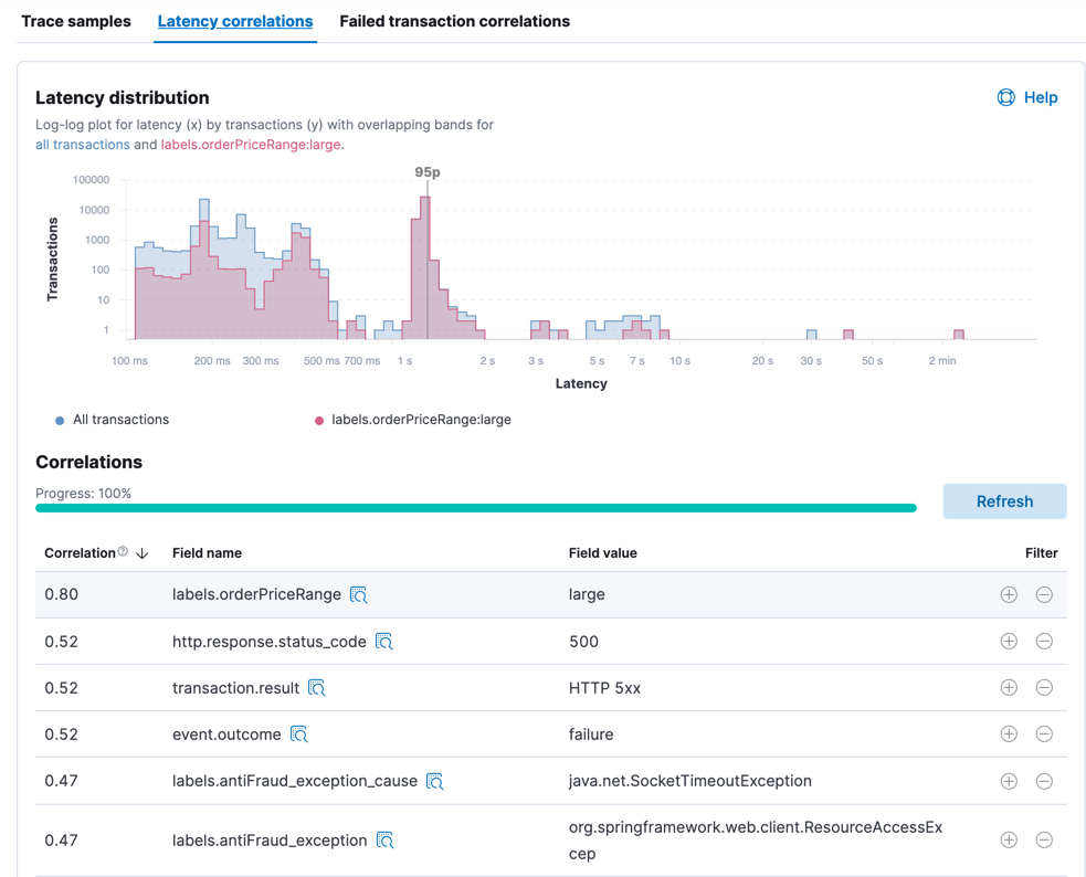

Find high transaction latency correlationsedit
The correlations on the Latency correlations tab help you discover which attributes are contributing to increased transaction latency.
APM latency correlations
The progress bar indicates the status of the asynchronous analysis, which performs statistical searches across a large number of attributes. For large time ranges and services with high transaction throughput, this might take some time. To improve performance, reduce the time range.
The latency distribution chart visualizes the overall latency of the transactions in the transaction group. If there are attributes that have a statistically significant correlation with slow response times, they are listed in a table below the chart. The table is sorted by correlation coefficients that range from 0 to 1. Attributes with higher correlation values are more likely to contribute to high latency transactions. By default, the attribute with the highest correlation value is added to the chart. To see the latency distribution for other attributes, select their row in the table.
If a correlated attribute seems noteworthy, use the Filter quick links:
  • + creates a new query in the Applications UI for filtering transactions containing the selected value.
  • - creates a new query in the Applications UI to filter out transactions containing the selected value.
You can also click the icon beside the field name to view and filter its most popular values.
In this example screenshot, there are transactions that are skewed to the right with slower response times than the overall latency distribution. If you select the + filter in the appropriate row of the table, it creates a new query in the Applications UI for transactions with this attribute. With the "noise" now filtered out, you can begin viewing sample traces to continue your investigation.

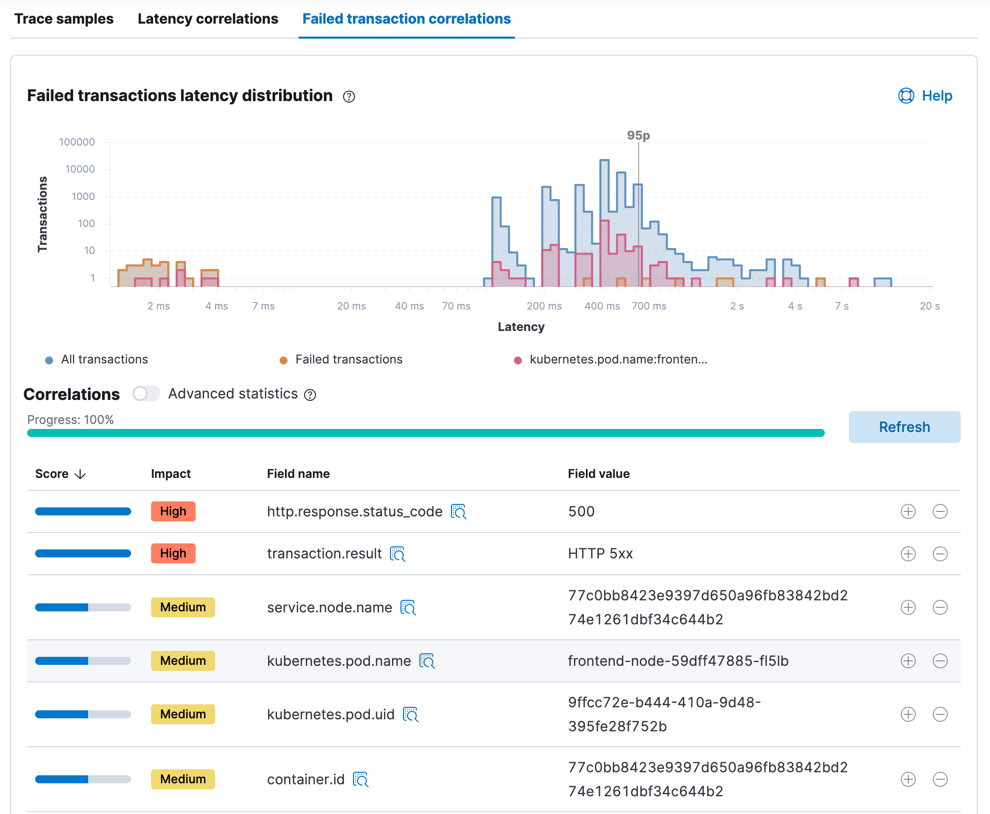

Find failed transaction correlationsedit
The correlations on the Failed transaction correlations tab help you discover which attributes are most influential in distinguishing between transaction failures and successes. In this context, the success or failure of a transaction is determined by its event.outcome value. For example, APM agents set the event.outcome to failure when an HTTP transaction returns a 5xx status code.
The chart highlights the failed transactions in the overall latency distribution for the transaction group. If there are attributes that have a statistically significant correlation with failed transactions, they are listed in a table. The table is sorted by scores, which are mapped to high, medium, or low impact levels. Attributes with high impact levels are more likely to contribute to failed transactions. By default, the attribute with the highest score is added to the chart. To see a different attribute in the chart, select its row in the table.
For example, in the screenshot below, there are attributes such as a specific node and pod name that have medium impact on the failed transactions.
Select the + filter to create a new query in the Applications UI for transactions with one or more of these attributes. If you are unfamiliar with a field, click the icon beside its name to view its most popular values and optionally filter on those values too. Each time that you add another attribute, it is filtering out more and more noise and bringing you closer to a diagnosis.
