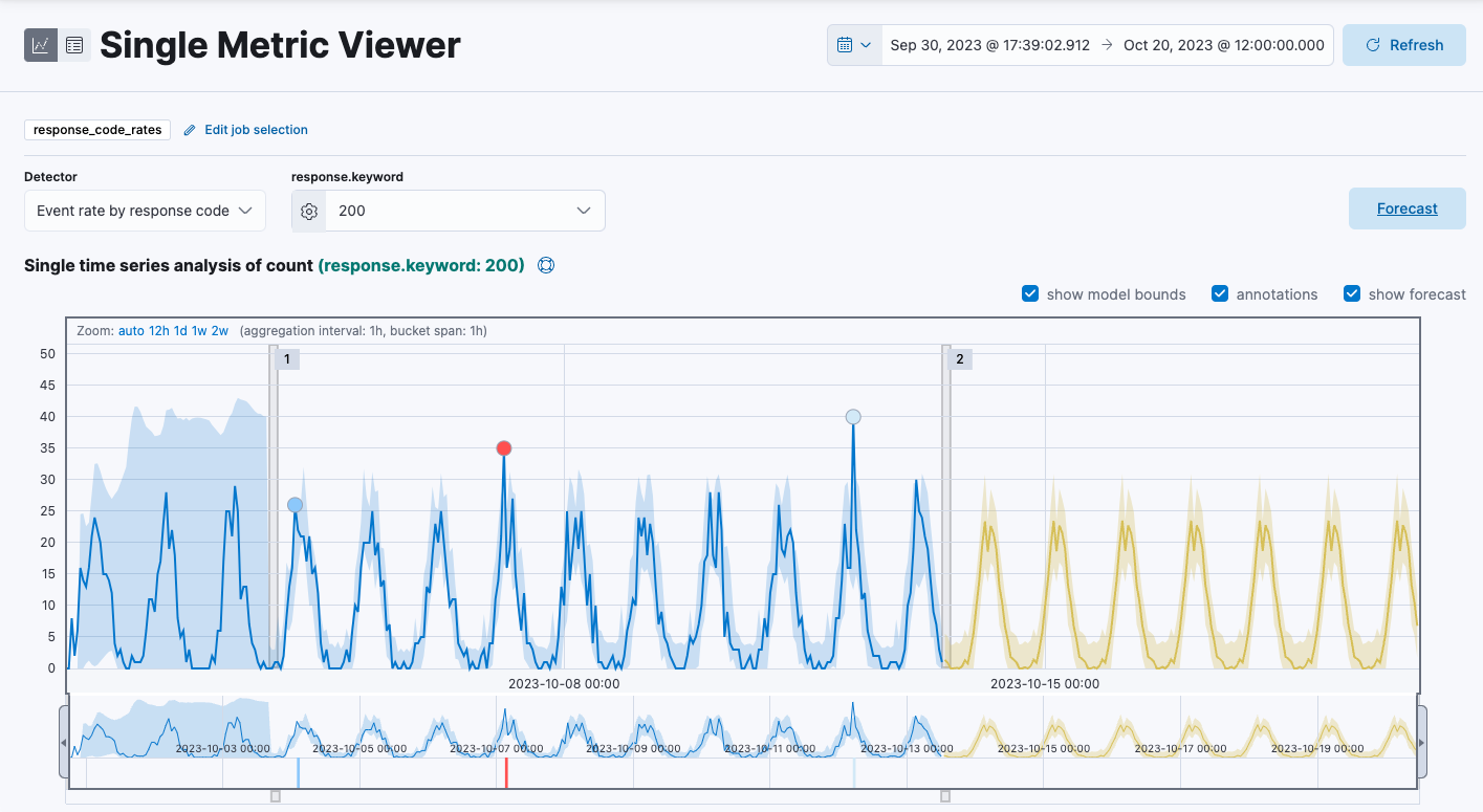

  5. View the forecast in the Single Metric Viewer:
    Single Metric Viewer showing forecast
    • The line in the chart represents the predicted data values.
    • The shaded area represents the bounds for the predicted values, which also gives an indication of the confidence of the predictions.
    • Note that the bounds generally increase with time (that is to say, the confidence levels decrease), since you are forecasting further into the future. Eventually if the confidence levels are too low, the forecast stops.
