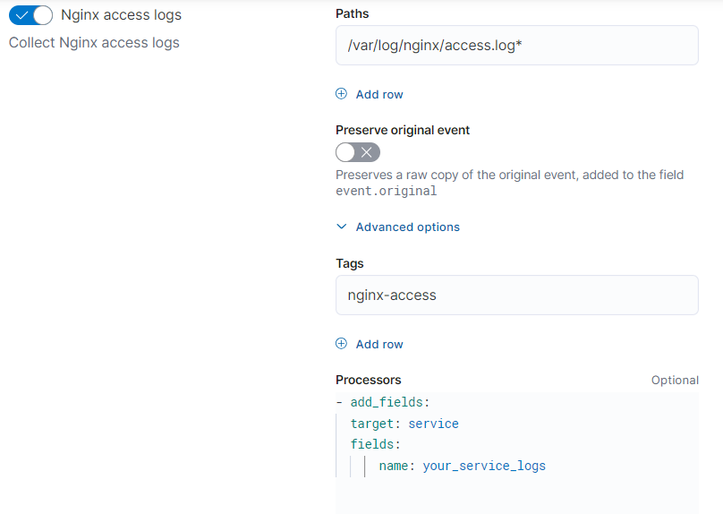

Adding the add_fields processor to an integration’s settings would add your_service_name as the service.name field:
Add the add_fields processor to an integration
