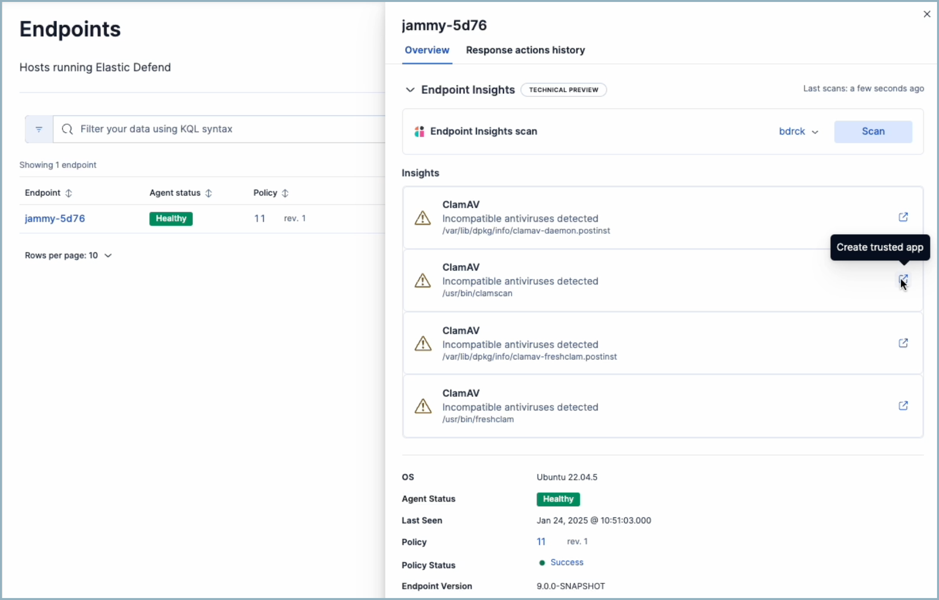

  1. Find Endpoints in the navigation menu or use the global search field.
  2. Click on an endpoint to open its details flyout, then under Endpoint Insights, click Endpoint Insights scan.
  3. Select an LLM connector, or add a new one.
  4. Click Scan. After a brief processing period, any detected AV products will appear under Insights.
Endpoint Insights results with the "Create trusted app" button highlighted
Resolve incompatibilities
After a scan has completed, you can click the Create trusted app button to the right of a result to quickly add the associated AV program to Elastic Defend’s trusted applications list. If the button is not clickable, you don’t have the required privilege.
If you plan to use Elastic Defend alongside third-party AV software, we recommend you that you both allowlist Elastic Endpoint in your AV and make the AV a trusted application.
