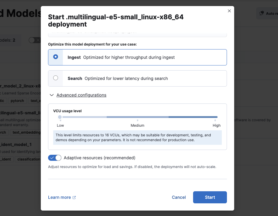

Enabling autoscaling in Kibana - adaptive resources
You can enable adaptive resources for your models when starting or updating the model deployment. Adaptive resources make it possible for Elasticsearch to scale up or down the available resources based on the load on the process. This can help you to manage performance and cost more easily. When adaptive resources are enabled, the number of VCUs that the model deployment uses is set automatically based on the current load. When the load is high, the number of VCUs that the process can use is automatically increased. When the load is low, the number of VCUs that the process can use is automatically decreased.
You can choose from three levels of resource usage for your trained model deployment; autoscaling will occur within the selected level’s range.
Refer to the tables in the auto-scaling-matrix section to find out the settings for the level you selected.
ML model deployment with adaptive resources enabled.
Search projects are given access to more processing resources, while Security and Observability projects have lower limits. This difference is reflected in the UI configuration: Search projects have higher resource limits compared to Security and Observability projects to accommodate their more complex operations.
On Serverless, adaptive allocations are automatically enabled for all project types. However, the "Adaptive resources" control is not displayed in Kibana for Observability and Security projects.
