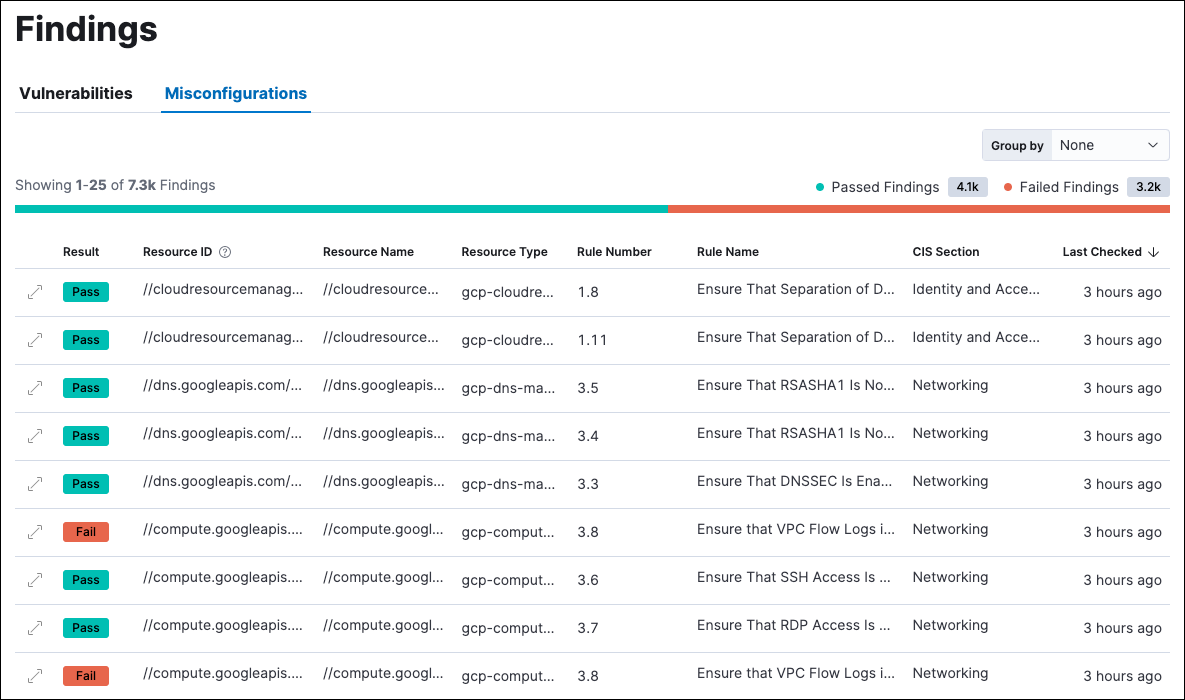

editThe Findings page displays the configuration risks identified by the CSPM and KSPM integrations.
What are CSPM findings?
editCSPM findings indicate whether a given resource passed or failed evaluation against a specific security guideline. Each finding includes metadata about the resource evaluated and the security guideline used to evaluate it. Each finding’s result (pass or fail) indicates whether a particular part of your infrastructure meets a security guideline.
Group and filter findings
editBy default, the Findings page lists all findings, without grouping or filtering.
Group findings by resource
edit- Select Group by → Resource to display a list of resources sorted by their total number of failed findings.
- Click a resource ID to display the findings associated with that resource.
Filter findings
editYou can filter findings data in two ways:
The KQL search bar: For example, search for
result.evaluation : failedto view all failed findings. - In-table value filters: Hover over a finding to display available inline actions. Use the Filter In (plus) and Filter Out (minus) buttons.
