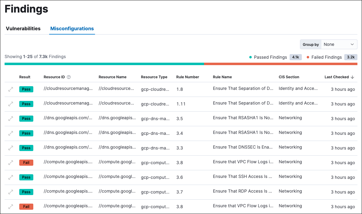

The Findings page displays the configuration risks identified by the CSPM and KSPM integrations.
Findings page
What are KSPM findings?edit
KSPM findings indicate whether a given resource passed or failed evaluation against a specific security guideline. Each finding includes metadata about the resource evaluated and the security guideline used to evaluate it. Each finding’s result (pass or fail) indicates whether a particular part of your infrastructure meets a security guideline.

By default, the Findings page lists all findings, without grouping or filtering.
