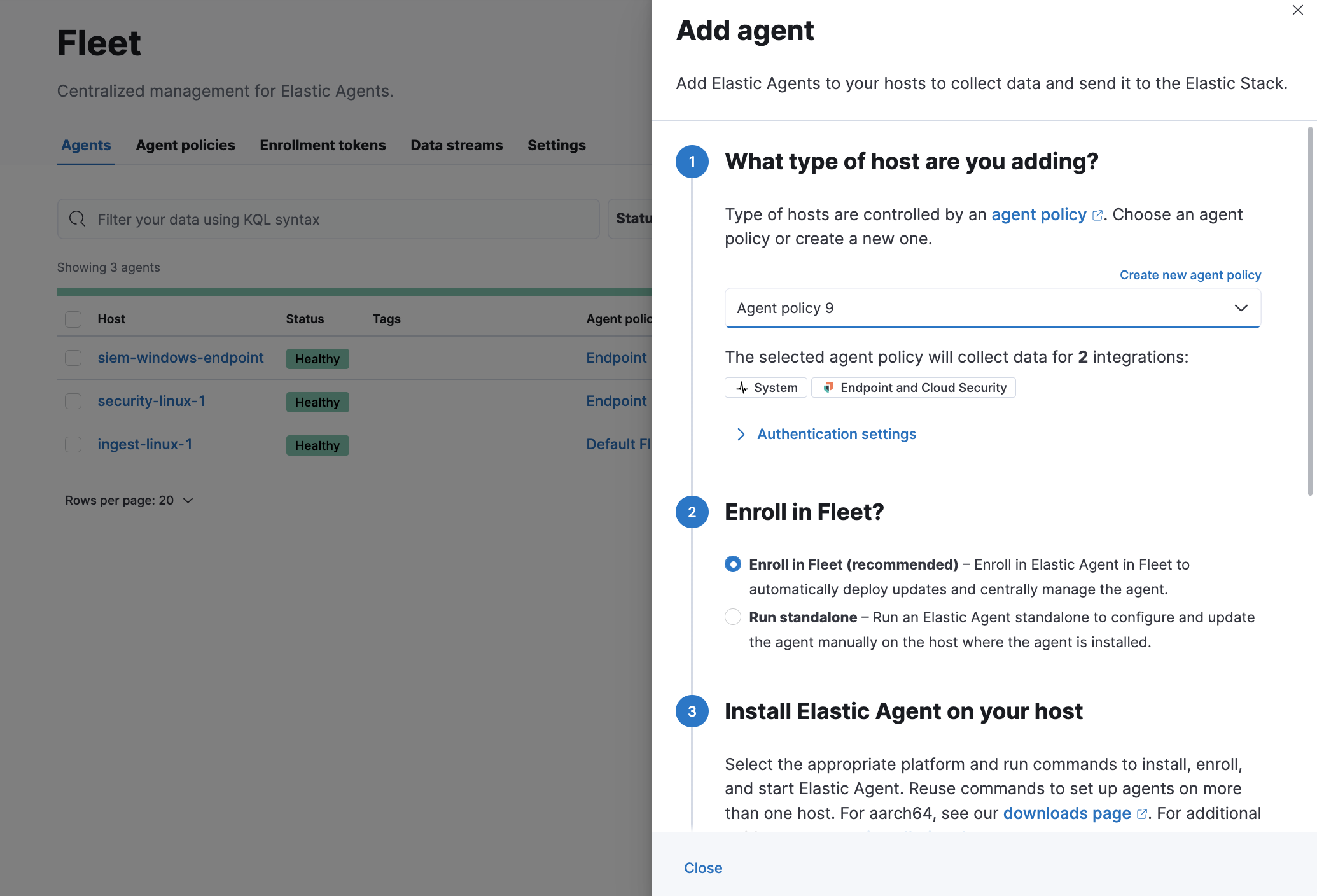

  1. Go to Fleet → Agents → Add agent.
    Add agent flyout on the Fleet page.

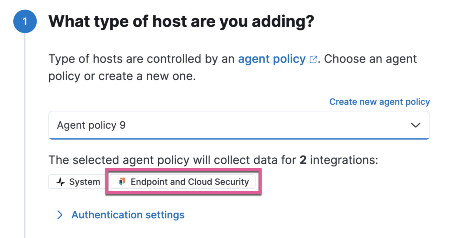

  2. Select an agent policy for the Elastic Agent. You can select an existing policy, or select Create new agent policy to create a new one. For more details on Elastic Agent configuration settings, refer to Elastic Agent policies.
    The selected agent policy should include Endpoint and Cloud Security.
    Add agent flyout with Endpoint and Cloud Security integration highlighted.
  3. Ensure that the Enroll in Fleet option is selected. Endpoint and Cloud Security cannot be integrated with Elastic Agent in standalone mode.
  4. Select the appropriate platform or operating system for the host, then copy the provided commands.
  5. On the host, open a command-line interface and navigate to the directory where you want to install Elastic Agent. Paste and run the commands from Fleet to download, extract, enroll, and start Elastic Agent.
  6. (Optional) Return to the Add agent flyout in Fleet, and observe the Confirm agent enrollment and Confirm incoming data steps automatically checking the host connection. It may take a few minutes for data to arrive in Elasticsearch.
  7. After you have enrolled the Elastic Agent on your host, you can click View enrolled agents to access the list of agents enrolled in Fleet. Otherwise, select Close.
