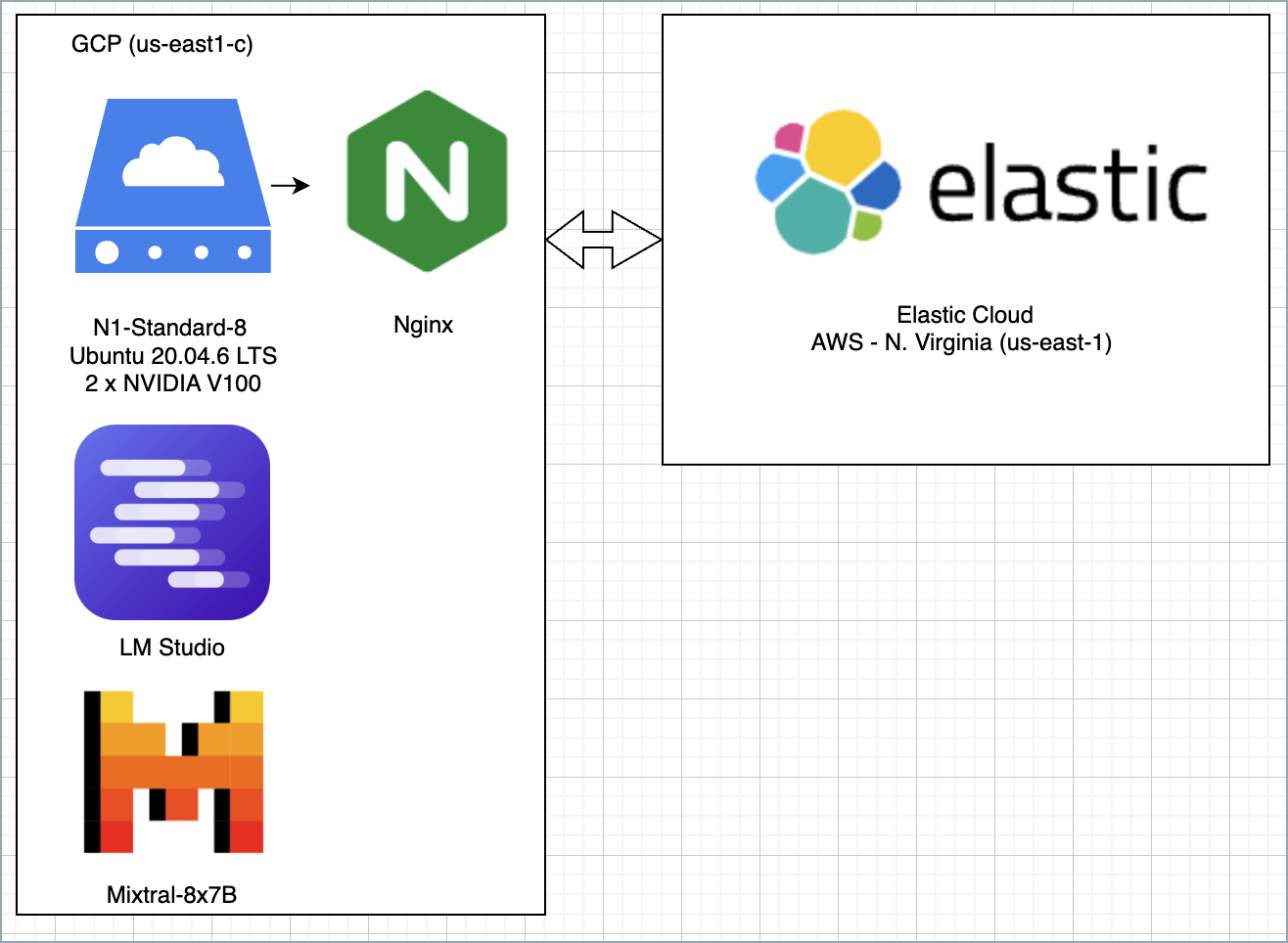

This example uses a single server hosted in GCP to run the following components:
- LM Studio with the Mixtral-8x7b model
- A reverse proxy using Nginx to authenticate to Elastic Cloud
For testing, you can use alternatives to Nginx such as Azure Dev Tunnels or Ngrok, but using Nginx makes it easy to collect additional telemetry and monitor its status by using Elastic’s native Nginx integration. While this example uses cloud infrastructure, it could also be replicated locally without an internet connection.

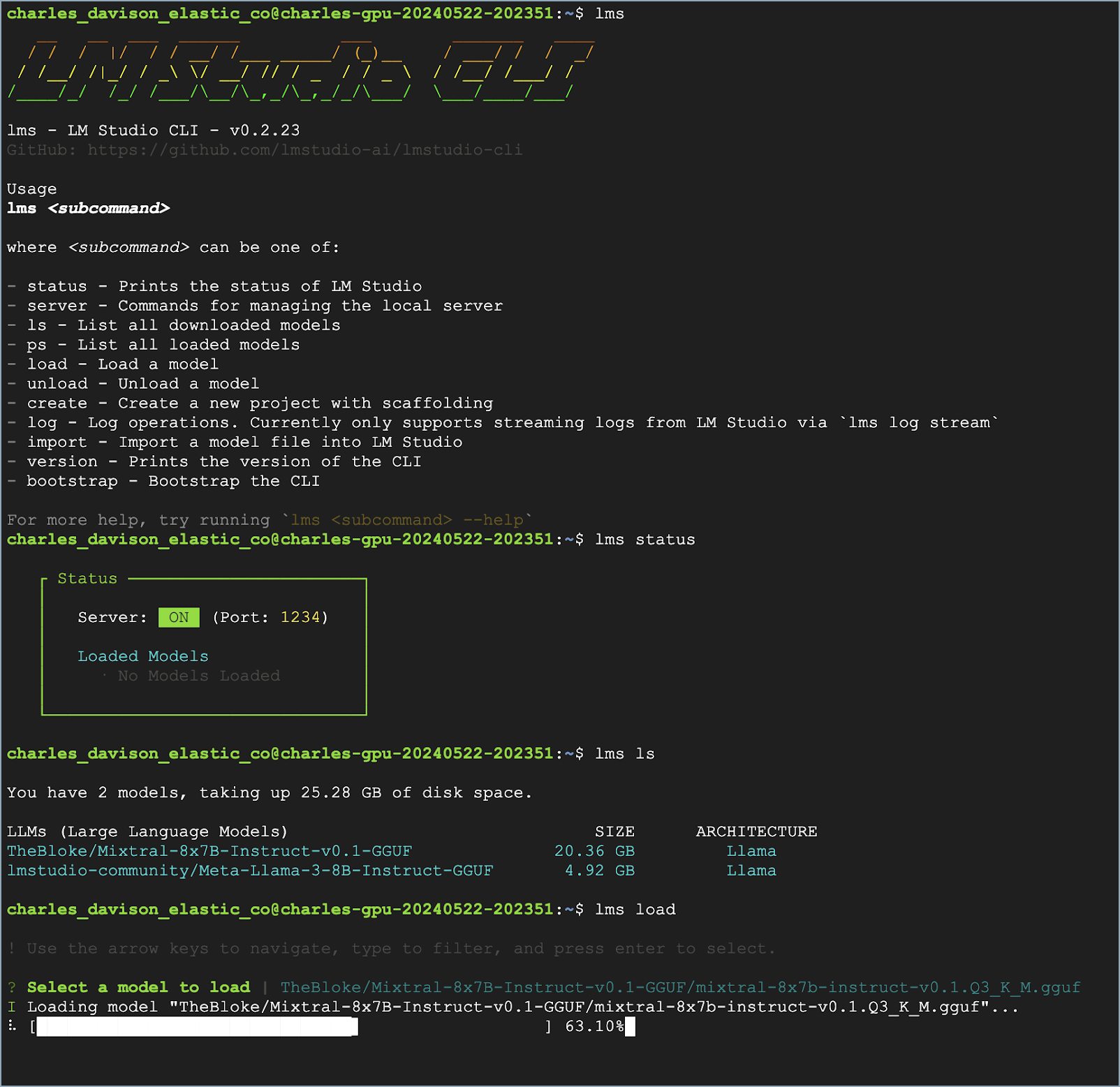

Option 1: load a model using the CLI (Recommended)
editIt is a best practice to download models from the marketplace using the GUI, and then load or unload them using the CLI. The GUI allows you to search for models, whereas the CLI only allows you to import specific paths, but the CLI provides a good interface for loading and unloading.
Use the following commands in your CLI:
Verify LM Studio is installed:
lms -
Check LM Studio’s status:
lms status -
List all downloaded models:
lms ls -

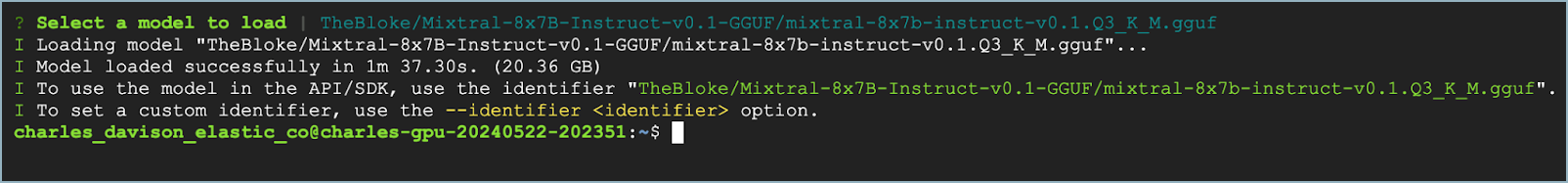

Load a model:
lms load
After the model loads, you should see a Model loaded successfully message in the CLI.

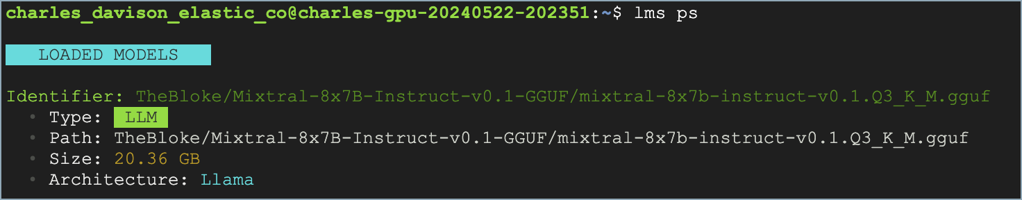

To verify which model is loaded, use the lms ps command.

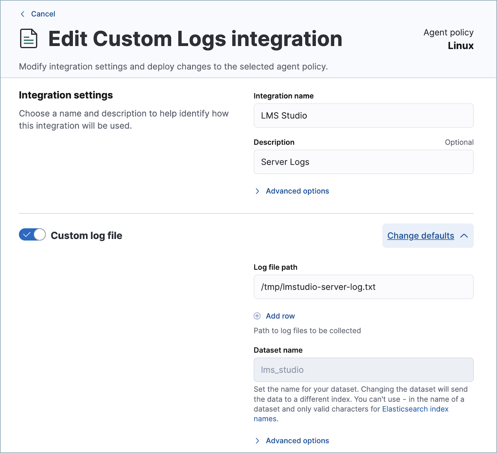

(Optional) Collect logs using Elastic’s Custom Logs integration
editYou can monitor the performance of the host running LM Studio using Elastic’s Custom Logs integration. This can also help with troubleshooting. Note that the default path for LM Studio logs is /tmp/lmstudio-server-log.txt, as in the following screenshot:

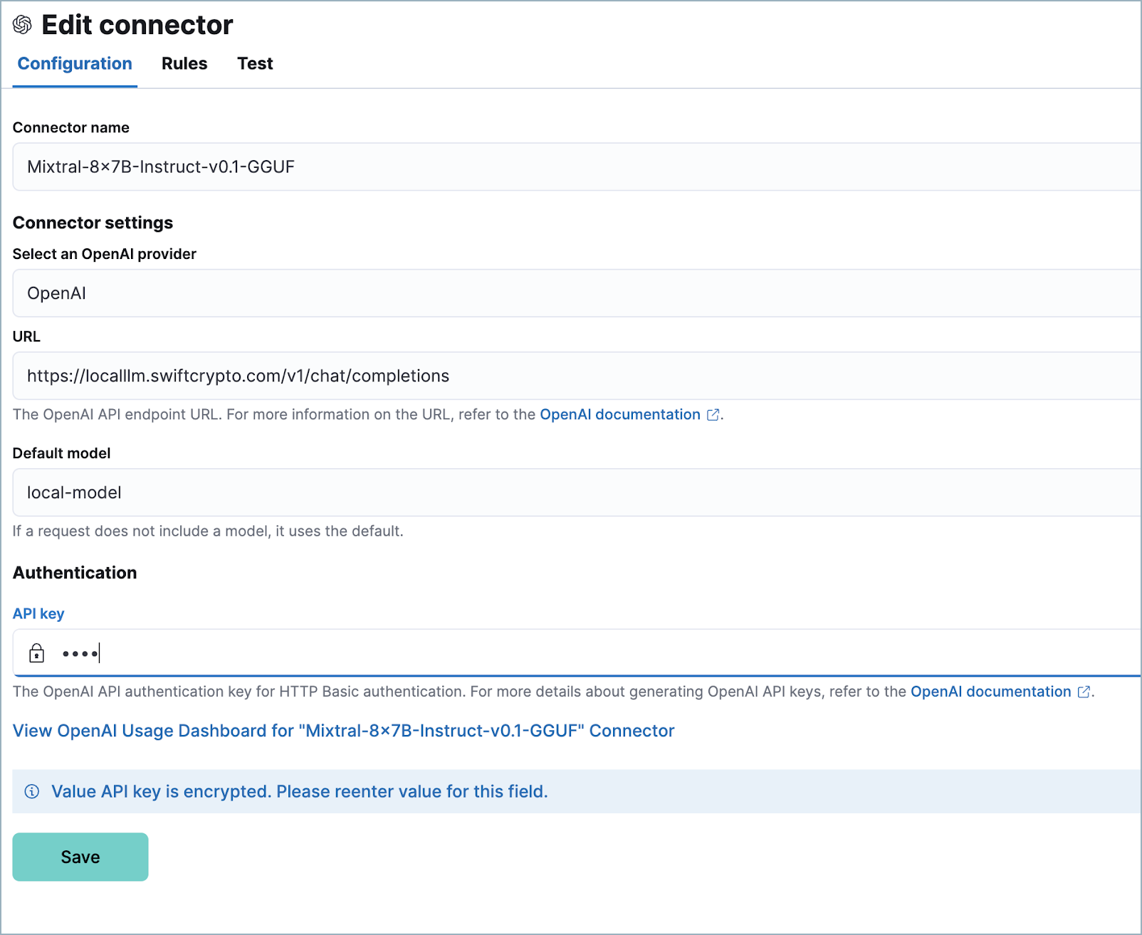

editFinally, configure the connector:
- Log in to your Elastic deployment.
- Navigate to Stack Management → Connectors → Create Connector → OpenAI. The OpenAI connector enables this use case because LM Studio uses the OpenAI SDK.
- Name your connector to help keep track of the model version you are using.
Under URL, enter the domain name specified in your Nginx configuration file, followed by
/v1/chat/completions. -
Under Default model, enter
local-model. - Under API key, enter the secret token specified in your Nginx configuration file.
- Click Save.
Setup is now complete. You can use the model you’ve loaded in LM Studio to power Elastic’s generative AI features. You can test a variety of models as you interact with AI Assistant to see what works best without having to update your connector.
