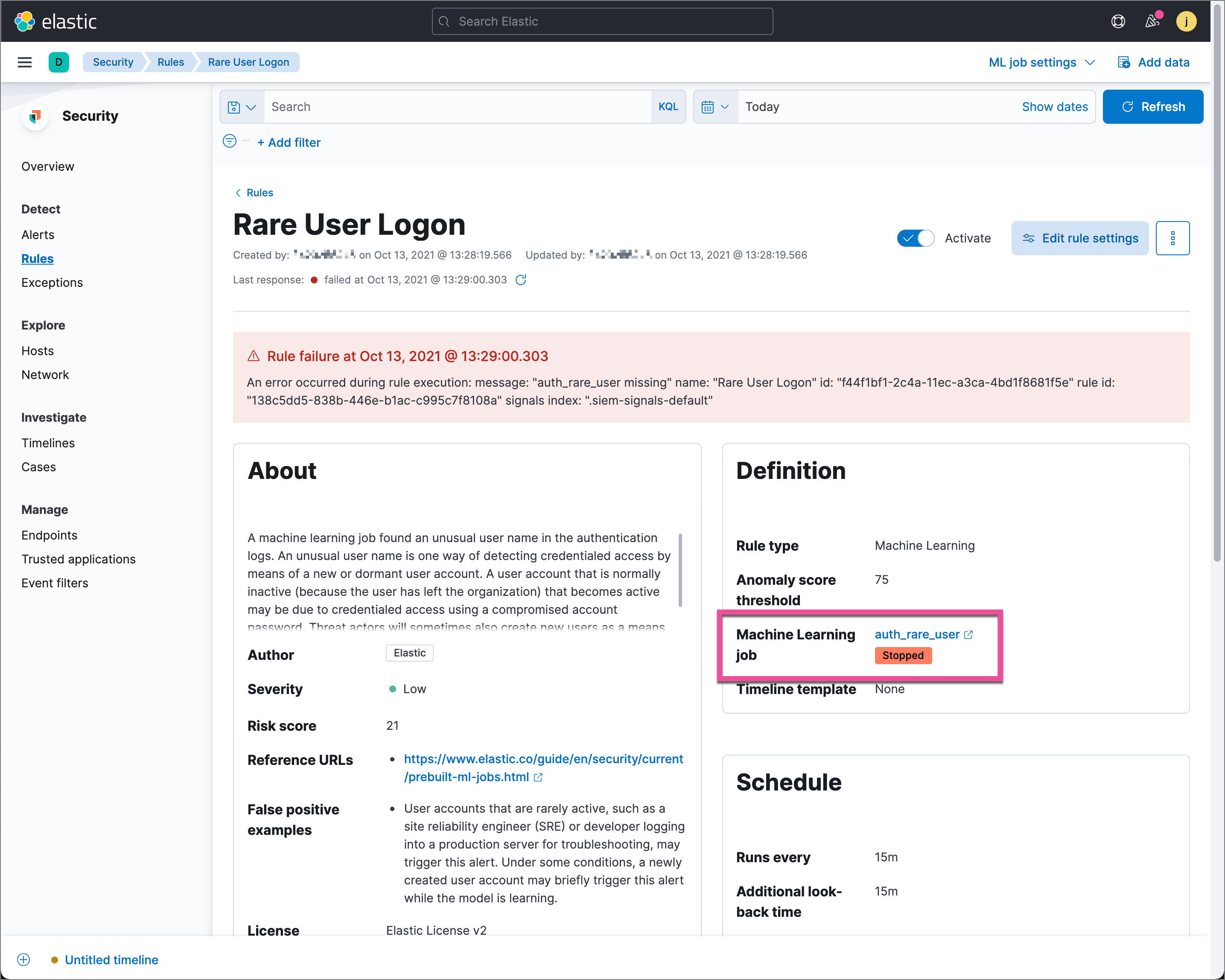

Machine learning rule is failing and a required machine learning job is stopped
If a machine learning rule is failing, check to make sure the required machine learning jobs are running and start any jobs that have stopped.
  1. Go to DetectRules, then select the machine learning rule. The required machine learning jobs and their statuses are listed in the Definition section.
    rules ts ml job stopped

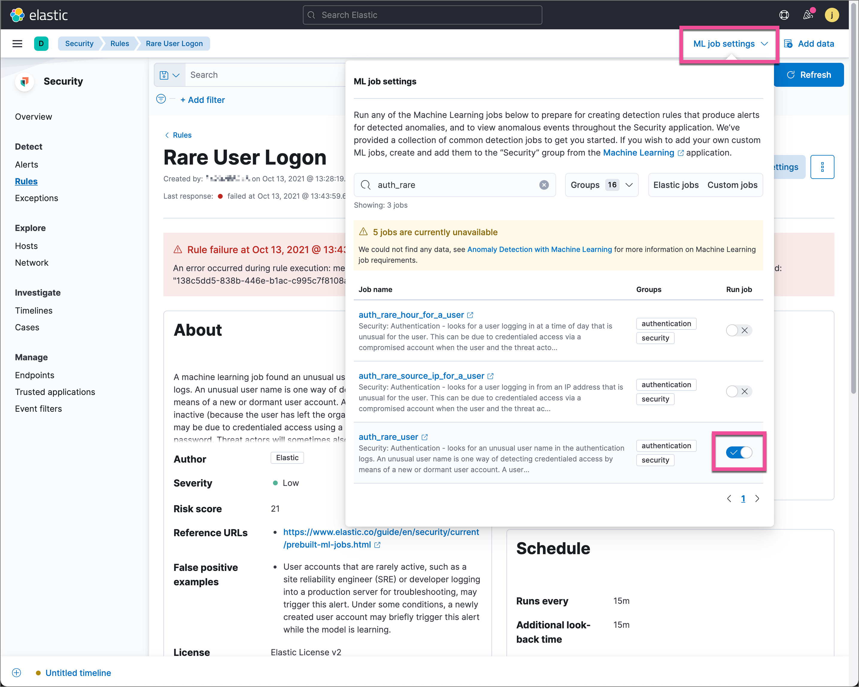

  2. If a required machine learning job isn’t running, select ML job settings in the upper-right corner of the page, then search for the machine learning job.
  3. Turn on the Run job switch for the required machine learning job.
    rules ts start ml job
  4. Rerun the machine learning detection rule.
