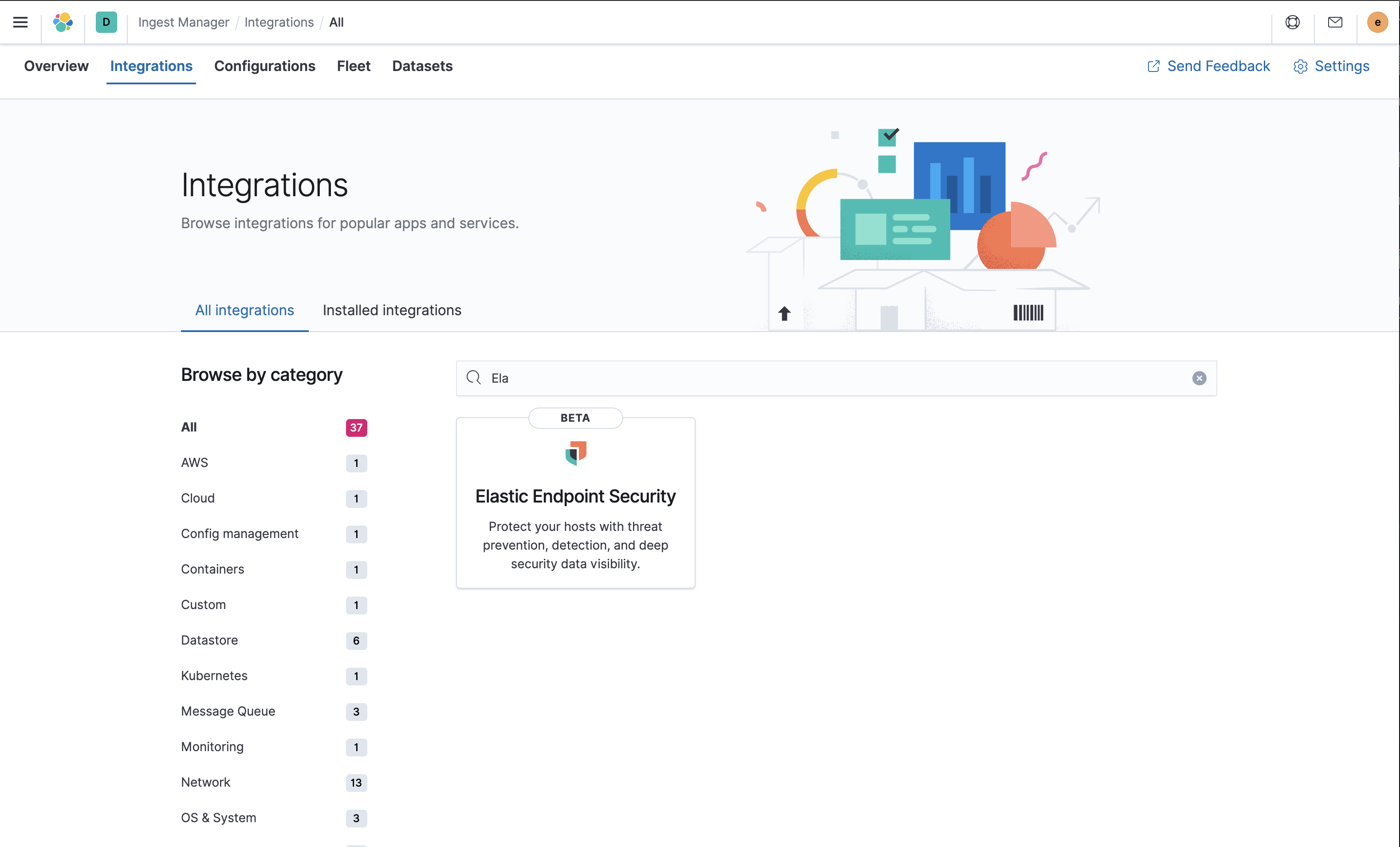

In Kibana, select Security > Administration. If this is not your first time using Elastic Security, select Fleet > Integrations and search for "Elastic Endpoint Security".

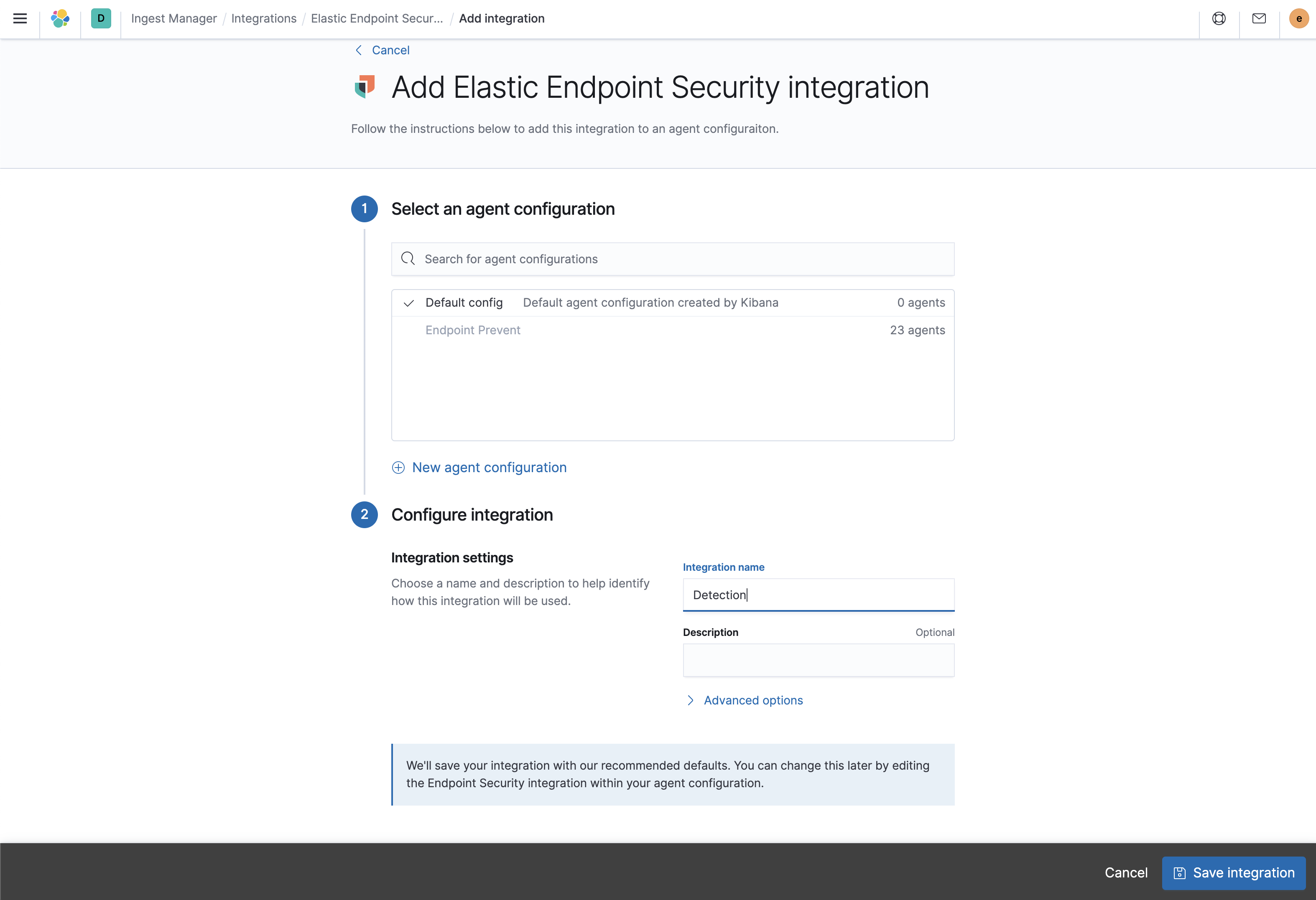

- On the Administration page of the Elastic Security app or the Elastic Endpoint Security integration page in Fleet, select Add Endpoint Security. The integration configuration page appears.
- Select a configuration for the Elastic Agent. You can use either the Default config, or add security integration to a custom or existing configuration. For more details on Elastic Agent configuration settings, see Configuration settings.
Configure the Endpoint Security integration with a name and optional description. When the configuration is complete, select Save integration. Kibana redirects you back to the administration section of the Elastic Security app.

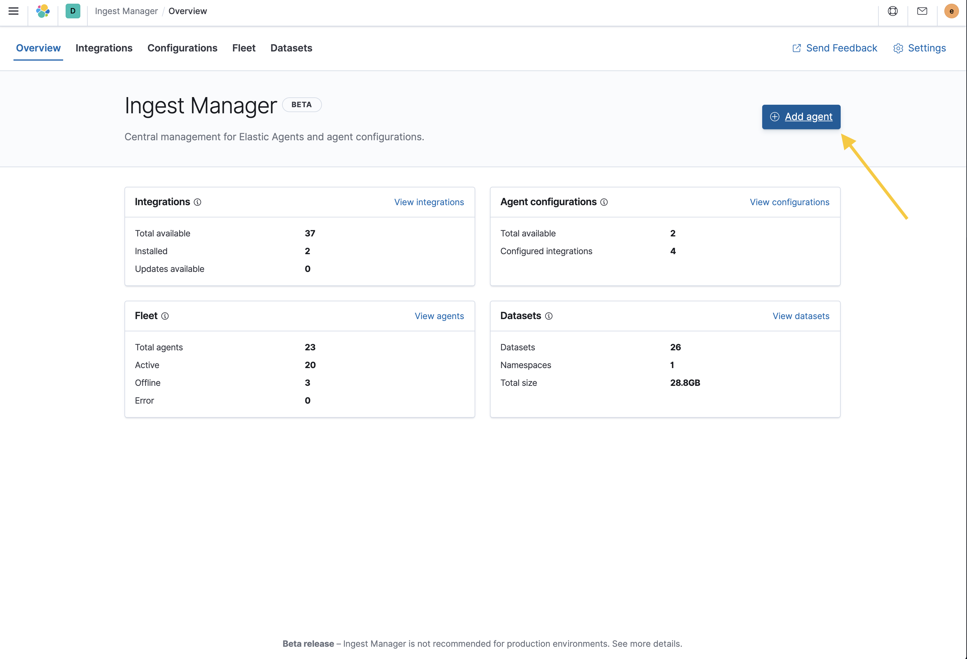

Go to Fleet. Select Overview > Add agent.
- In the Add agent pane of the Configurations section, download the Elastic Agent on your host’s machine.

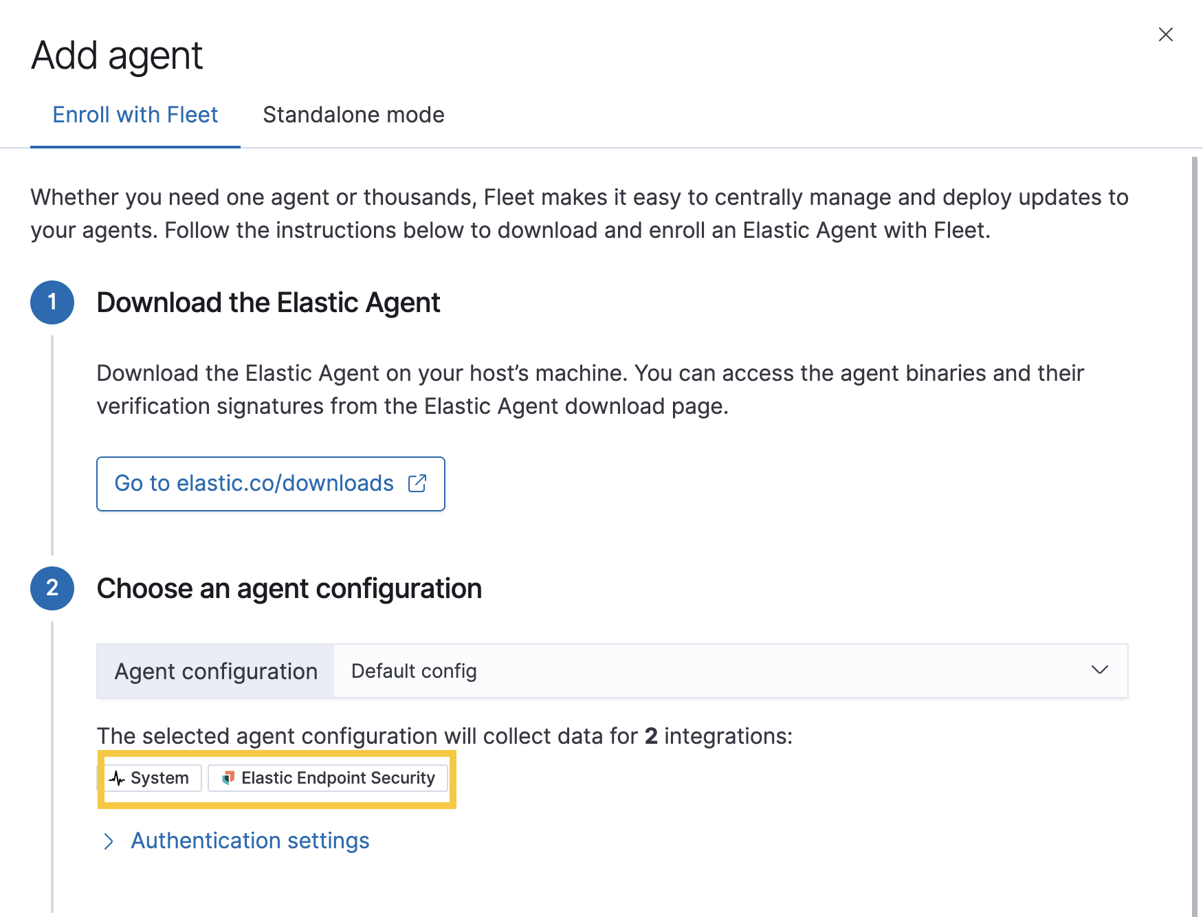

After the download is complete, select an agent configuration. The selected integrations should include Elastic Endpoint Security.

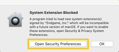

When running the Elastic Agent with endpoint integrated on macOS 10.13, 10.14 and 10.15, you will be prompted to approve a kernel extension from "Endgame, Inc". To approve the extension:
Endgame Sensor users can approve the kernel the same way for the Elastic Endgame app.
Select Open Security Preferences. The Security and Privacy window opens.

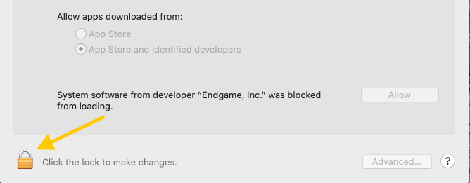

Select the Lock icon at the bottom left of the window to make changes to your security settings.

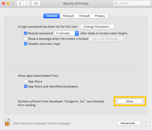

Allow "Endgame, Inc" by selecting the Allow button.
