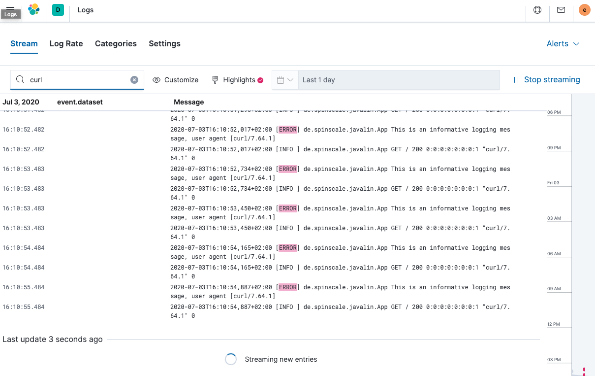

Now let’s have a look at the Logs app in Kibana. Select Observability → Logs.
If you want to see the streaming feature at work, run the following curl request in a loop while sleeping.
while $(sleep 0.7) ; do curl localhost:7000 ; done
To view a continuous stream of log messages, click Stream live. You can also highlight specific terms, as shown here.

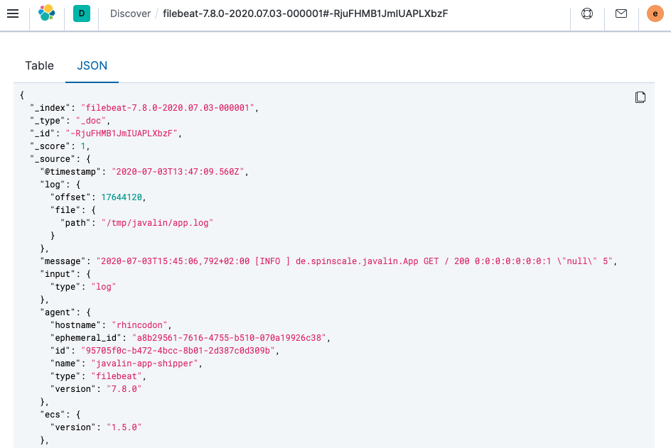

Looking at one of the documents being indexed, you can see that the log message is contained in a single field. Verify this by looking at one of those documents.
GET filebeat-*/_search { "size": 1 }
Things to note:
When you compare the
@timestamp
field with the timestamp of the log message, you will notice that it differs. This means that you don’t get the results you expect when filtering based on the@timestamp
field. The current@timestamp
field reflects the timestamp when the event was created within Filebeat, not the timestamp of when the log event occurred in the application. - One cannot filter on specific fields like the HTTP verb, the HTTP status code, the log level or the class that generated the log message

Let’s take another look at a log message generated by our app.
2020-07-03T15:45:01,479+02:00 [INFO ] de.spinscale.javalin.App This is an informative logging message
This message has four parts: timestamp
, log level
, class
, and message
. The

Restart Filebeat after the change, and look at what changed in an indexed JSON document by running this search (and having another log message indexed).
GET filebeat-*/_search?filter_path=**._source { "size": 1, "_source": { "excludes": [ "host.ip", "host.mac" ] }, "sort": [ { "@timestamp": { "order": "desc" } } ] }
This returns a document like this.
{ "hits" : { "hits" : [ { "_source" : { "input" : { "type" : "log" }, "agent" : { "hostname" : "rhincodon", "name" : "javalin-app-shipper", "id" : "95705f0c-b472-4bcc-8b01-2d387c0d309b", "type" : "filebeat", "ephemeral_id" : "e4df883f-6073-4a90-a4c4-9e116704f871", "version" : "7.9.0" }, "@timestamp" : "2020-07-03T15:11:51.925Z", "ecs" : { "version" : "1.5.0" }, "log" : { "file" : { "path" : "/tmp/javalin/app.log" }, "offset" : 1440, "level" : "ERROR", "logger" : "de.spinscale.javalin.App" }, "host" : { "hostname" : "rhincodon", "os" : { "build" : "19F101", "kernel" : "19.5.0", "name" : "Mac OS X", "family" : "darwin", "version" : "10.15.5", "platform" : "darwin" }, "name" : "javalin-app-shipper", "id" : "C28736BF-0EB3-5A04-BE85-C27A62C99316", "architecture" : "x86_64" }, "message" : "This is an informative logging message, user agent [curl/7.64.1]" } } ] } }
You can see that the message
field only contains the last part of our log
message. Also, there is a log.level
and log.logger
field.

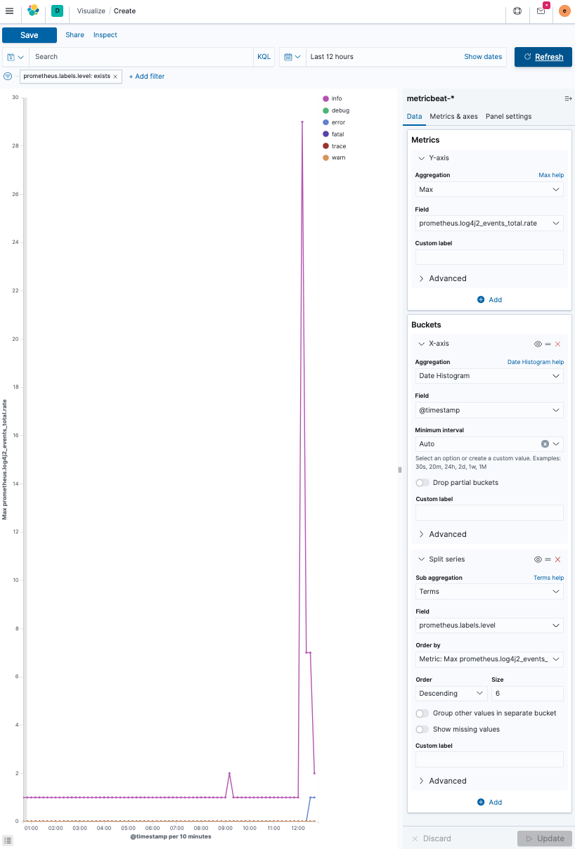

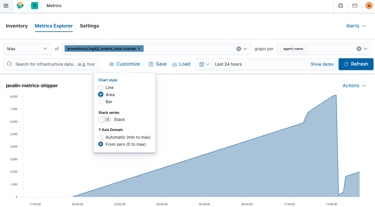

Step 6: View metrics in Kibanaedit
As this is custom data from our Javalin app, there is no pre-defined dashboard for displaying this data.
Let’s check for the number of logging messages per log level.
GET metricbeat-*/_search { "query": { "exists": { "field": "prometheus.log4j2_events_total.counter" } } }
Visualize the number of log messages over time, split by the
log level. Since the Elastic Stack 7.7, there is a new way of creating a
visualization called Lens
- Log into Kibana and select Visualize → Create Visualization.
Create a line chart and select
metricbeat-*
as the source.The basic idea is to have a max aggregation on the y-axis on the
prometheus.log4j2_events_total.rate
field, whereas the x-axis, is split by date using a date_histogram aggregation on the@timestamp
field.There is one more split within each date histogram bucket, split by log level, using a terms aggregation on the
prometheus.labels.level
, which contains the log level. Also, increase the size of the log level to six to display every log level.The final result looks like this.

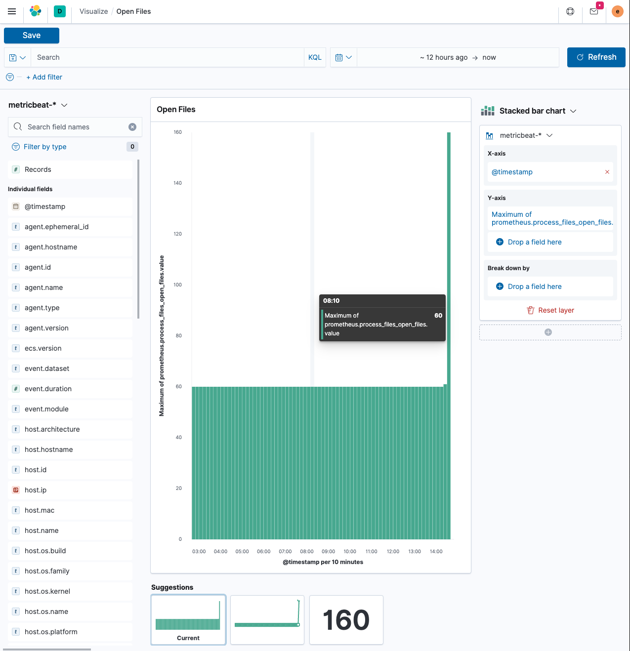

The second visualization is to be a check for the number of open files in our application.
As no one can remember all the field names, let’s again look at the metrics output again first.
curl -s localhost:7000/metrics -u metrics:secret | grep ^process process_files_max_files 10240.0 process_cpu_usage 1.8120711232436825E-4 process_uptime_seconds 72903.726 process_start_time_seconds 1.594048883317E9 process_files_open_files 61.0
Let’s look at the process_files_open_files
metric. This should be a rather static value that rarely changes.
If you run an application which stores data within the JVM or opens and closes network
sockets, this metric increases and decreases depending on the load. With a web application,
this is rather static. Let’s figure out why there are 60 files open on our
small web application.

Add an endpoint to increase the number of open files by having long-running HTTP connections (each connection is also considered an open file as it requires a file descriptor), and then run
wrk
against it.... import java.util.concurrent.CompletableFuture; import java.util.concurrent.Executor; import java.util.concurrent.TimeUnit; ... public static void main(String[] args) { ... final Executor executor = CompletableFuture.delayedExecutor(20, TimeUnit.SECONDS); app.get("/wait", ctx -> { CompletableFuture<String> future = CompletableFuture.supplyAsync(() -> "done", executor); ctx.result(future); }); ...
Every future gets delayed by 20 seconds, which means that a single HTTP request stays open for 20 seconds.
Let’s run a
wrk
workload.wrk -c 100 -t 20 -d 5m http://localhost:7000/wait
Results show that only twenty requests were sent, which makes sense given the processing time.
Now let’s build a visualization using Lens in Kibana.
Below
Add filter
, select themetricbeat-*
index pattern. This will likely usefilebeat-*
as the default.The x-axis uses the
@timestamp
field - which in turn will create adate_histogram
aggregation again. The y-axis should not be the document count, as that one will always be stable, but the maximum value of the documents in the buckets. Click on the right of the field name on the y-axis and selectMax
. This gives you a similar visualization than shown, with a peak where you ran thewrk
command above. -
Now let’s have a look at the Metrics app in Kibana. Select Observability → Metrics.
You will only see data from a single shipper. Still, the moment you are running several services and the ability to group this per Kubernetes pod or host enables you to spot hosts with elevated CPU or memory consumption.
Click Metrics Explorer, you can start exploring your data for specific hosts or the CPU usage across your nodes.
This is an area chart of the total events counter the Javalin app emits. It’s rising because there is a component polling an endpoint that, in turn, produces another log message. The steeper peek was due to sending more requests. But where is the sudden drop-off coming from? A JVM restart. As those metrics are not persisted, they reset on a JVM restart. With that in mind, it’s often better to log the
rate
instead of thecounter
field.

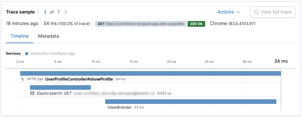

Despite a heavily fragmented APM landscape, the terminology often is similar. The two most important terms are Spans and Transactions.
A transaction encapsulates a series of spans, which contain information about the execution of a piece of code. Let’s take a look at this screenshot from the Kibana APM app.
This is a Spring Boot application. The
UserProfileController.showProfile()
method is called, which is marked as the
transaction. There are two spans within. First, a request is sent to
Elasticsearch using the Elasticsearch REST client, and after the
response is rendered using Thymeleaf. The request to Elasticsearch is faster than the
rendering in this case.

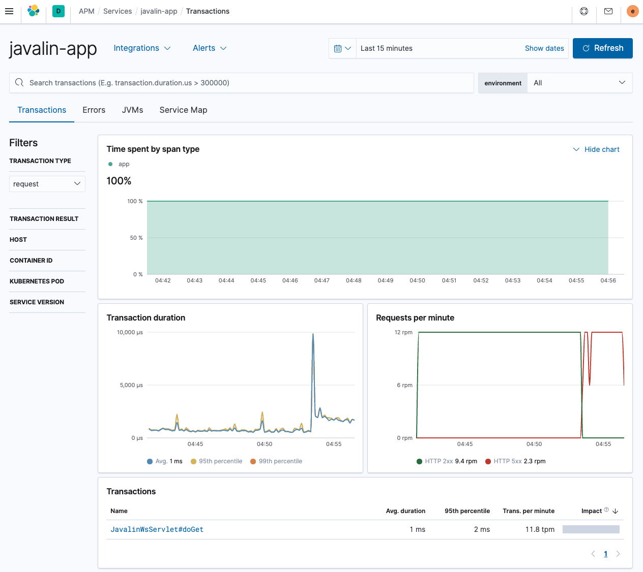

files.Wait a few minutes and let’s finally take a look at the APM app.
As you can see, this is quite the difference to the Spring Boot application shown earlier. The different endpoints are not listed; we can see the requests per minute though including errors.
The only transaction comes from a single servlet, which is not too helpful. Let’s try to fix this by introducing custom programmatic transactions.

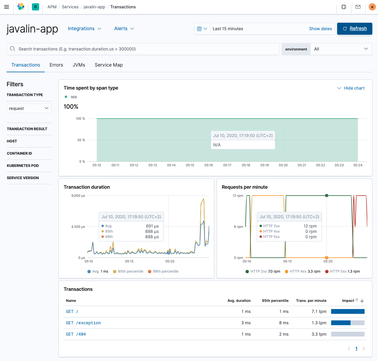

Restart your app and see data flowing in. Test a few different endpoints, especially the one that throws exceptions and the one that triggers a 404.
This looks much better, having differences between endpoints.

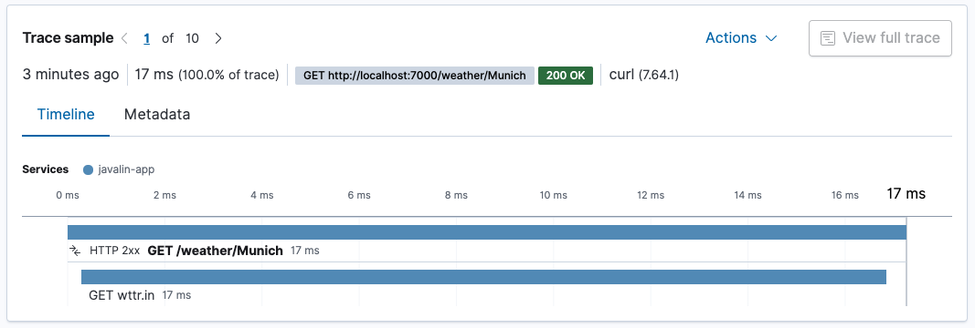

Add another endpoint to see the power of transactions, which polls another HTTP service. You may have heard of wttr.in, a service to poll weather information from. Let’s implement a proxy HTTP method that forwards the request to that endpoint. Let’s use Apache HTTP client, one of the most typical HTTP clients out there.
implementation 'org.apache.httpcomponents:fluent-hc:4.5.12'
This is our new endpoint.
import org.apache.http.client.fluent.Request; ... public static void main(String[] args) { ... app.get("/weather/:city", ctx -> { String city = ctx.pathParam("city"); ctx.result(Request.Get("https://wttr.in/" + city + "?format=3").execute() .returnContent().asBytes()) .contentType("text/plain; charset=utf-8"); }); ...
Curl
http://localhost:7000/weather/Munich

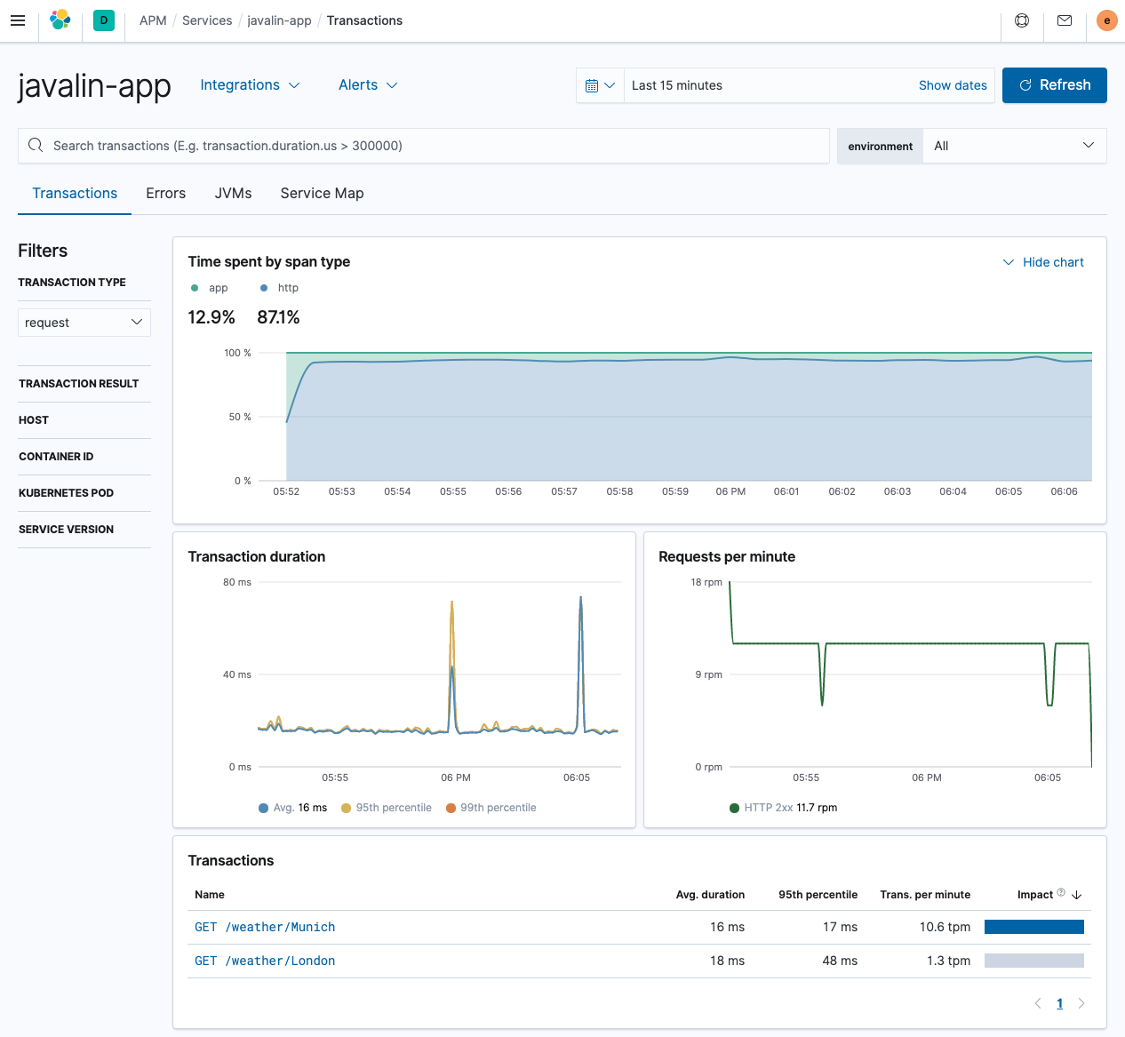

and see a one-line response about the current weather. Let’s check the APM UI.In the overview, you can see that most time is spent in the HTTP client, which is not surprising.
Our transactions for the
/weather/Munich
now contain a span, showing how much time is spent on retrieving the weather data. Because the HTTP client is instrumented automatically, there is no need to do anything.If the
city
parameter if that URL is of high cardinality, this will result in a high amount of URLs mentioned instead of the generic endpoint. If you would like to prevent this, a possibility would be to usectx.matchedPath()
to log every call to the weather API asGET /weather/:city

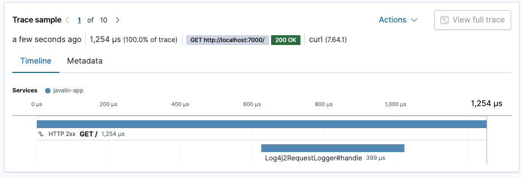

Method tracing via agent configurationedit
Instead of writing code to trace methods, you can also configure the agent to do this. Let’s try to figure out if logging is a bottleneck for our application and trace the request logger statements we added earlier.
The agent can trace methods based on their signature.
The interface to monitor would be the io.javalin.http.RequestLogger
interface with the handle
method. So let’s try
io.javalin.http.RequestLogger#handle
to identify the method to log
and put this in your .env
ELASTIC_APM_TRACE_METHODS="de.spinscale.javalin.Log4j2RequestLogger#handle"
Create a dedicated logger class as well to match the above trace method.
package de.spinscale.javalin; import io.javalin.http.Context; import io.javalin.http.RequestLogger; import org.jetbrains.annotations.NotNull; import org.slf4j.Logger; import org.slf4j.LoggerFactory; public class Log4j2RequestLogger implements RequestLogger { private final Logger logger = LoggerFactory.getLogger(Log4j2RequestLogger.class); @Override public void handle(@NotNull Context ctx, @NotNull Float executionTimeMs) throws Exception { String userAgent = ctx.userAgent() != null ? ctx.userAgent() : "-"; logger.info("{} {} {} {} \"{}\" {}", ctx.method(), ctx.req.getPathInfo(), ctx.res.getStatus(), ctx.req.getRemoteHost(), userAgent, executionTimeMs.longValue()); } }
Fix the call in our
App
class.config.requestLogger(new Log4j2RequestLogger());
Restart your app, and see how much time your logging takes.
The request logger takes roughly 400 microseconds. The whole request takes about 1.3 milliseconds. Approximately a third of the processing of our request goes into logging.
If you are on the quest for a faster service, you may want to rethink logging. However, this logging happens after the result is written to the client, so while the total processing time increases with logging, responding to the client does not (closing the connection however might be). Also note that these tests were conducted without a proper warm-up. I assume that after appropriate JVM warm-up, you will have much faster processing of requests.

You can now check the generated log files that are sent to Elasticsearch via Filebeat. An entry looks like this.
{ "@timestamp": "2020-07-13T12:03:22.491Z", "log.level": "INFO", "message": "GET / 200 0:0:0:0:0:0:0:1 \"curl/7.64.1\" 0", "service.name": "my-javalin-app", "event.dataset": "my-javalin-app.log", "process.thread.name": "qtp34871826-36", "log.logger": "de.spinscale.javalin.Log4j2RequestLogger", "trace.id": "ed735860ec0cd3ee3bdf80ed7ea47afb", "transaction.id": "8af7dff698937dc5" }
Having the trace.id
and transaction.id
added, in the case of an error
you will get an error.id
field.

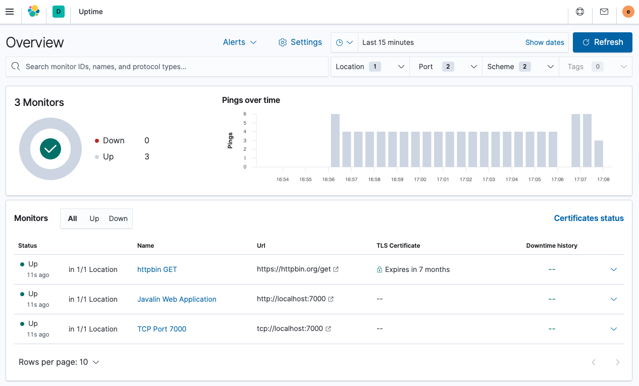

To view the Uptime app, select Observability → Uptime. The overview looks like this.
You can see the list of monitors and a global overview. Let’s see the details for one of those alerts. Click Javalin Web Application.
You can see the execution for the last scheduled checks, but the duration for each check might be more interesting. You can see if the latency for one of your checks is going up.
The interesting part is the world map at the top. You can specify in the configuration where the check originated, which in this case was in Munich in Europe. By configuring several Heartbeats running across the world, you can compare latencies and figure out which data center you need to run your application to be next to your users.
The duration of the monitor is in the low milliseconds, as it is really
fast. Check the monitor for the httpbin.org
endpoint, and you will see a
much higher duration. In this case, it is about 400ms for each request. This
is not too surprising because the endpoint is not nearby, and you need to
initiate a TLS connection for every request, which is costly.
