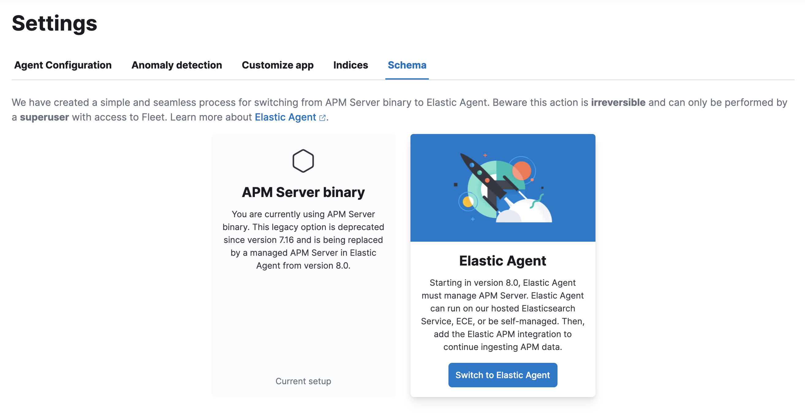

  1. In the main menu, go to Applications -> Service Inventory or find Service Inventory using the global search field, and then select Settings → Schema.
    switch to Elastic Agent

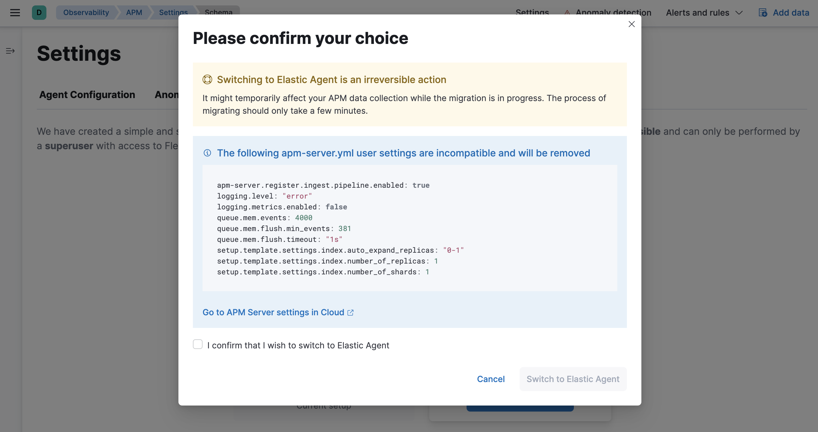

  2. Click Switch to Elastic Agent. Make a note of the apm-server.yml user settings that are incompatible with Elastic Agent. Check the confirmation box and click Switch to Elastic Agent.
    Elastic Agent settings migration
Elastic Cloud will now create a Fleet Server instance to contain the new APM integration, and then will shut down the old APM server instance. Within minutes your data should begin appearing in the Applications UI again.
