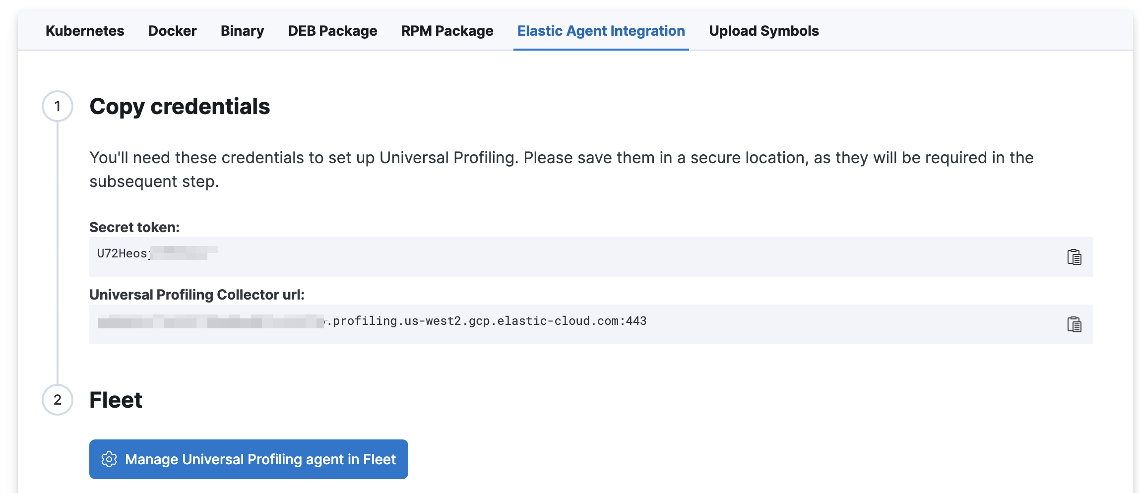

  1. Copy the secret token and Universal Profiling Collector url from the Elastic Agent Integration
    profiling elastic agent
  2. Click Manage Universal Profiling Agent in Fleet to complete the integration.

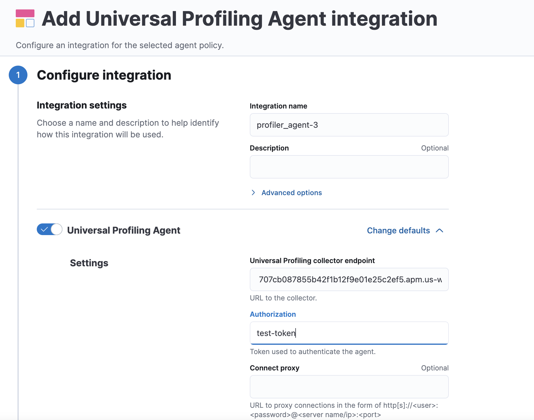

  3. On the Integrations page, click Add Universal Profiling Agent.
  4. In Universal Profiling Agent → Settings, add the information you copied from the Add profiling data page:
    1. Add the Universal Profiling collector URL to the Universal Profiling collector endpoint field.
    2. Add the secret token to the Authorization field.
      profililing elastic agent creds
  5. Click Save and continue.

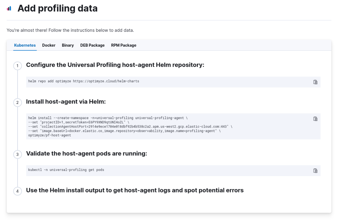

After clicking Set up Universal Profiling in the previous step, you’ll see the instructions for installing the Universal Profiling Agent. You can also find these instructions by clicking the Add data button in the top-right corner of the page.
The following is an example of the provided instructions for Kubernetes:
profiling k8s hostagent
