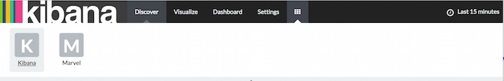

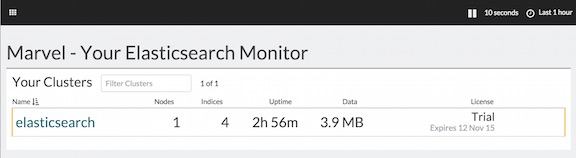

To verify your Marvel installation, point your web browser at
http://0.0.0.0:5601/to open Kibana, click the App Switcher icon in the Kibana menu bar, and select Marvel.Marvel should display a list of the clusters you are monitoring.
Now you’re ready to use Marvel to monitor and analyze your Elasticsearch nodes!
