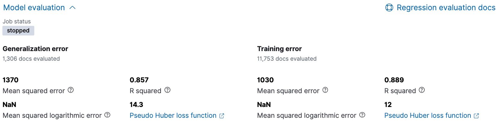

To evaluate the analysis with this API, you need to annotate your index that contains the results of the analysis with a field that marks each document with the ground truth. The evaluate data frame analytics API evaluates the performance of the data frame analytics against this manually provided ground truth.
You can measure how well the model has performed on your training data by using the regression evaluation type of the evaluate data frame analytics API. The mean squared error (MSE) value that the evaluation provides you on the training data set is the training error. Training and evaluating the model iteratively means finding the combination of model parameters that produces the lowest possible training error.
Another crucial measurement is how well your model performs on unseen data. To assess how well the trained model will perform on data it has never seen before, you must set aside a proportion of the training set for testing (testing data). Once the model is trained, you can let it predict the value of the data points it has never seen before and compare the prediction to the actual value. This test provides an estimate of a quantity known as the model generalization error.
The regression evaluation type offers the following metrics to evaluate the model performance:
- Mean squared error (MSE)
- Mean squared logarithmic error (MSLE)
- Pseudo-Huber loss
- R-squared (R2)
MSE is the average squared sum of the difference between the true value and the predicted value. (Avg (predicted value-actual value)2).
MSLE is a variation of mean squared error. It can be used for cases when the target values are positive and distributed with a long tail such as data on prices or population. Consult the Loss functions for regression analyses page to learn more about loss functions.
Pseudo-Huber loss metric behaves as mean absolute error (MAE) for errors larger than a predefined value (defaults to 1) and as mean squared error (MSE) for errors smaller than the predefined value. This loss function uses the delta parameter to define the transition point between MAE and MSE. Consult the Loss functions for regression analyses page to learn more about loss functions.
R-squared (R2) represents the goodness of fit and measures how much of the variation in the data the predictions are able to explain. The value of R2 are less than or equal to 1, where 1 indicates that the predictions and true values are equal. A value of 0 is obtained when all the predictions are set to the mean of the true values. A value of 0.5 for R2 would indicate that the predictions are 1 - 0.5 (1/2) (about 30%) closer to true values than their mean.

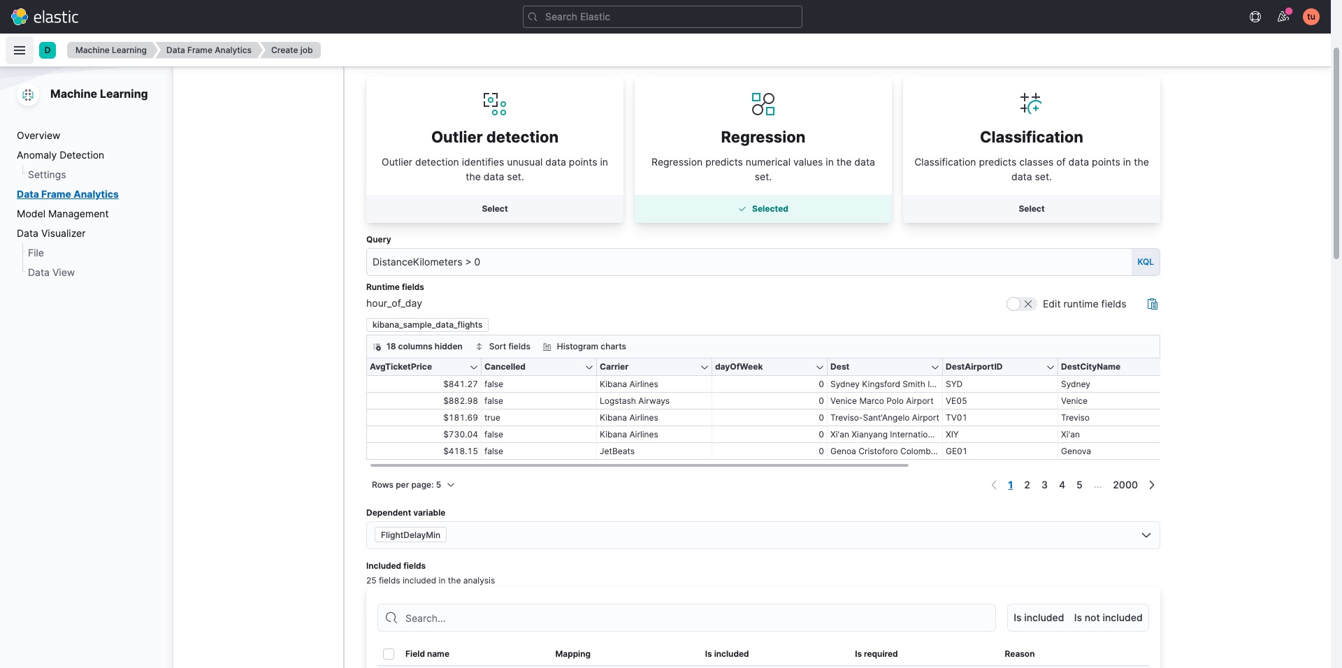

Create a data frame analytics job. You can use the wizard on the Machine Learning > Data Frame Analytics tab in Kibana or the create data frame analytics jobs API.
Choose
kibana_sample_data_flightsas the source index.Choose
regressionas the job type.Optionally improve the quality of the analysis by adding a query that removes erroneous data. In this case, we omit flights with a distance of 0 kilometers or less.
Choose
FlightDelayMinas the dependent variable, which is the field that we want to predict.Add
Cancelled,FlightDelay, andFlightDelayTypeto the list of excluded fields. These fields will be excluded from the analysis. It is recommended to exclude fields that either contain erroneous data or describe thedependent_variable.The wizard includes a scatterplot matrix, which enables you to explore the relationships between the numeric fields. The color of each point is affected by the value of the dependent variable for that document, as shown in the legend. You can highlight an area in one of the charts and the corresponding area is also highlighted in the rest of the chart. You can use this matrix to help you decide which fields to include or exclude from the analysis.

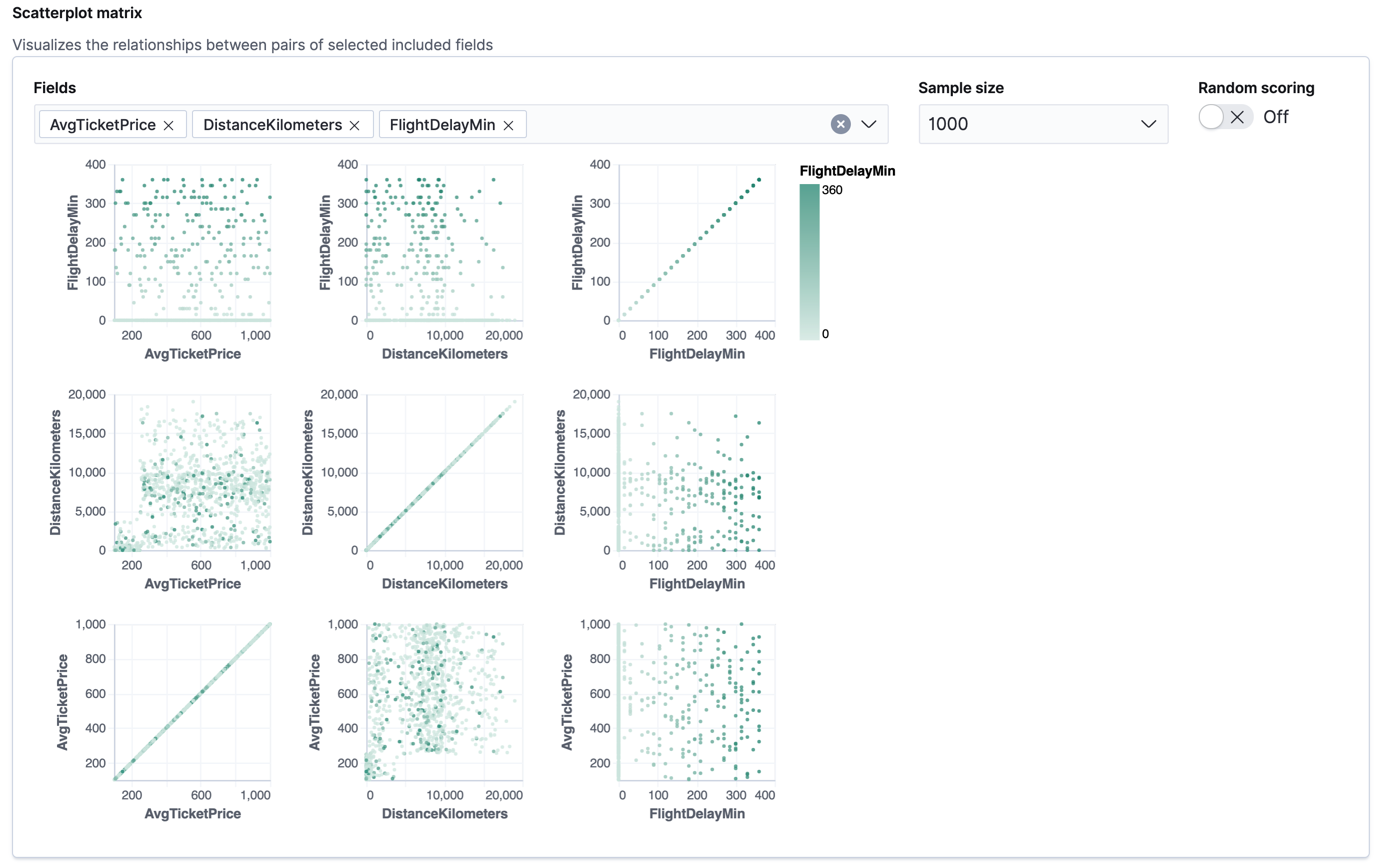

If you want these charts to represent data from a larger sample size or from a randomized selection of documents, you can change the default behavior. However, a larger sample size might slow down the performance of the matrix and a randomized selection might put more load on the cluster due to the more intensive query.

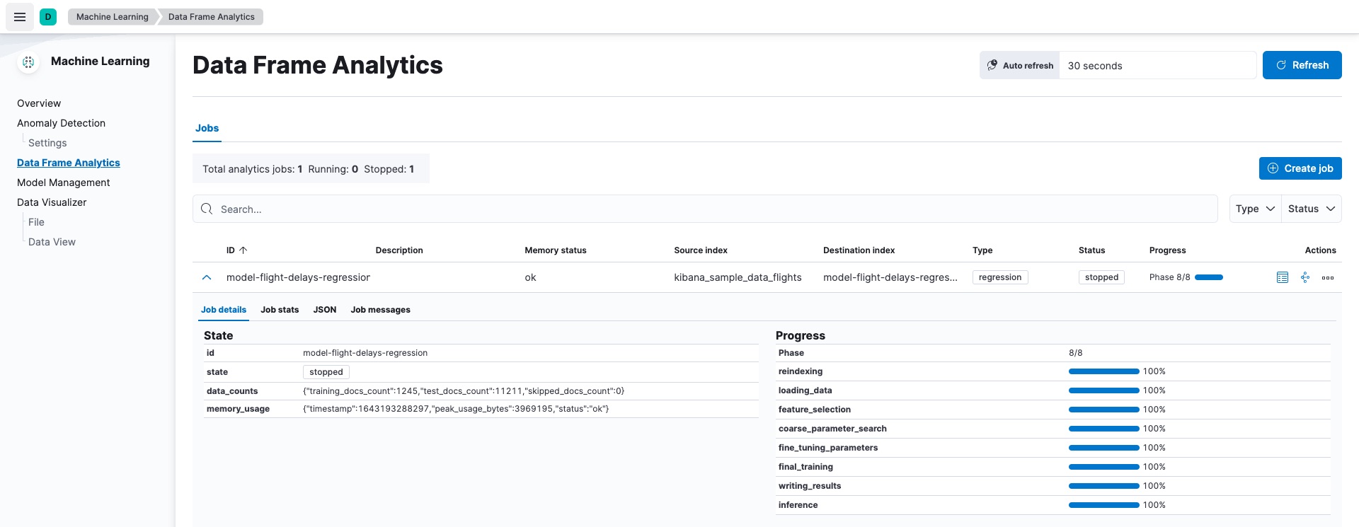

Start the job in Kibana or use the start data frame analytics jobs API.
The job takes a few minutes to run. Runtime depends on the local hardware and also on the number of documents and fields that are analyzed. The more fields and documents, the longer the job runs. It stops automatically when the analysis is complete.
API examplePOST _ml/data_frame/analytics/model-flight-delays-regression/_startCheck the job stats to follow the progress in Kibana or use the get data frame analytics jobs statistics API.
When the job stops, the results are ready to view and evaluate. To learn more about the job phases, see How data frame analytics jobs work.
API example
GET _ml/data_frame/analytics/model-flight-delays-regression/_stats
The API call returns the following response:
"count" : 1,
"data_frame_analytics" : [
"id" : "model-flight-delays-regression",
"state" : "stopped",
"progress" : [
"phase" : "reindexing",
"progress_percent" : 100
"phase" : "loading_data",
"phase" : "feature_selection",
"phase" : "coarse_parameter_search",
"phase" : "fine_tuning_parameters",
"phase" : "final_training",
"phase" : "writing_results",
"phase" : "inference",
"data_counts" : {
"training_docs_count" : 11210,
"test_docs_count" : 1246,
"skipped_docs_count" : 0
"memory_usage" : {
"timestamp" : 1599773614155,
"peak_usage_bytes" : 50156565,
"status" : "ok"
"analysis_stats" : {
"regression_stats" : {
"iteration" : 18,
"hyperparameters" : {
"alpha" : 19042.721566629778,
"downsample_factor" : 0.911884068909842,
"eta" : 0.02331774683318904,
"eta_growth_rate_per_tree" : 1.0143154178910303,
"feature_bag_fraction" : 0.5504020748926737,
"gamma" : 53.373570122718846,
"lambda" : 2.94058933878574,
"max_attempts_to_add_tree" : 3,
"max_optimization_rounds_per_hyperparameter" : 2,
"max_trees" : 894,
"num_folds" : 4,
"num_splits_per_feature" : 75,
"soft_tree_depth_limit" : 2.945317520946171,
"soft_tree_depth_tolerance" : 0.13448633124842999
"timing_stats" : {
"elapsed_time" : 302959,
"iteration_time" : 13075
"validation_loss" : {
"loss_type" : "mse"

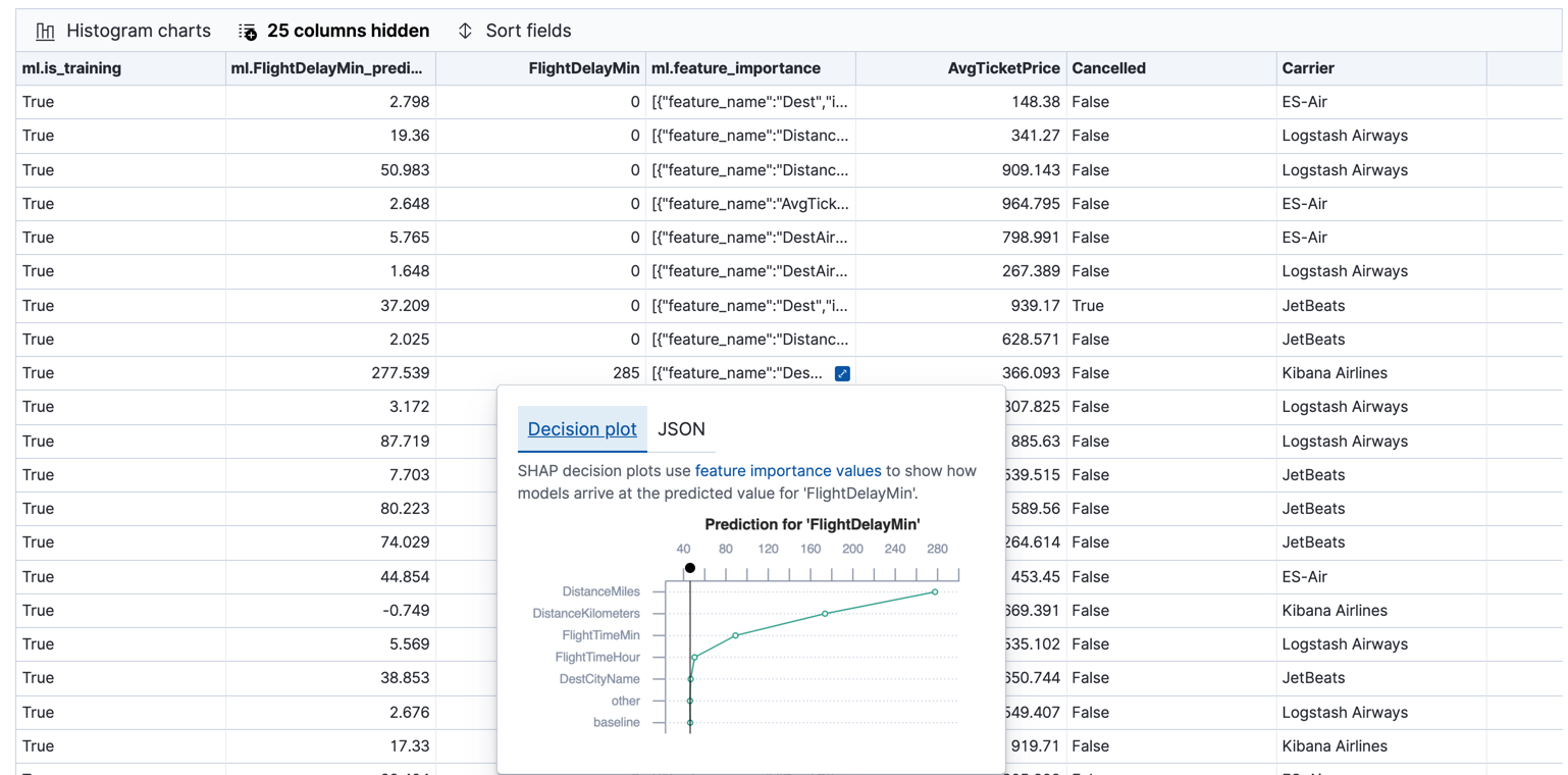

Now you have a new index that contains a copy of your source data with predictions for your dependent variable.
When you view the results in Kibana, it shows the contents of the destination index in a tabular format. It also provides information about the analysis details, model evaluation metrics, total feature importance values, and a scatterplot matrix. Let’s start by looking at the results table:
In this example, the table shows a column for the dependent variable (FlightDelayMin), which contains the ground truth values that we are trying to predict. It also shows a column for the prediction values (ml.FlightDelayMin_prediction) and a column that indicates whether the document was used in the training set (ml.is_training). You can filter the table to show only testing or training data and you can select which fields are shown in the table. You can also enable histogram charts to get a better understanding of the distribution of values in your data.
If you chose to calculate feature importance, the destination index also contains ml.feature_importance objects. Every field that is included in the regression analysis (known as a feature of the data point) is assigned a feature importance value. This value has both a magnitude and a direction (positive or negative), which indicates how each field affects a particular prediction. Only the most significant values (in this case, the top 5) are stored in the index. However, the trained model metadata also contains the average magnitude of the feature importance values for each field across all the training data. You can view this summarized information in Kibana:
You can also see the feature importance values for each individual prediction in the form of a decision plot:
The decision path starts at a baseline, which is the average of the predictions for all the data points in the training data set. From there, the feature importance values are added to the decision path until it arrives at its final prediction. The features with the most significant positive or negative impact appear at the top. Thus in this example, the features related to the flight distance had the most significant influence on this particular predicted flight delay. This type of information can help you to understand how models arrive at their predictions. It can also indicate which aspects of your data set are most influential or least useful when you are training and tuning your model.
If you do not use Kibana, you can see summarized feature importance values by using the get trained model API and the individual values by searching the destination index.

"feature_importance": [
"feature_name": "DestCityName",
"importance": 0.6285966753441136
"feature_name": "DistanceKilometers",
"importance": 84.4982943868267
"feature_name": "DistanceMiles",
"importance": 103.90011847132116
"feature_name": "FlightTimeHour",
"importance": 3.7119156097309345
"feature_name": "FlightTimeMin",
"importance": 38.700587425831365
"is_training": true
Lastly, Kibana provides a scatterplot matrix in the results. It has the same functionality as the matrix that you saw in the job wizard. Its purpose is to likewise help you visualize and explore the relationships between the numeric fields and the dependent variable in your data.
Though you can look at individual results and compare the predicted value (ml.FlightDelayMin_prediction) to the actual value (FlightDelayMins), you typically need to evaluate the success of the regression model as a whole.
Kibana provides training error metrics, which represent how well the model performed on the training data set. It also provides generalization error metrics, which represent how well the model performed on testing data.
A mean squared error (MSE) of zero means that the models predicts the dependent variable with perfect accuracy. This is the ideal, but is typically not possible. Likewise, an R-squared value of 1 indicates that all of the variance in the dependent variable can be explained by the feature variables. Typically, you compare the MSE and R-squared values from multiple regression models to find the best balance or fit for your data.
For more information about the interpreting the evaluation metrics, see 6. Evaluate the result.
You can alternatively generate these metrics with the data frame analytics evaluate API.
