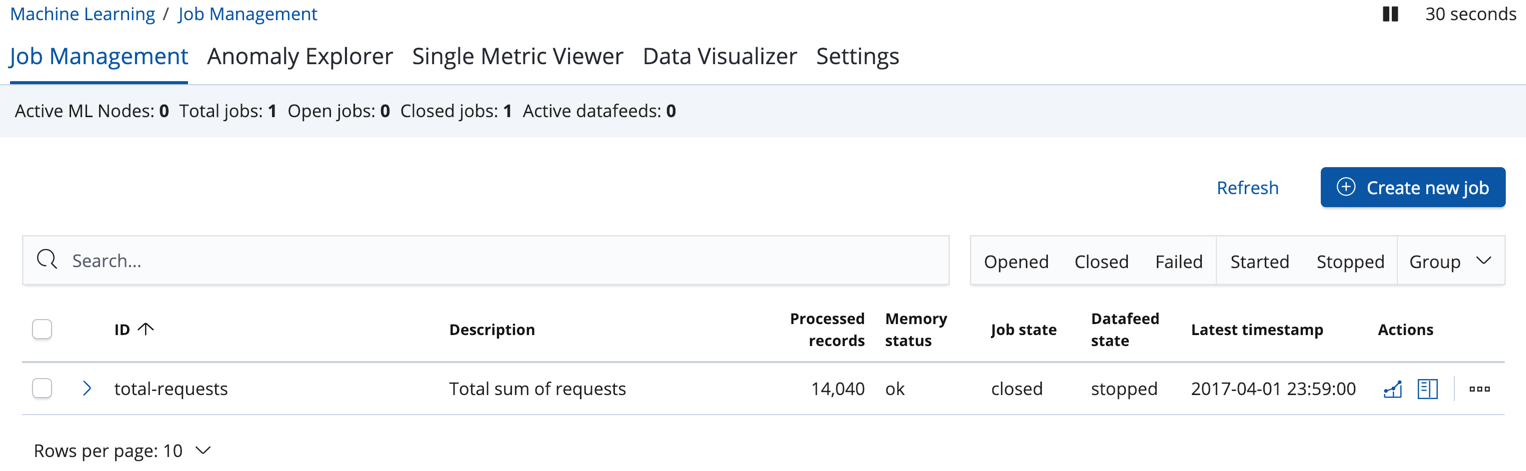

After you create a job, you can see its status in the Job Management tab:
Status information for the total-requests job
The following information is provided for each job:
Job ID
The unique identifier for the job.
Description
The optional description of the job.
Processed records
The number of records that have been processed by the job.
Memory status
The status of the mathematical models. When you create jobs by using the APIs or by using the advanced options in Kibana, you can specify a model_memory_limit. That value is the maximum amount of memory resources that the mathematical models can use. Once that limit is approached, data pruning becomes more aggressive. Upon exceeding that limit, new entities are not modeled. For more information about this setting, see Analysis Limits. The memory status field reflects whether you have reached or exceeded the model memory limit. It can have one of the following values:
ok
The models stayed below the configured value.
soft_limit
The models used more than 60% of the configured memory limit and older unused models will be pruned to free up space.
hard_limit
The models used more space than the configured memory limit. As a result, not all incoming data was processed.
Job state
The status of the job, which can be one of the following values:
opened
The job is available to receive and process data.
closed
The job finished successfully with its model state persisted. The job must be opened before it can accept further data.
closing
The job close action is in progress and has not yet completed. A closing job cannot accept further data.
failed
The job did not finish successfully due to an error. This situation can occur due to invalid input data. If the job had irrevocably failed, it must be force closed and then deleted. If the datafeed can be corrected, the job can be closed and then re-opened.
Datafeed state
The status of the datafeed, which can be one of the following values:
started
The datafeed is actively receiving data.
stopped
The datafeed is stopped and will not receive data until it is re-started.
Latest timestamp
The timestamp of the last processed record.
If you click the arrow beside the name of job, you can show or hide additional information, such as the settings, configuration information, or messages for the job.

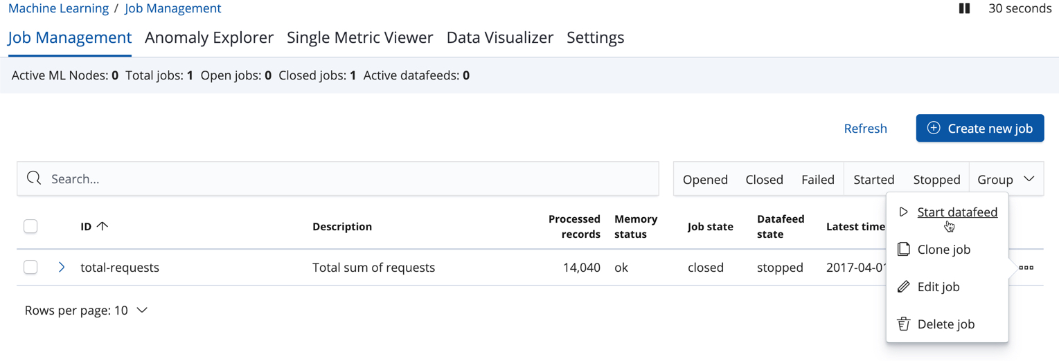

You can also click one of the Actions buttons to start the datafeed, edit the job or datafeed, and clone or delete the job, for example.

  1. In the Machine Learning / Job Management tab, click Start datafeed in the actions column.
    Start datafeed

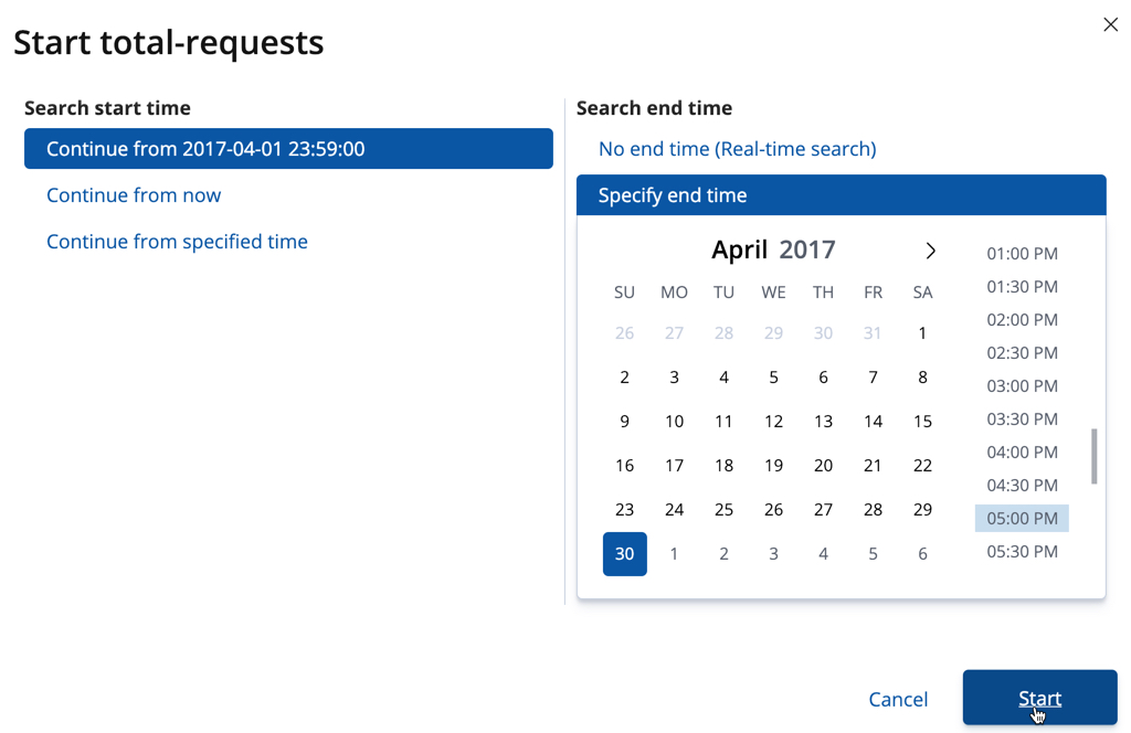

  2. Choose a start time and end time. For example, click Continue from 2017-04-01 23:59:00 and select 2017-04-30 as the search end time. Then click Start. The date picker defaults to the latest timestamp of processed data. Be careful not to leave any gaps in the analysis, otherwise you might miss anomalies.
    Restarting a datafeed
The datafeed state changes to started, the job state changes to opened, and the number of processed records increases as the new data is analyzed. The latest timestamp information also increases.
