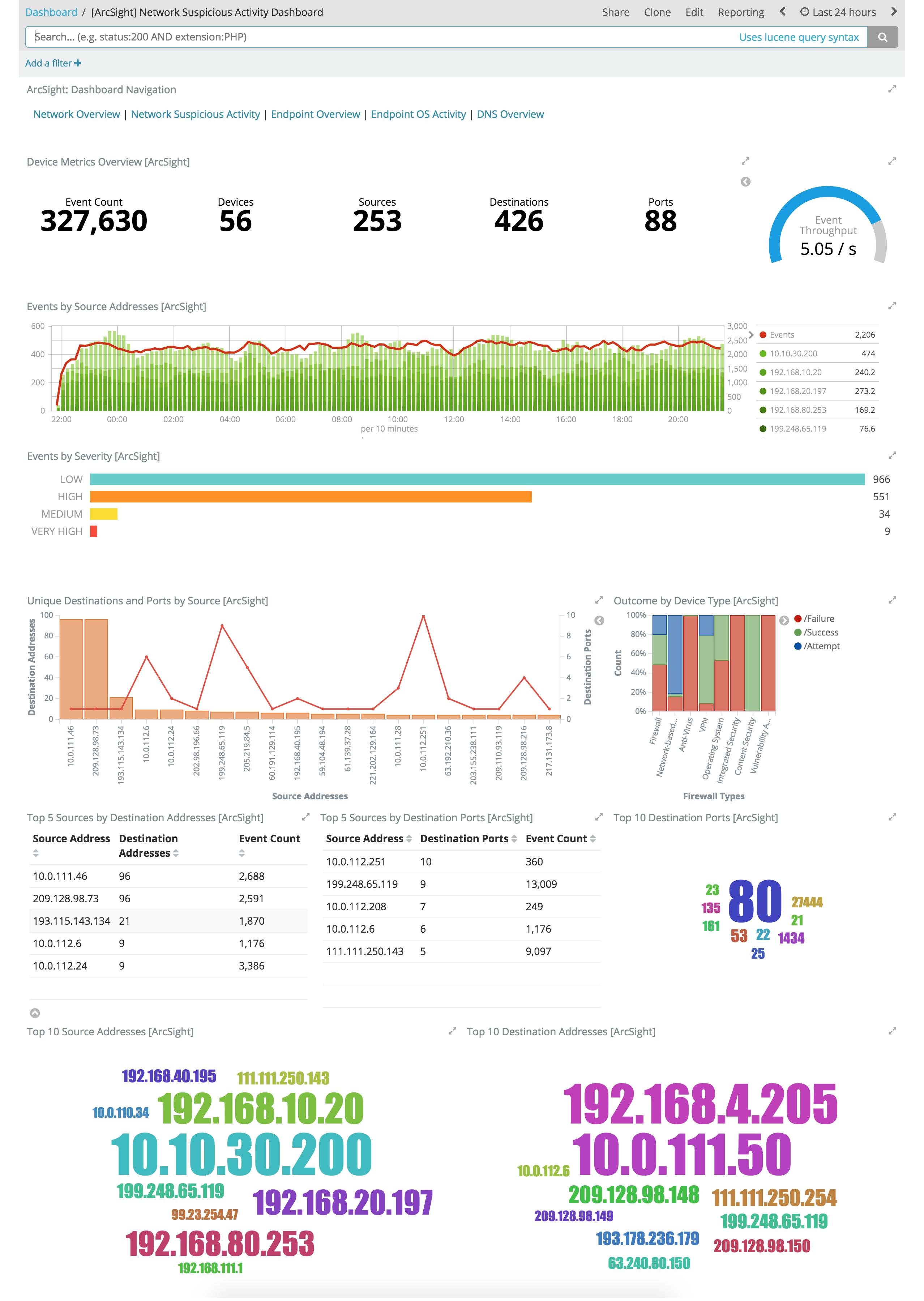

Example Network Dashboards
Network overview dashboard
Network suspicious activity dashboard
These Kibana visualizations enable you to quickly understand the top devices, endpoints, attackers, and targets. This insight, along with the ability to instantly drill down on a particular host, port, device, or time range, offers a holistic view across the entire environment to identify specific segments that may require immediate attention or action. You can easily discover answers to questions like:
  • Who are my attackers and what are they targeting?
  • Which of my devices or endpoints are the busiest and what services were rendered?
  • How many unique attackers, techniques, signatures, or targets were triggered at any given point in time?
  • What are the top sources, destinations, protocols, and behaviors that are causing the elevated count of failures?
