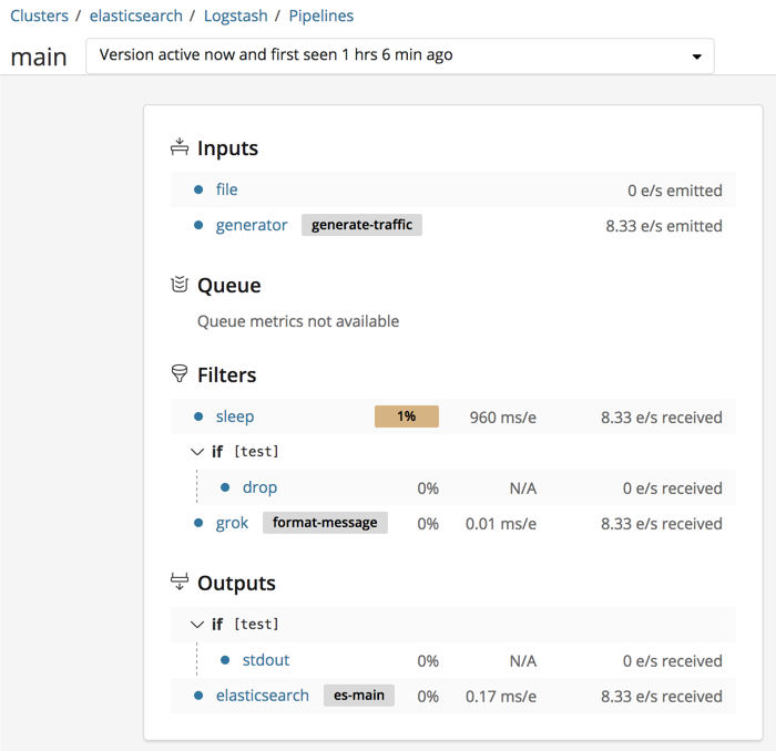

The pipeline viewer UI offers additional visibility into the behavior and performance of complex pipeline configurations. Use the pipeline viewer to visualize and monitor the behavior of complex Logstash pipeline configurations. You can see and interact with a tree view that illustrates the pipeline topology, data flow, and branching logic.
The pipeline viewer highlights CPU% and event latency in cases where the values are anomalous. This information helps you quickly identify processing that is disproportionately slow.
Pipeline Viewer

  • Kibana → Monitoring → Logstash → Pipelines
Each pipeline is identified by a pipeline ID (main by default). For each pipeline, you see the pipeline’s throughput and the number of nodes on which the pipeline is running during the selected time range.

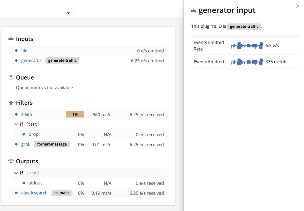

Many elements in the tree are clickable. For example, you can click the plugin name to expand the detail view.
Pipeline Input Detail
Click the arrow beside a branch name to collapse or expand it.
