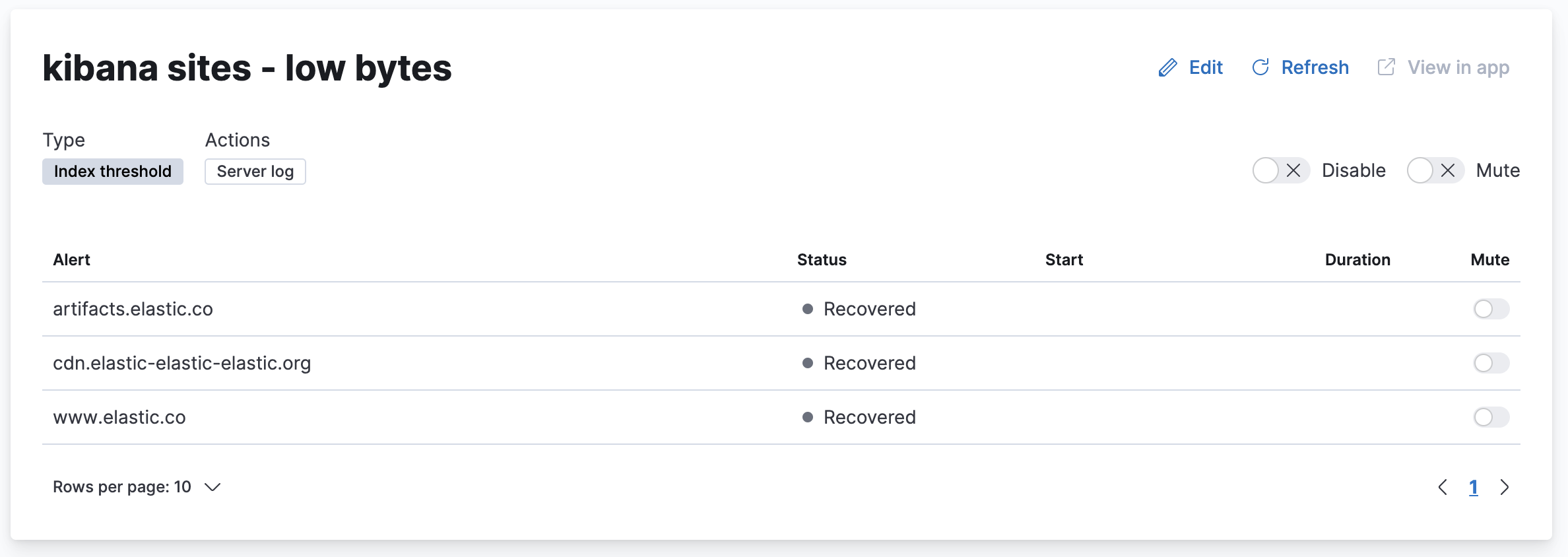

Using rules and connectors list for the current state and finding issuesedit
Rules in Stack Management lists the rules available in the space you’re currently in. When you click a rule name, you are navigated to the details page for the rule, where you can see currently active alerts. The start date on this page indicates when a rule is triggered, and for what alerts. In addition, the duration of the condition indicates how long the instance is active.
Alerting management details

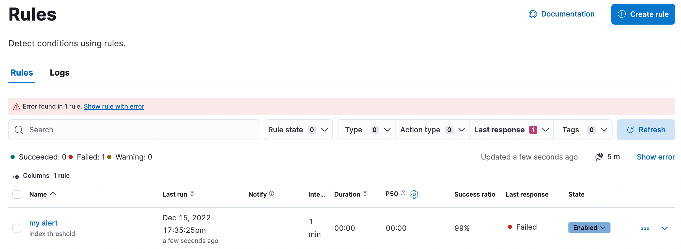

Look for error bannersedit
The Stack Management > Rules page contains an error banner that helps to identify the errors for the rules:
Rule management page with the errors banner
