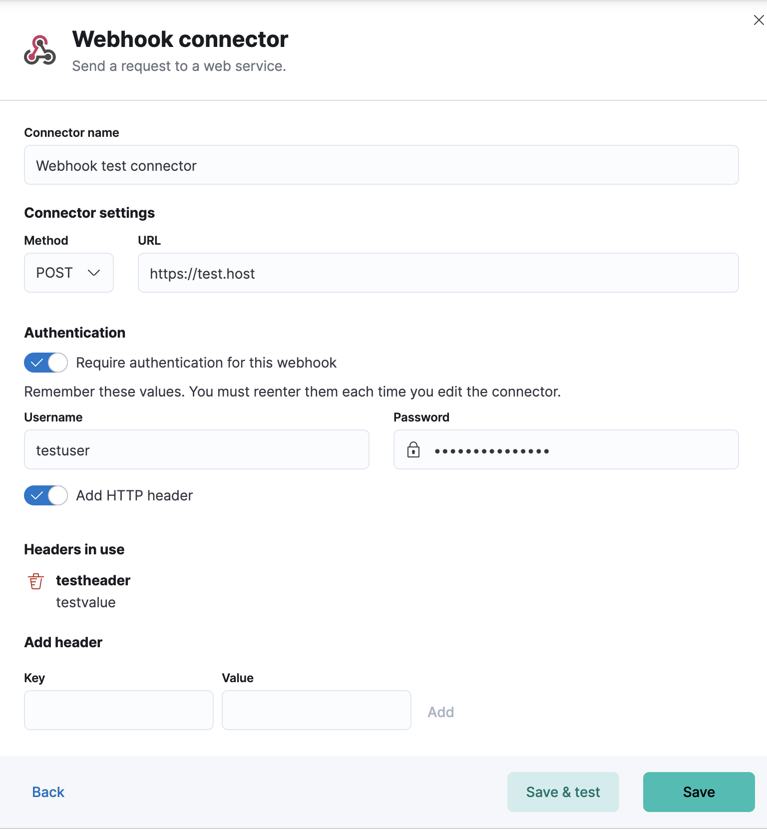

Connector configurationedit
Webhook connectors have the following configuration properties:
Name
The name of the connector.
URL
The request URL. If you are using the xpack.actions.allowedHosts setting, make sure the hostname is added to the allowed hosts.
Method
HTTP request method, either post(default) or put.
Headers
A set of key-value pairs sent as headers with the request
Require authentication
If true, a username and password for login type authentication must be provided.
Username
Username for HTTP basic authentication.
Password
Password for HTTP basic authentication.

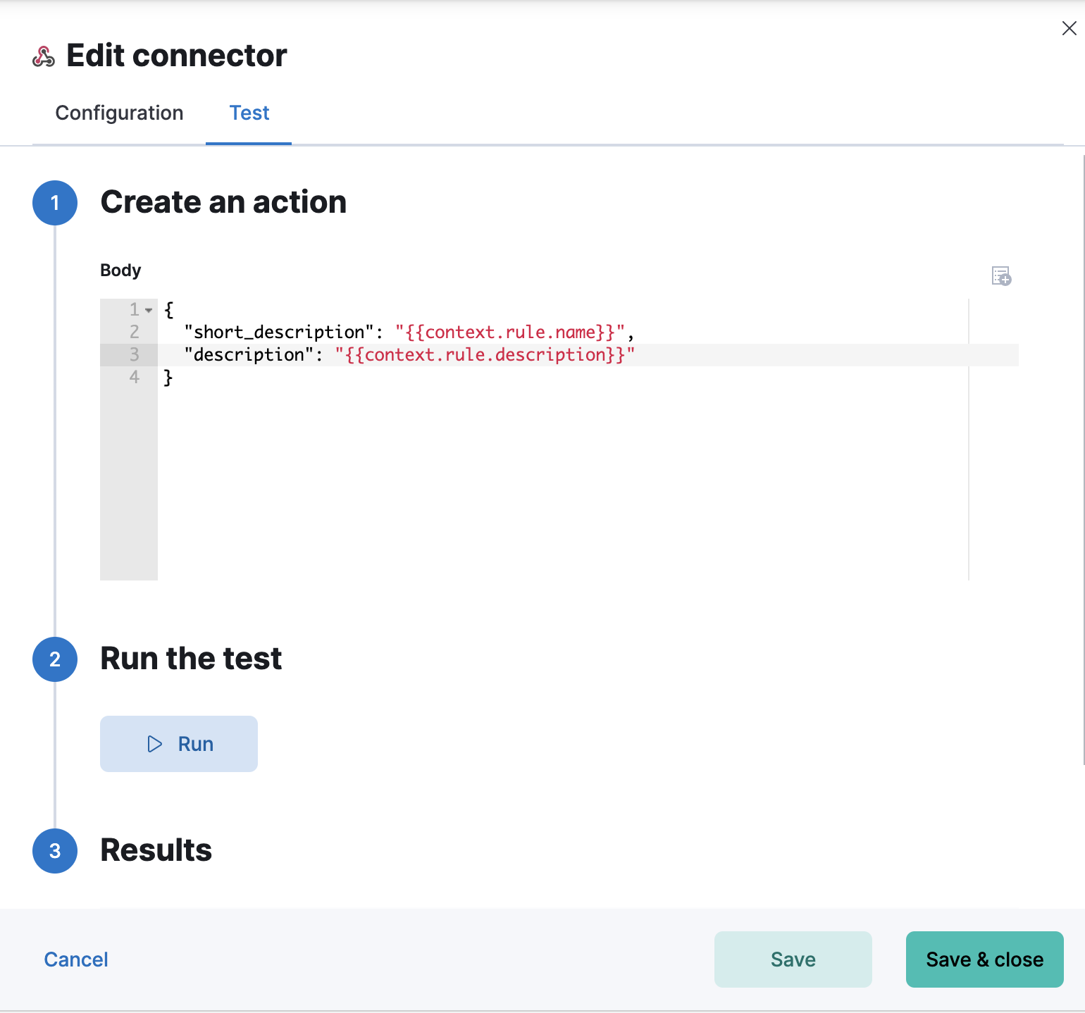

Test connectorsedit
You can test connectors with the run connector API or as you’re creating or editing the connector in Kibana. For example:
Webhook params test
Webhook actions have the following properties.
Body
A JSON payload sent to the request URL. For example:
  "short_description": "{{context.rule.name}}",
  "description": "{{context.rule.description}}",
Mustache template variables (the text enclosed in double braces, for example, context.rule.name) have their values escaped, so that the final JSON will be valid (escaping double quote characters). For more information on Mustache template variables, refer to Action type and details.
