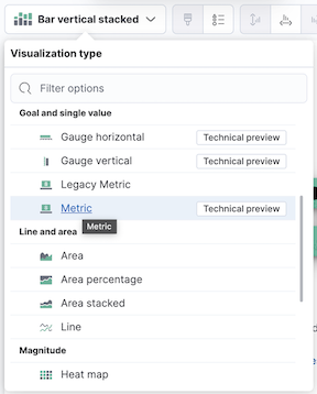

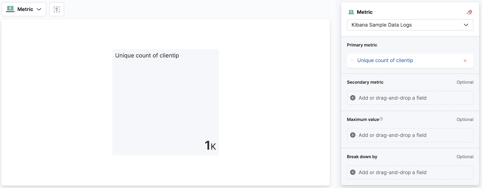

Pick a field you want to analyze, such as clientip. To analyze only the clientip field, use the Metric visualization to display the field as a number.
The only number function that you can use with clientip is Unique count, also referred to as cardinality, which approximates the number of unique values.
  1. Open the Visualization type dropdown, then select Metric.
  2. From the Available fields list, drag clientip to the workspace or layer pane.
    Metric visualization of the clientip field
    In the layer pane, Unique count of clientip appears because the editor automatically applies the Unique count function to the clientip field. Unique count is the only numeric function that works with IP addresses.
  3. In the layer pane, click Unique count of clientip.
    1. In the Name field, enter Unique visitors.
    2. Click Close.
  4. Click Save and return.

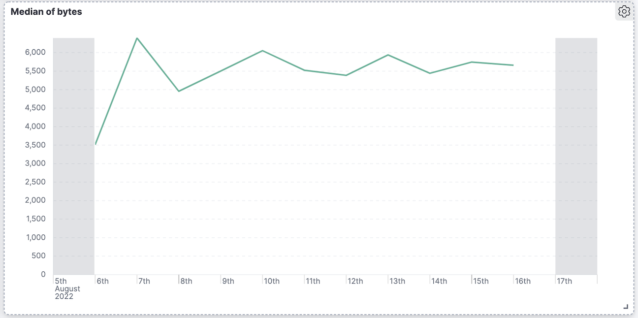

There are two shortcuts you can use to view metrics over time. When you drag a numeric field to the workspace, the visualization editor adds the default time field from the data view. When you use the Date histogram function, you can replace the time field by dragging the field to the workspace.

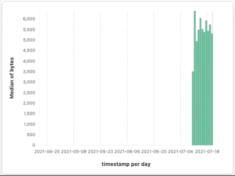

To visualize the bytes field over time:
  1. On the dashboard, click Create visualization.
  2. From the Available fields list, drag bytes to the workspace.
    The visualization editor creates a bar chart with the timestamp and Median of bytes fields.
  3. To zoom in on the data, click and drag your cursor across the bars.
    Zoom in on the data
To emphasize the change in Median of bytes over time, change the visualization type to Line with one of the following options:
  • In the Suggestions, click the line chart.
  • In the editor toolbar, open the Visualization type dropdown, then select Line.
  • In the layer pane, open the Layer visualization type menu, then click Line.
To increase the minimum time interval:
  1. In the layer pane, click timestamp.
  2. Change the Minimum interval to 1d, then click Close.
    You can increase and decrease the minimum interval, but you are unable to decrease the interval below the configured Advanced Settings.

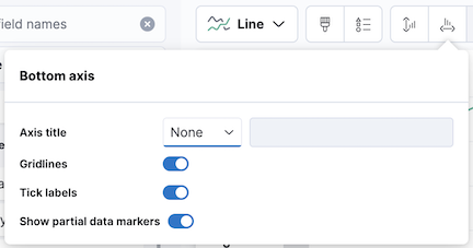

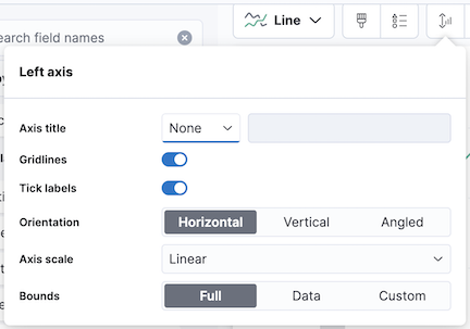

To save space on the dashboard, hide the axis labels.
  1. Open the Left axis menu, then select None from the Axis title dropdown.
    Left axis menu
  2. Open the Bottom axis menu, then select None from the Axis title dropdown.
    Bottom axis menu
  3. Click Save and return
Since you removed the axis labels, add a panel title:
  1. Open the panel menu, then select Edit panel title.
  2. In the Panel title field, enter Median of bytes, then click Save.
    Line chart that displays metric data over time

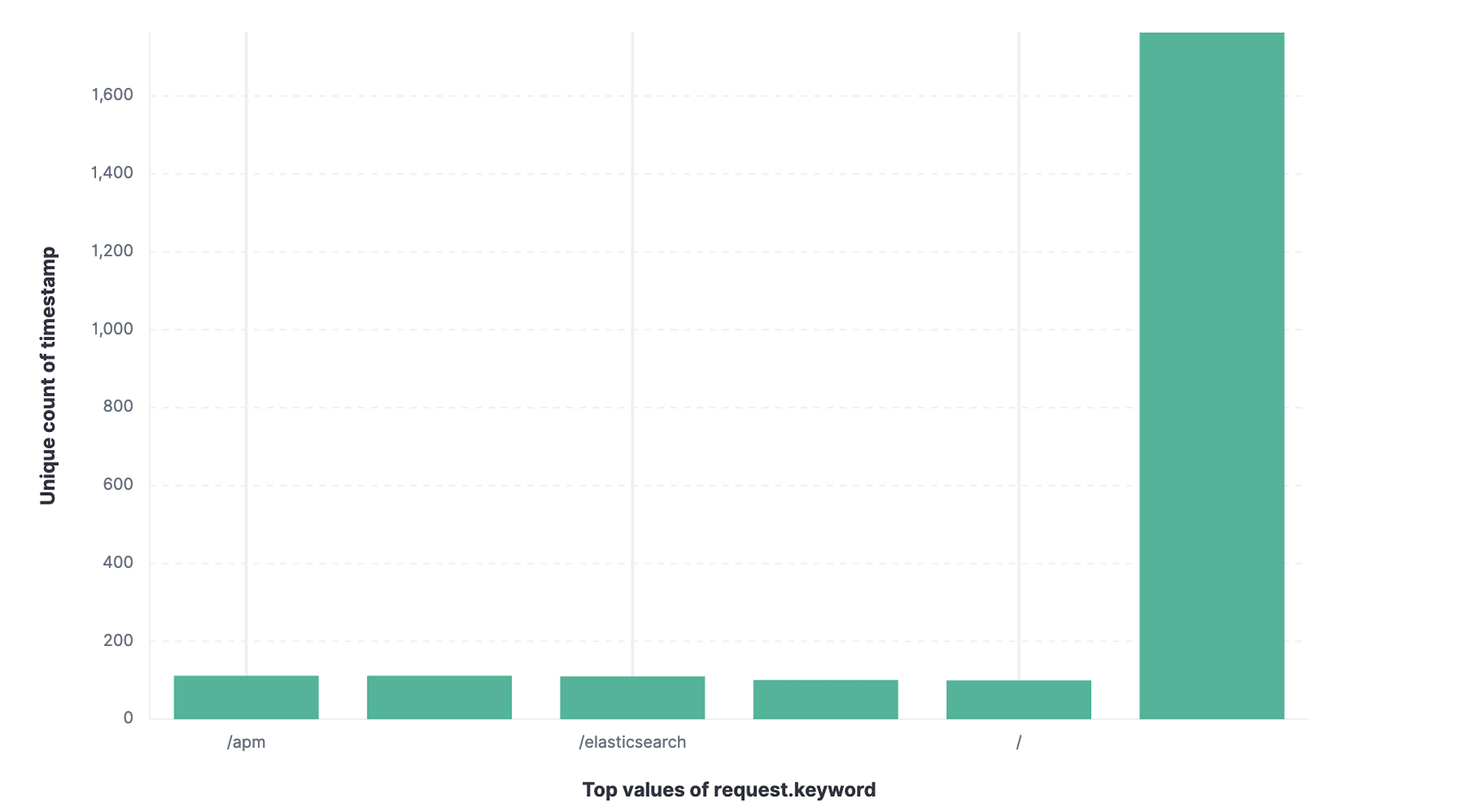

View the top values of a fieldedit

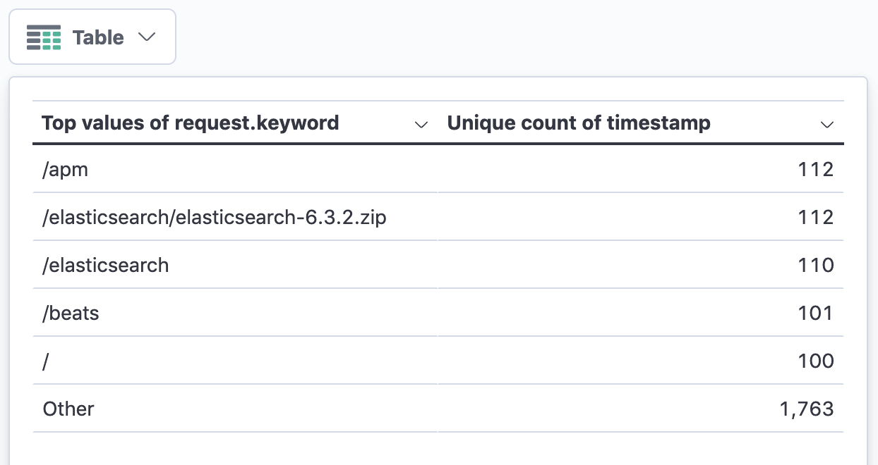

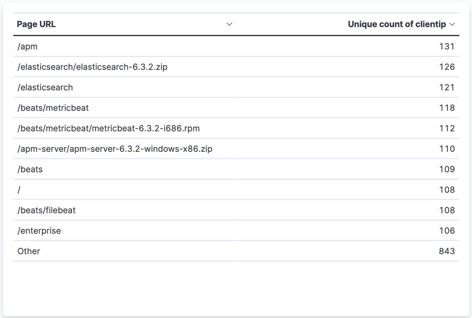

Create a visualization that displays the most frequent values of request.keyword on your website, ranked by the unique visitors. To create the visualization, use Top values of request.keyword ranked by Unique count of clientip, instead of being ranked by Count of records.
The Top values function ranks the unique values of a field by another function. The values are the most frequent when ranked by a Count function, and the largest when ranked by the Sum function.
  2. From the Available fields list, drag clientip to the Vertical axis field in the layer pane.
    The visualization editor automatically applies the Unique count function. If you drag clientip to the workspace, the editor adds the field to the incorrect axis.
  3. Drag request.keyword to the workspace.
    Vertical bar chart with top values of request.keyword by most unique visitors
    When you drag a text or IP address field to the workspace, the editor adds the Top values function ranked by Count of records to show the most frequent values.
The chart labels are unable to display because the request.keyword field contains long text fields. You could use one of the Suggestions, but the suggestions also have issues with long text. The best way to display long text fields is with the Table visualization.
  1. Open the Visualization type dropdown, then select Table.
    Table with top values of request.keyword by most unique visitors
  2. In the layer pane, click Top 5 values of request.keyword.
    1. In the Number of values field, enter 10.
    2. In the Name field, enter Page URL.
    3. Click Close.
      Table that displays the top field values
  3. Click Save and return.
    Since the table columns are labeled, you do not need to add a panel title.

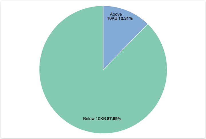

Compare a subset of documents to all documentsedit
Create a proportional visualization that helps you determine if your users transfer more bytes from documents under 10KB versus documents over 10Kb.
  2. From the Available fields list, drag bytes to the Vertical axis field in the layer pane.
  3. In the layer pane, click Median of bytes.
  4. Click the Sum quick function, then click Close.
  5. From the Available fields list, drag bytes to the Break down by field in the layer pane.

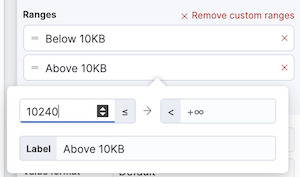

To select documents based on the number range of a field, use the Intervals function. When the ranges are non numeric, or the query requires multiple clauses, you could use the Filters function.
Specify the file size ranges:
  1. In the layer pane, click bytes.
  2. Click Create custom ranges, enter the following in the Ranges field, then press Return:
    • Ranges010240
    • LabelBelow 10KB
  3. Click Add range, enter the following, then press Return:
    • Ranges10240+∞
    • LabelAbove 10KB
      Custom ranges configuration
  4. From the Value format dropdown, select Bytes (1024), then click Close.
To display the values as a percentage of the sum of all values, use the Pie chart.
  1. Open the Visualization Type dropdown, then select Pie.
    Pie chart that compares a subset of documents to all documents
  2. Click Save and return.
Add a panel title:
  2. In the Panel title field, enter Sum of bytes from large requests, then click Save.

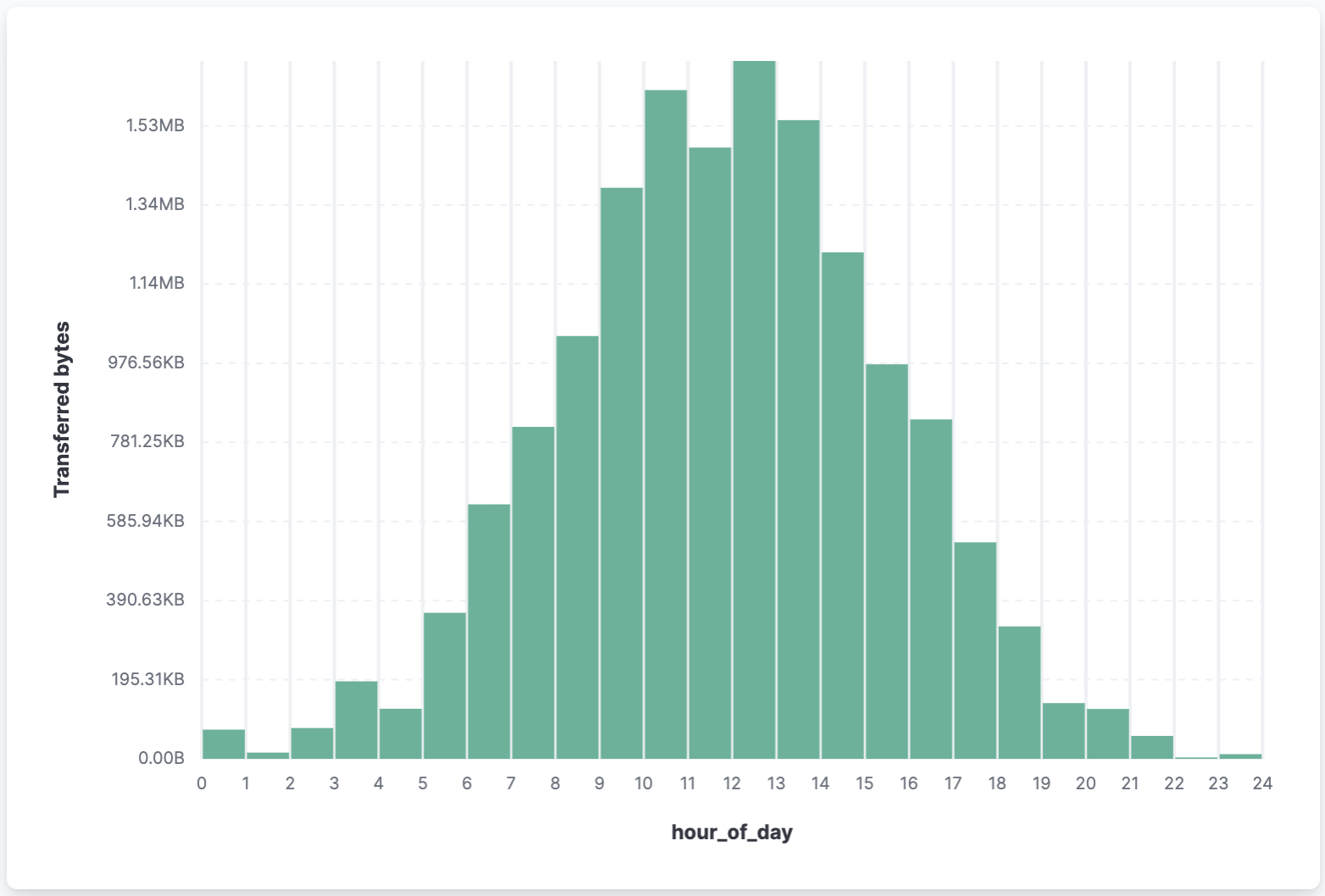

View the distribution of a number fieldedit
The distribution of a number can help you find patterns. For example, you can analyze the website traffic per hour to find the best time for routine maintenance.
  2. From the Available fields list, drag bytes to Vertical axis field in the layer pane.
    1. Click the Sum quick function.
    2. In the Name field, enter Transferred bytes.
    3. From the Value format dropdown, select Bytes (1024), then click Close.
  4. From the Available fields list, drag hour_of_day to Horizontal axis field in the layer pane.
  5. In the layer pane, click hour_of_day, then slide the Intervals granularity slider until the horizontal axis displays hourly intervals.
    Bar chart that displays the distribution of a number field
  6. Click Save and return.
Add a panel title:
  2. In the Panel title field, enter Website traffic, then click Save.

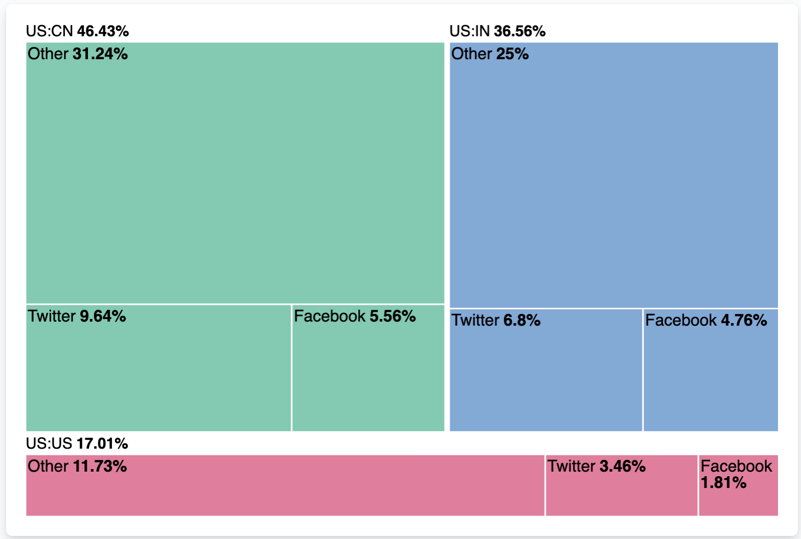

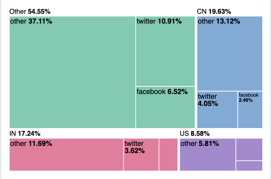

Create a multi-level chartedit
Table and Proportion visualizations support multiple functions. For example, to create visualizations that break down the data by website traffic sources and user geography, apply the Filters and Top values functions.
  2. Open the Visualization type dropdown, then select Treemap.
  3. From the Available fields list, drag Records to the Size by field in the layer pane.
  4. In the layer pane, click Add or drag-and-drop a field for Group by.
Create a filter for each website traffic source:
  1. Click Filters.
  2. Click All records, enter the following in the query bar, then press Return:
    • KQLreferer : *facebook.com*
    • LabelFacebook
  3. Click Add a filter, enter the following in the query bar, then press Return:
    • KQLreferer : *twitter.com*
    • LabelTwitter
  4. Click Add a filter, enter the following in the query bar, then press Return:
    • KQLNOT referer : *twitter.com* OR NOT referer: *facebook.com*
    • LabelOther
  5. Click Close.
Add the user geography grouping:
  1. From the Available fields list, drag geo.srcdest to the workspace.
  2. To change the Group by order, drag Top 3 values of geo.srcdest in the layer pane so that appears first.
    Treemap visualization
Remove the documents that do not match the filter criteria:
  1. In the layer pane, click Top 3 values of geo.srcdest.
  2. Click Advanced, deselect Group other values as "Other", then click Close.
Add a panel title:
  2. In the Panel title field, enter Page views by location and referrer, then click Save.

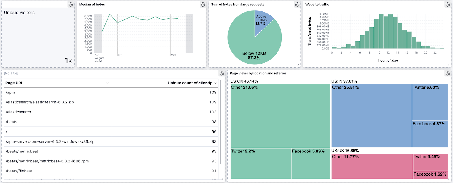

Arrange the dashboard panelsedit
Resize and move the panels so they all appear on the dashboard without scrolling.
Decrease the size of the following panels, then move the panels to the first row:
  • Unique visitors
  • Median of bytes
  • Sum of bytes from large requests
  • Website traffic
    Logs dashboard
Save the dashboardedit
Now that you have a complete overview of your web server data, save the dashboard.
  1. In the toolbar, click Save.
  2. On the Save dashboard window, enter Logs dashboard in the Title field.
  3. Select Store time with dashboard.
  4. Click Save.
