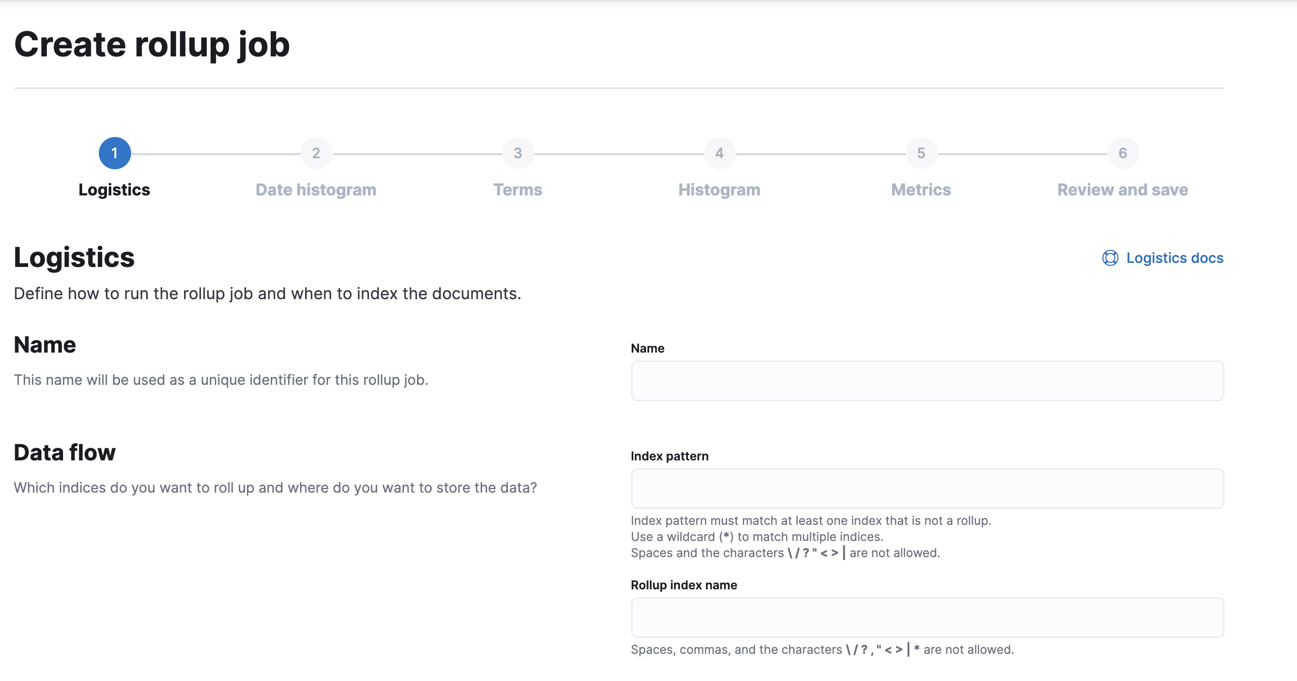

Create a rollup jobedit
Kibana makes it easy for you to create a rollup job by walking you through the process. You fill in the name, data flow, and how often you want to roll up the data. Then you define a date histogram aggregation for the rollup job and optionally define terms, histogram, and metrics aggregations.
When defining the index pattern, you must enter a name that is different than the output rollup index. Otherwise, the job will attempt to capture the data in the rollup index. For example, if your index pattern is metricbeat-*, you can name your rollup index rollup-metricbeat, but not metricbeat-rollup.
][Wizard that walks you through creation of a rollup job

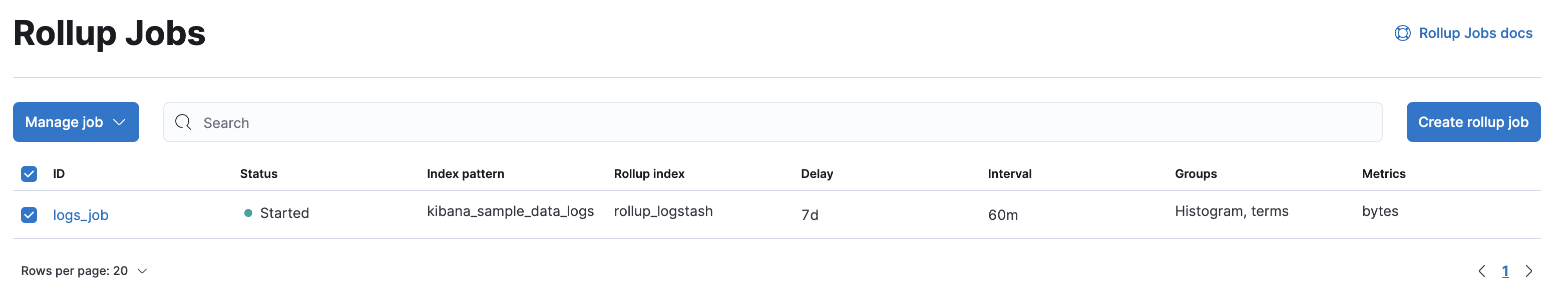

Start, stop, and delete rollup jobsedit

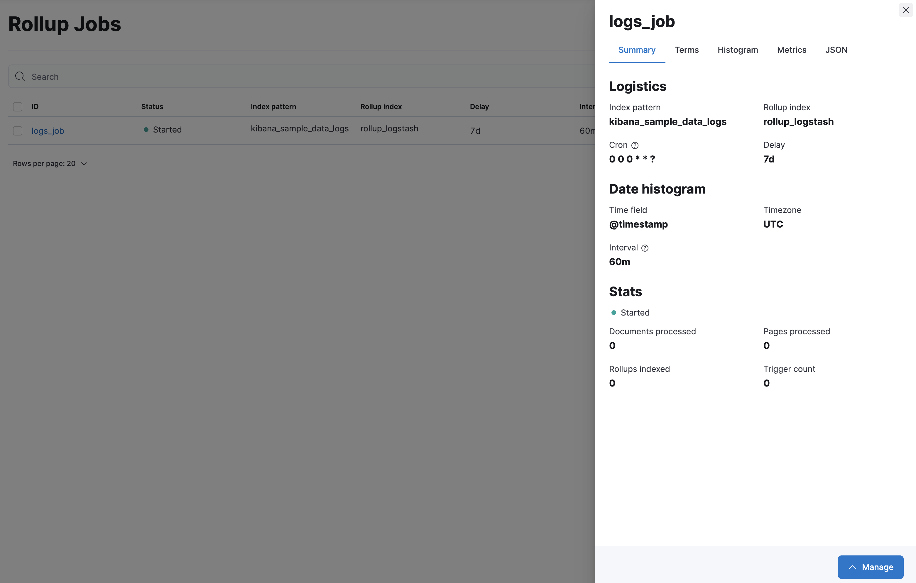

Once you’ve saved a rollup job, you’ll see it the Rollup Jobs overview page, where you can drill down for further investigation. The Manage menu enables you to start, stop, and delete the rollup job. You must first stop a rollup job before deleting it.
][Rollup job details
You can’t change a rollup job after you’ve created it. To select additional fields or redefine terms, you must delete the existing job, and then create a new one with the updated specifications. Be sure to use a different name for the new rollup job—reusing the same name can lead to problems with mismatched job configurations. Refer to rollup job configuration.

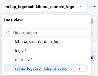

  3. Enter rollup_logstash,kibana_sample_logs as your Data View and @timestamp as the Time Filter field name.
    The notation for a combination data view with both raw and rolled up data is rollup_logstash,kibana_sample_data_logs. In this data view, rollup_logstash matches the rollup index and kibana_sample_data_logs matches the raw data.

  7. Choose rollup_logstash,kibana_sample_data_logs as your source to see both the raw and rolled up data.
    ][Create visualization of rolled up data

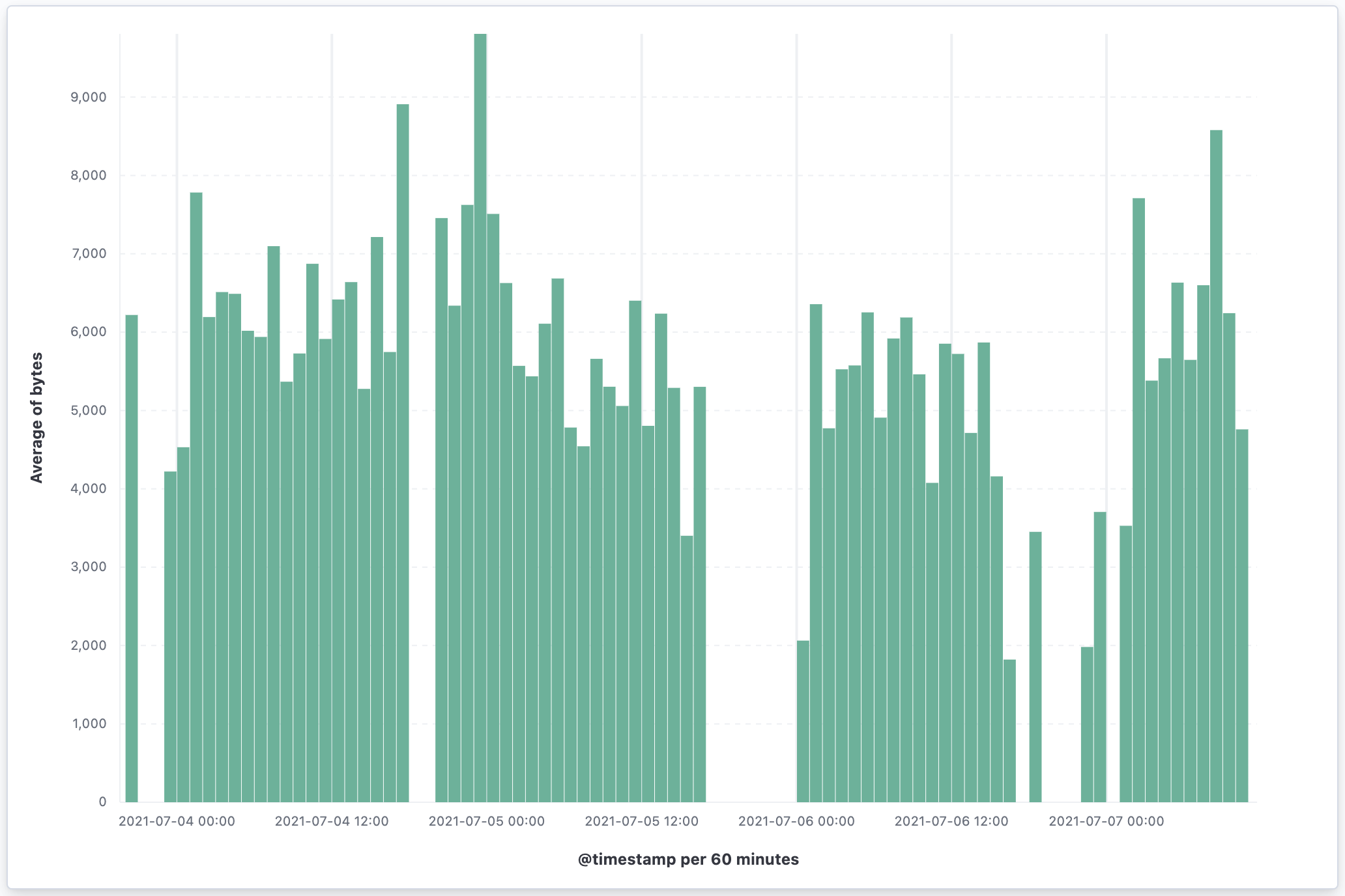

  8. Select Bar vertical stacked in the chart type dropdown.
  9. Add the @timestamp field to the Horizontal axis.
  10. Add the bytes field to the Vertical axis, defaulting to an Average of bytes.
    Kibana creates a vertical bar chart of your data. Select a section of the chart to zoom in.
    ][Dashboard with rolled up data
