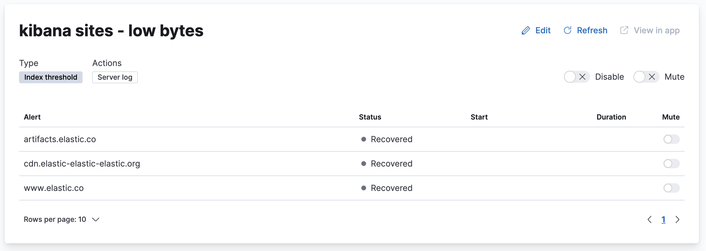

Using rules and connectors list for the current state and finding issues
editRules and Connectors in Stack Management lists the rules and connectors available in the space you’re currently in. When you click a rule name, you are navigated to the details page for the rule, where you can see currently active alerts. The start date on this page indicates when a rule is triggered, and for what alerts. In addition, the duration of the condition indicates how long the instance is active.

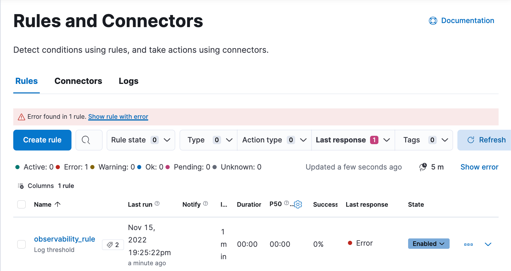

Look for error banners
editThe Stack Management > Rules and Connectors page contains an error banner that helps to identify the errors for the rules:
