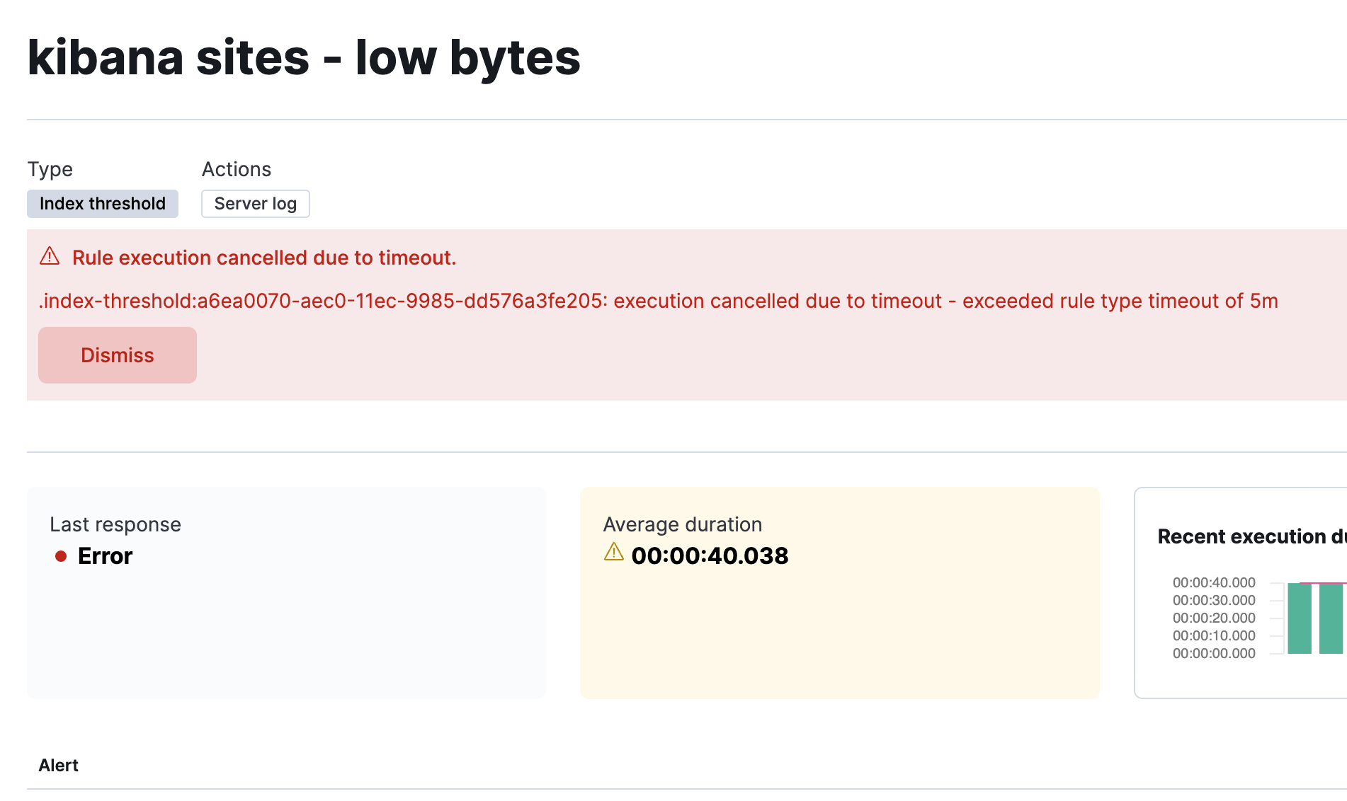

By default, rules have a 5m timeout. Rules that run longer than this timeout are automatically cancelled to prevent them from consuming too much of Kibana’s resources. Alerts and actions that may have been scheduled before the rule timed out are discarded. When a rule times out, you will see this error in the Kibana logs:
[2022-03-28T13:14:04.062-04:00][WARN ][plugins.taskManager] Cancelling task alerting:.index-threshold "a6ea0070-aec0-11ec-9985-dd576a3fe205" as it expired at 2022-03-28T17:14:03.980Z after running for 05m 10s (with timeout set at 5m).
and in the details page:
If you want your rules to run longer, update the xpack.alerting.rules.run.timeout configuration in your Alerting settings. You can also target a specific rule type by using xpack.alerting.rules.run.ruleTypeOverrides.
