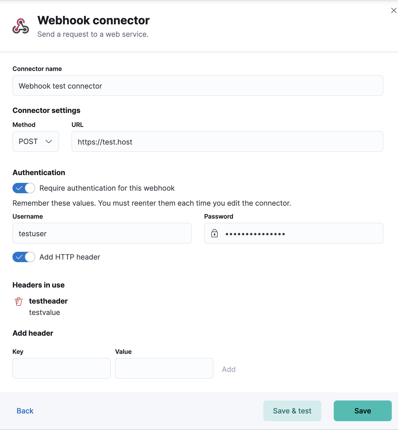

Define connector in Stack Managementedit
Define Webhook connector properties.

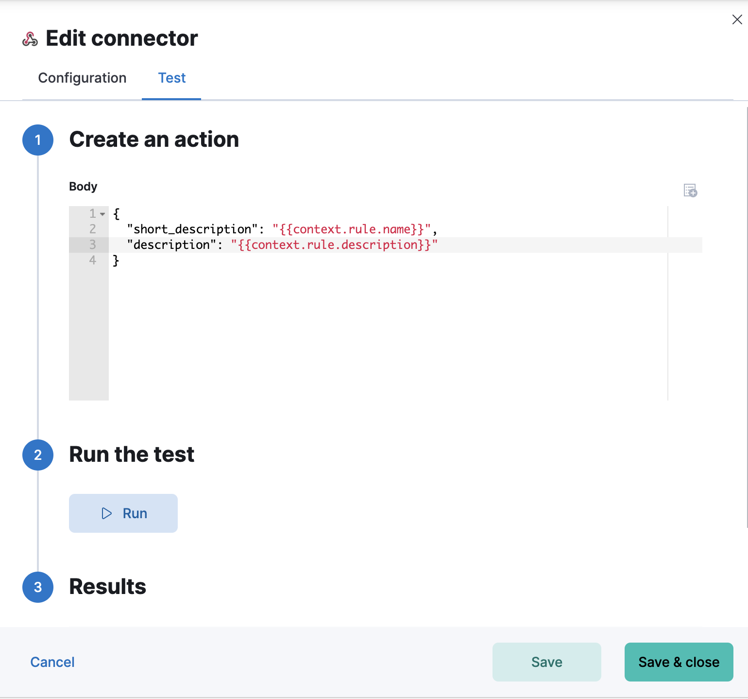

Webhook connector
Test Webhook action parameters.
Webhook params test
