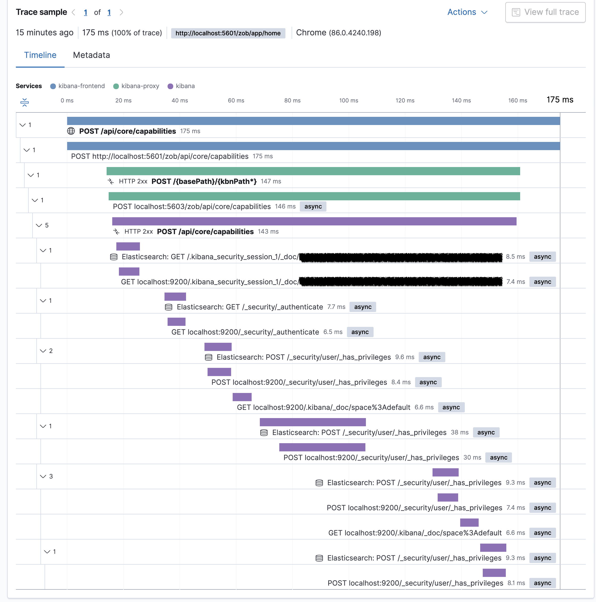

Once the agent is active, it will trace all incoming HTTP requests to Kibana, monitor for errors, and collect process-level metrics. The collected data will be sent to the APM Server and is viewable in the APM UI in Kibana.

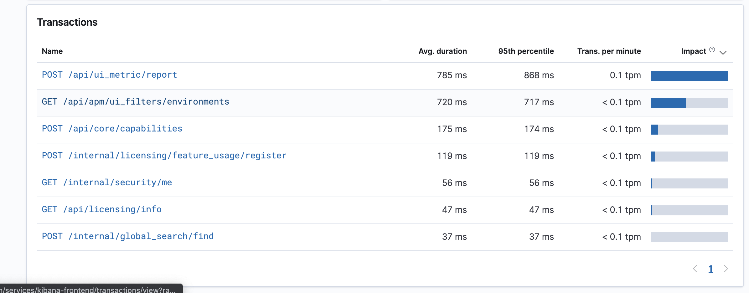

config/apm.dev.jsfile:module.exports = { active: true, serverUrl: 'http://127.0.0.1:8200', // supports `http://localhost:8200` centralConfig: false, breakdownMetrics: false, transactionSampleRate: 0.1, metricsInterval: '120s' }; -
Start Kibana with APM active using:
yarn start
- After Kibana starts up, navigate to the APM app, where you should see some transactions.
