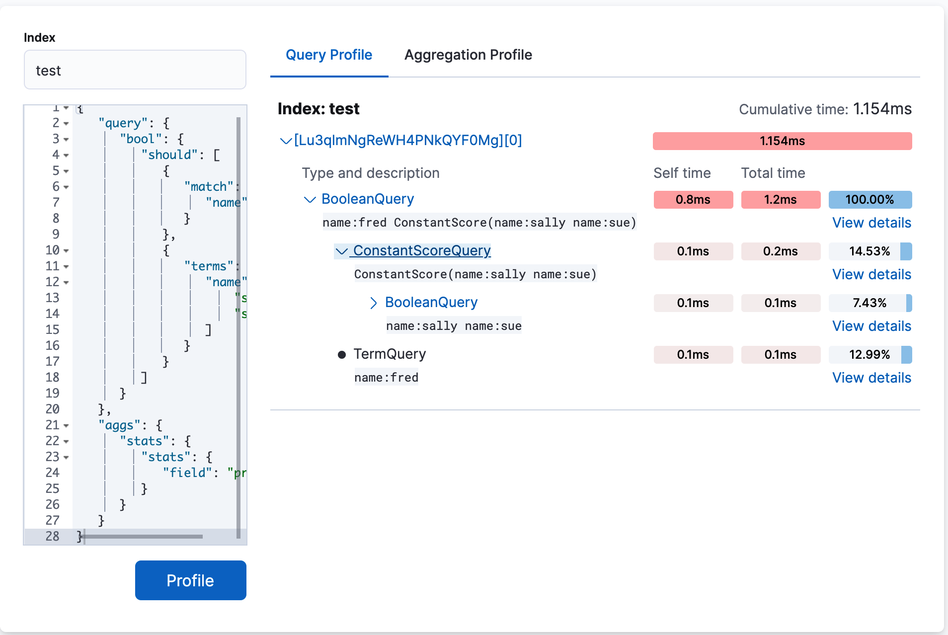

Profile a more complicated query
editTo understand how the query trees are displayed inside the Search Profiler, take a look at a more complicated query.
Index the following data via Console:
POST test/_bulk {"index":{}} {"name":"aaron","age":23,"hair":"brown"} {"index":{}} {"name":"sue","age":19,"hair":"red"} {"index":{}} {"name":"sally","age":19,"hair":"blonde"} {"index":{}} {"name":"george","age":19,"hair":"blonde"} {"index":{}} {"name":"fred","age":69,"hair":"blonde"}
From the Search Profiler, enter test in the Index field to restrict profiled
queries to the
test
index. -
Replace the default
match_all
query in the query editor with a query that has two sub-query components and includes a simple aggregation:{ "query": { "bool": { "should": [ { "match": { "name": "fred" } }, { "terms": { "name": [ "sue", "sally" ] } } ] } }, "aggs": { "stats": { "stats": { "field": "price" } } } }
Click Profile to profile the query and visualize the results.
The top
BooleanQuery
component corresponds to the bool in the query. -
The second
BooleanQuery
corresponds to the terms query, which is internally converted to aBoolean
of should clauses. It has two child queries that correspond to "sally" and "sue from the terms query. -
The
TermQuery
that’s labeled with "name:fred" corresponds to match: fred in the query.If you look at the time columns, you can see that Self time and Total time are no longer identical on all the rows. Self time represents how long the query component took to execute. Total time is the time a query component and all its children took to execute. Therefore, queries like the Boolean queries often have a larger total time than self time.

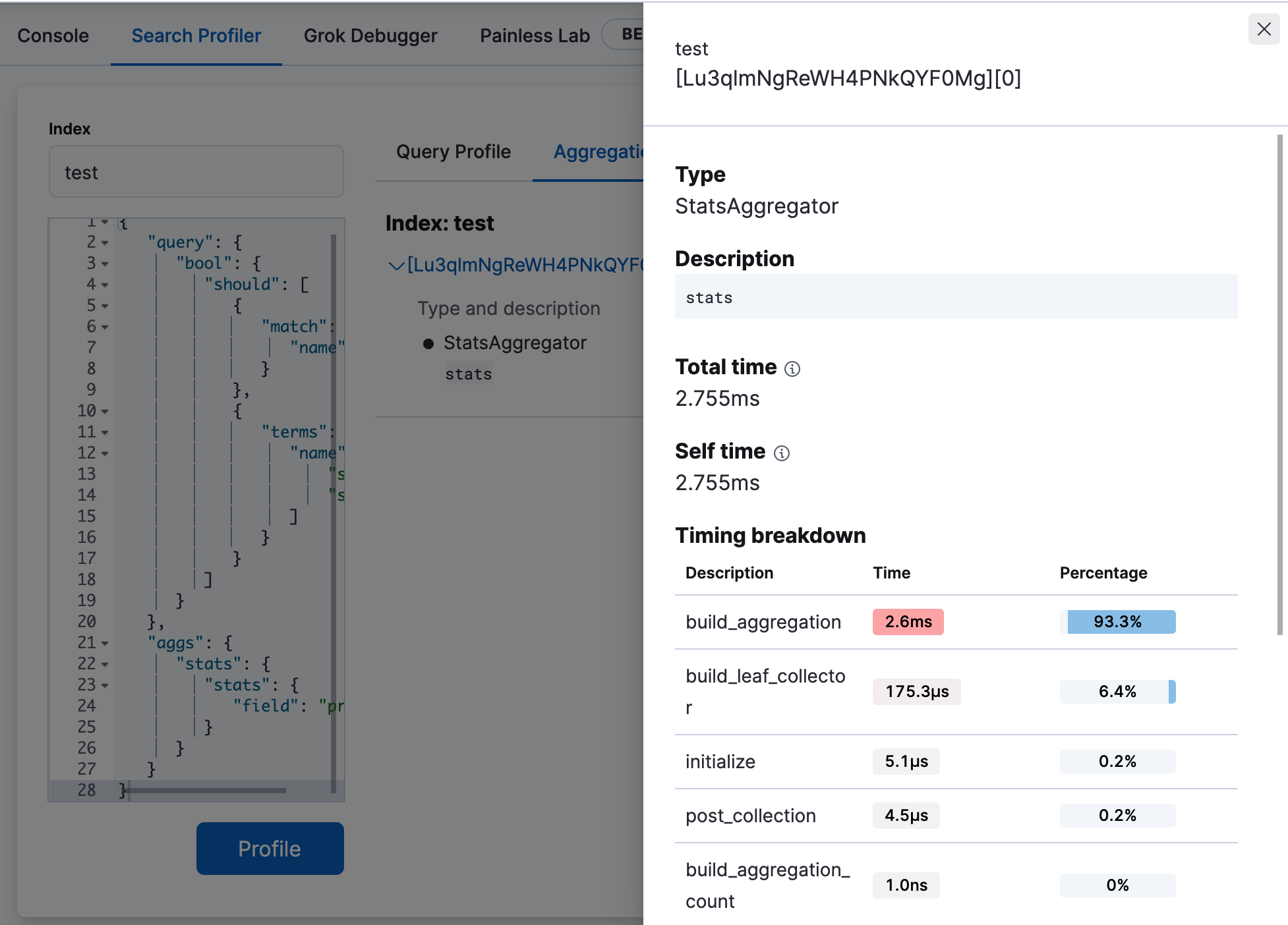

The top
Click Aggregation Profile to view aggregation profiling statistics.
This query includes a
stats
agg on the"age"
field. The Aggregation Profile tab is only enabled when the query being profiled contains an aggregation. -
Click View details to view the timing breakdown.
