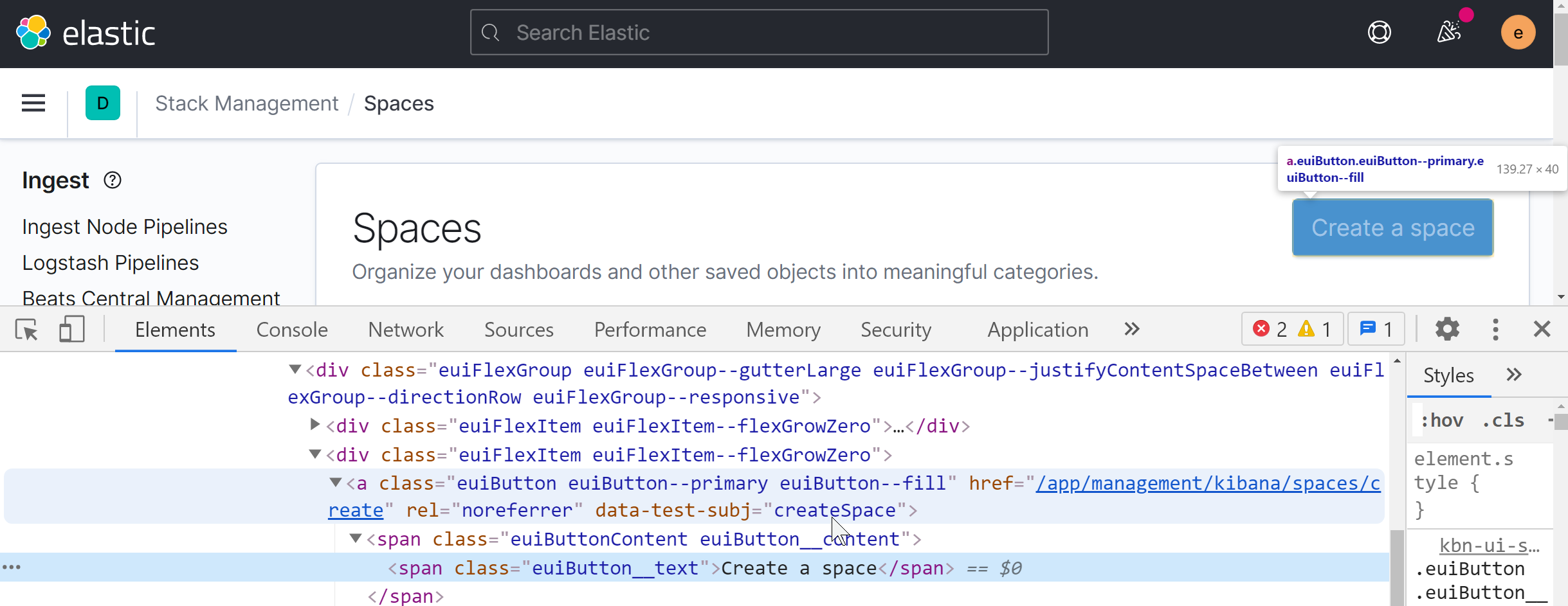

If we use a running Kibana instance and inspect elements, we find that the createSpace
data-test-subj attribute is on this button in the Spaces page in Stack Management:
We know the test was not on the correct page to find the element to click. We see in the debug log the repeated attempts to find the element. If we scroll to the start of those repeated attempts, we see that the first thing the test did was this attempt to click on the createSpace
element.
