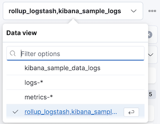

- Go to the Data Views page using the navigation menu or the global search field.
- Click Create data view, and select Rollup data view from the dropdown.
Enter rollup_logstash,kibana_sample_logs as your Data View and
@timestamp
as the Time Filter field name.The notation for a combination data view with both raw and rolled up data is
rollup_logstash,kibana_sample_data_logs
. In this data view,rollup_logstash
matches the rollup index andkibana_sample_data_logs
matches the raw data. - Go to Dashboards, then select Create dashboard.
- Set the time filter to Last 90 days.
- On the dashboard, click Create visualization.
Choose
as your source to see both the raw and rolled up data. - Select Bar in the chart type dropdown.

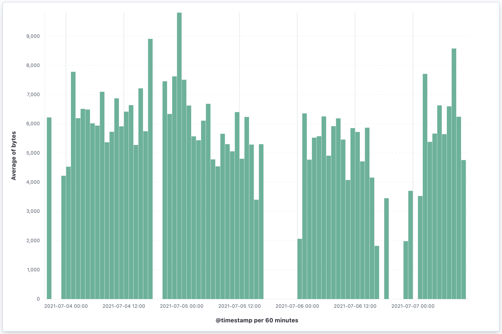

Add the
@timestamp
field to the Horizontal axis. -
Add the
bytes
field to the Vertical axis, defaulting to anAverage of bytes
.Kibana creates a vertical bar chart of your data. Select a section of the chart to zoom in.
