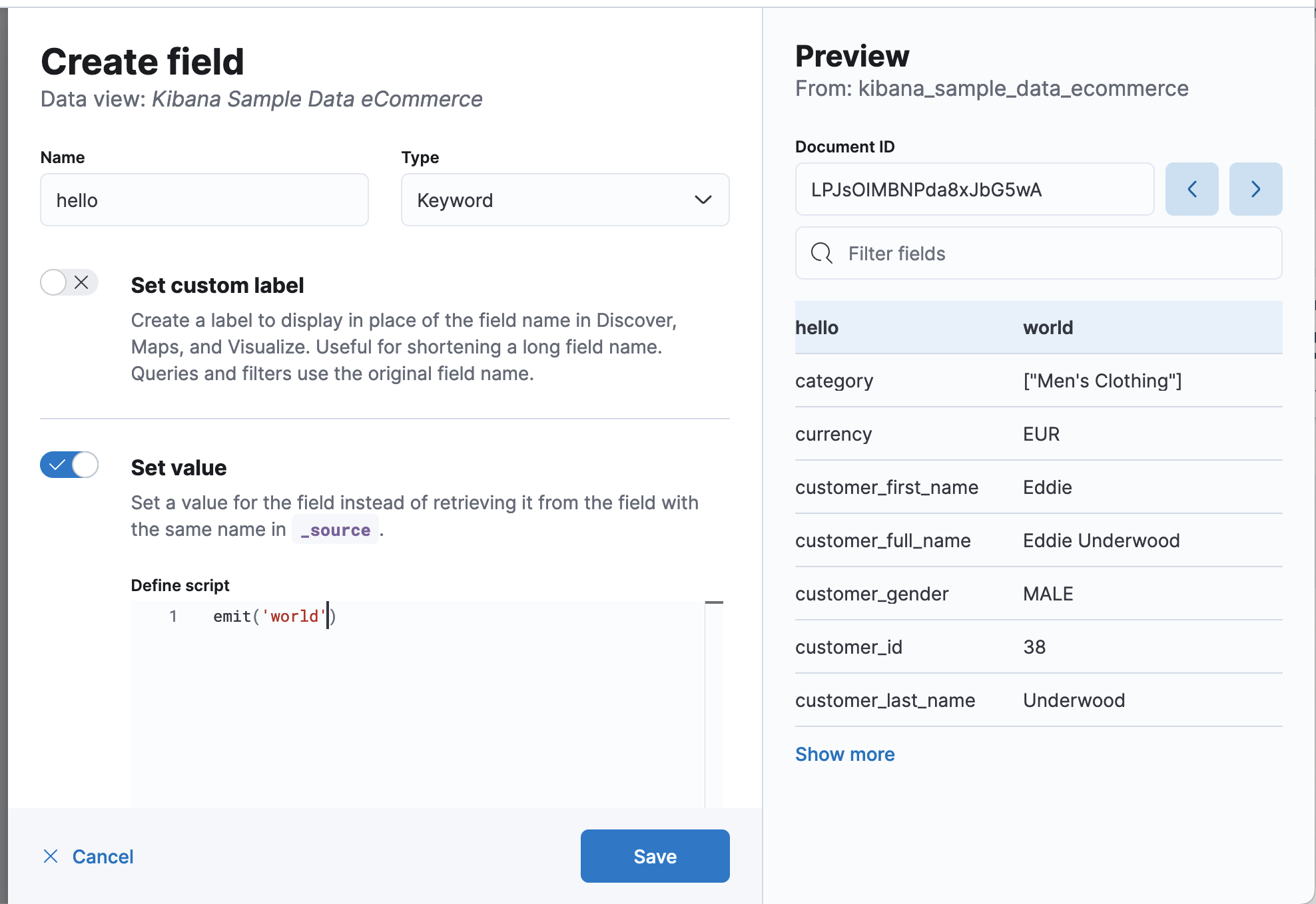

Add runtime fieldsedit
To add runtime fields to your data views, open the data view you want to change, then define the field values by emitting a single value using the Painless scripting language. You can also add runtime fields in Discover and Lens.
- Open the main menu, then click Stack Management > Data Views.
- Select the data view that you want to add the runtime field to, then click Add field.
- Enter the field Name, then select the Type.
- Select Set custom label, then enter the label you want to display where the data view is used, such as Discover.
- Select Set value, then define the script. The script must match the Type, or the data view fails anywhere it is used.
To help you define the script, use the Preview:
- To view the other available fields, use the Document ID arrows.
- To filter the fields list, enter the keyword in Filter fields.
To pin frequently used fields to the top of the list, hover over the field,
then click
- Click Create field.

Return a keyword valueedit
Return Hello World!
emit("Hello World!");

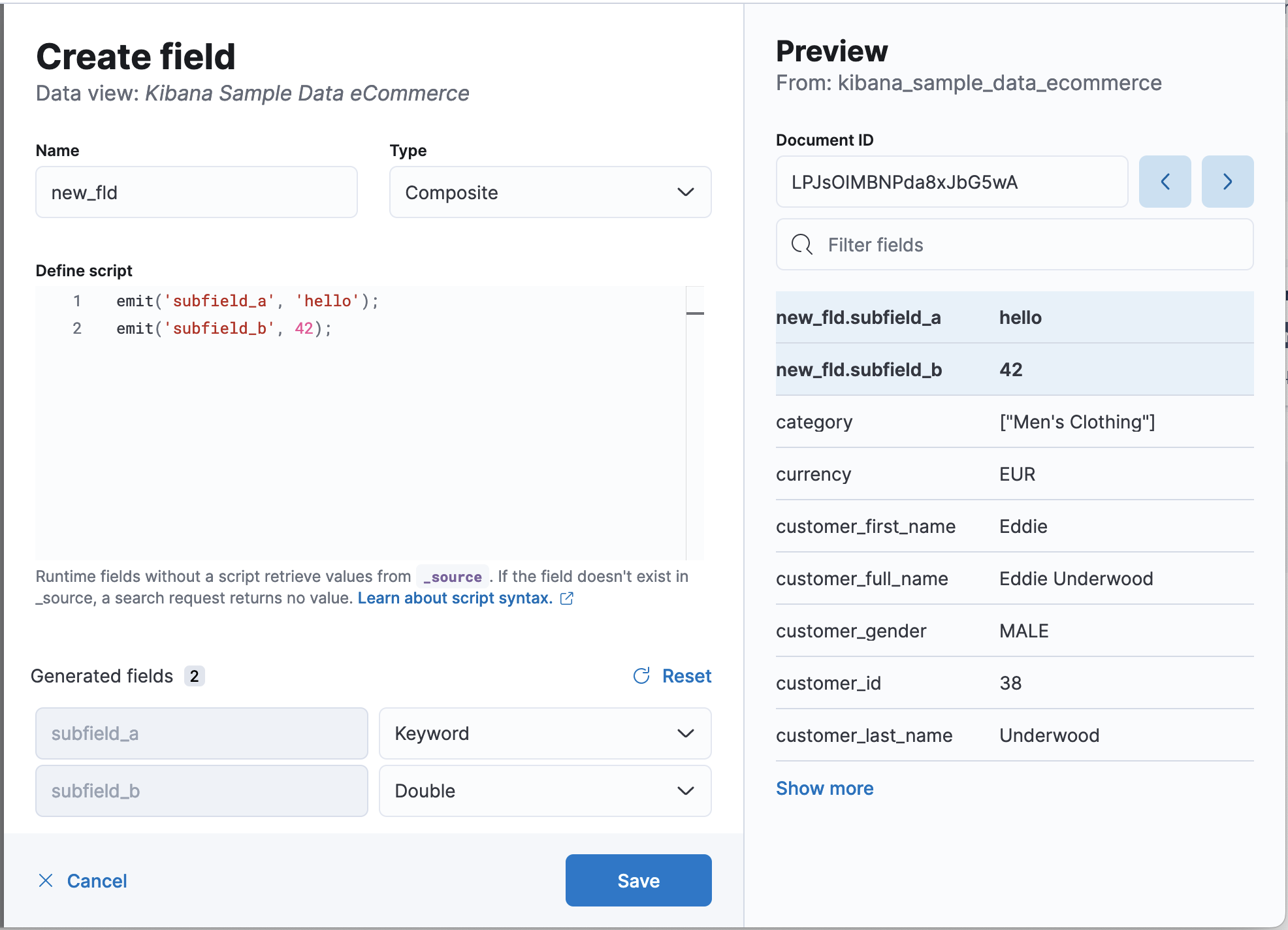

Return multiple fields with a composite runtime fieldedit
A single runtime field can also produce multiple subfields when the type Composite
is selected. The script editor provides default types that can be customized for each subfields.
Return keyword
and double
type subfields. Note that the first argument for emit
is the name of the subfield.
emit('subfield_a', 'Hello'); emit('subfield_b', 42);
