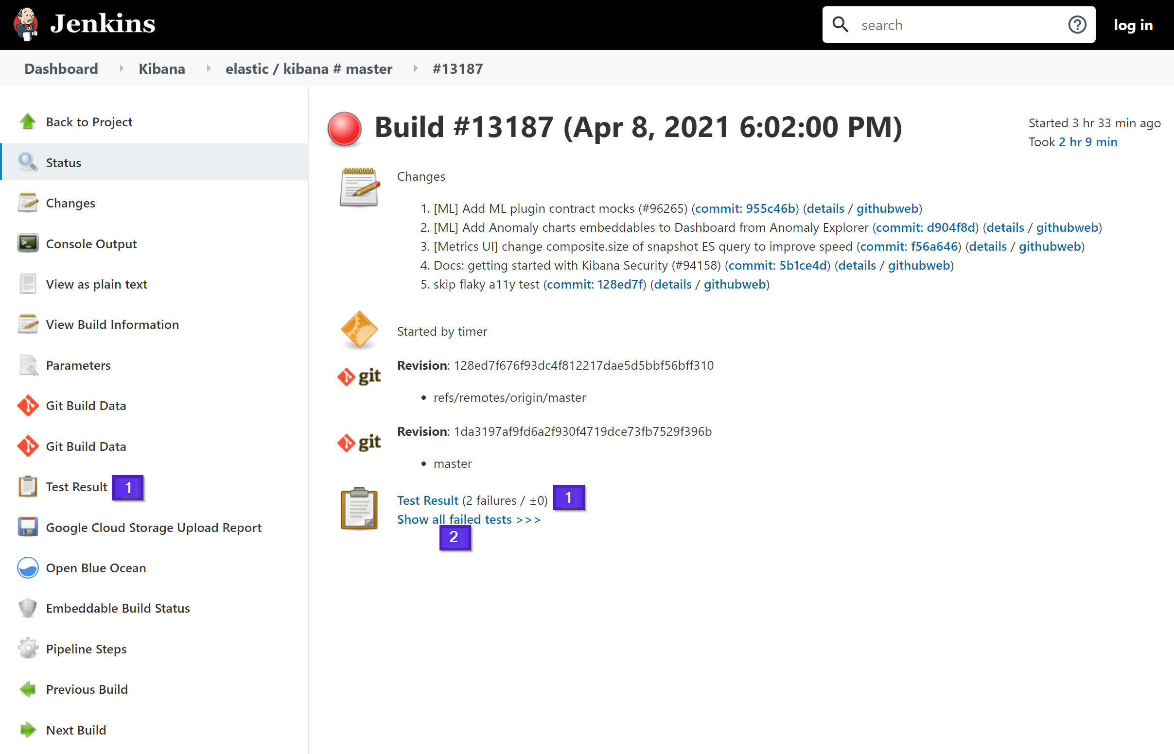

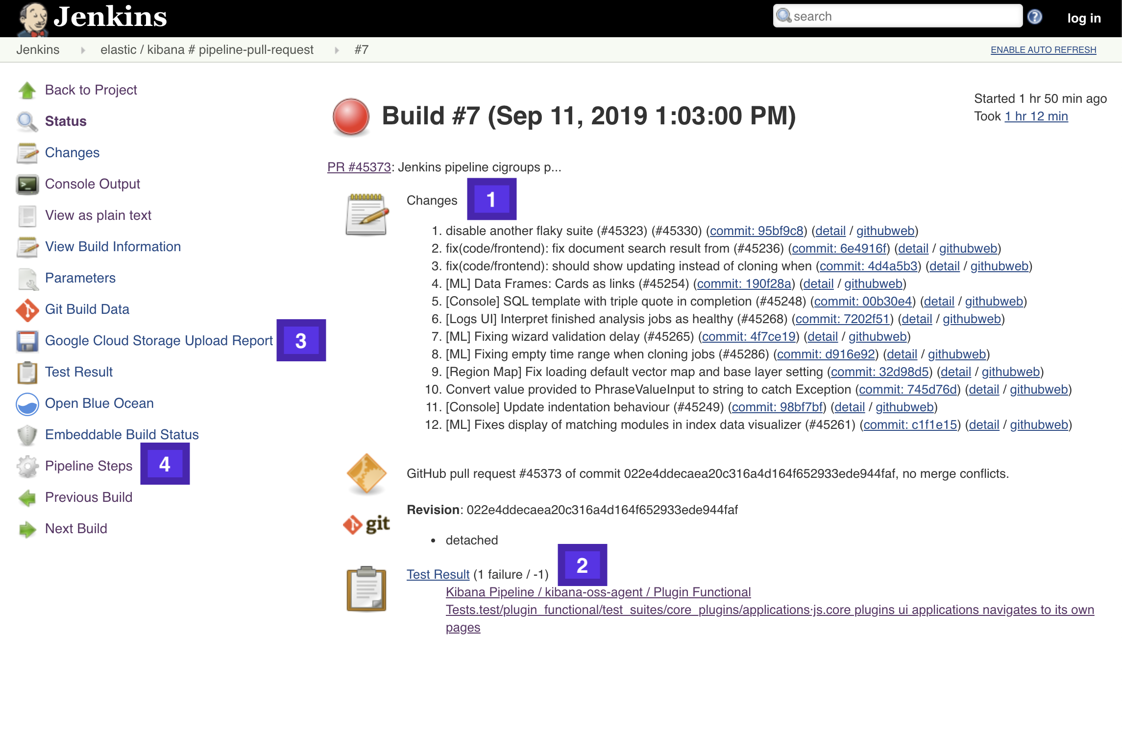

editTo view the results of a job execution in Jenkins, either click the link in the comment left by @elasticmachine or search for the kibana-ci check in the list at the bottom of the PR. This link will take you to the top-level page for the specific job execution that failed.
- Git Changes: the list of commits that were in this build which weren’t in the previous build. For Pull Requests this list is calculated by comparing against the most recent Pull Request which was tested, it is not limited to build for this specific Pull Request, so it’s not very useful.
- Test Results: A link to the test results screen, and shortcuts to the failed tests. Functional tests capture and store the log output from each specific test, and make it visible at these links. For other test runners only the error message is visible and log output must be tracked down in the Pipeline Steps.
- Google Cloud Storage (GCS) Upload Report: Link to the screen which lists out the artifacts uploaded to GCS during this job execution.
- Pipeline Steps:: A breakdown of the pipeline that was executed, along with individual log output for each step in the pipeline.

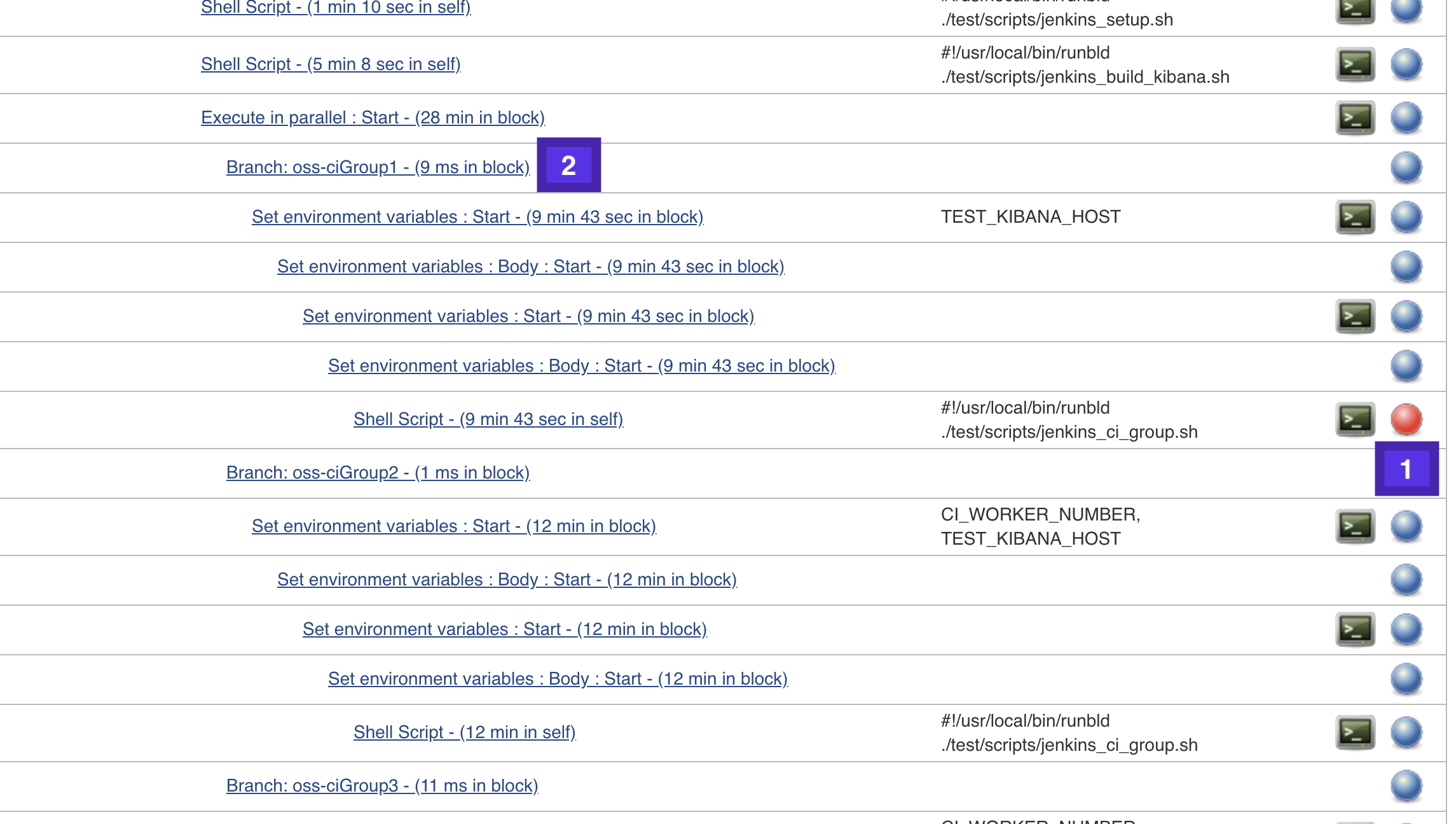

editTo view the logs for a failed specific ciGroup, jest, type checkers, linters, etc., click on the Pipeline Steps link in from the Job page.
Scroll down the page until you find a failed step (1), and then look up a few lines for the Branch: step to see which specific job this is. If this is the job you’re looking for click the little terminal icon next to the failed step (1) to view the logs for that specific step in the Pipeline.

editThe logs in Pipeline Steps contain Info level logging. To debug Functional UI tests it’s usually helpful to see the debug logging. You can go to the list of all tests including failures (1), or directly to the failures (2).

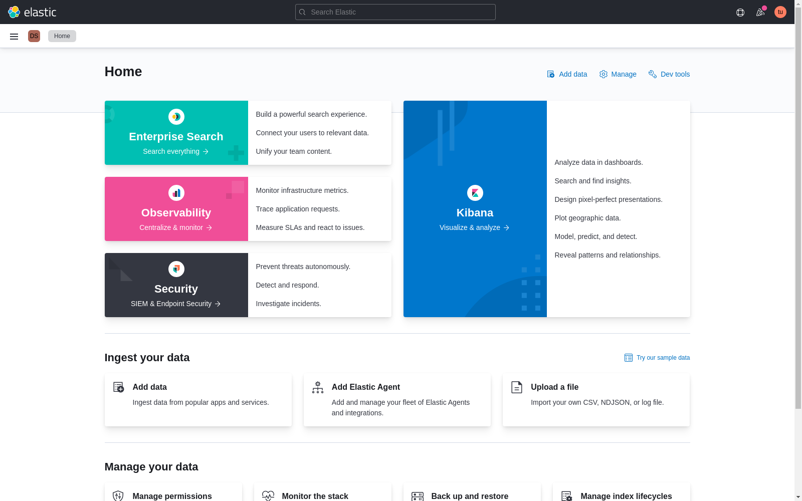

Just above the ✖ fail: line, there is a line info Taking screenshot ... which tells us the name of the screenshot to look for in the Google Cloud Storage (GCS) Upload Report:
Clicking the [Download] link for that png shows this image:

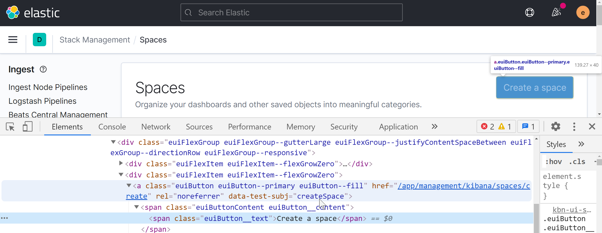

If we use a running Kibana instance and inspect elements, we find that the createSpace data-test-subj attribute is on this button in the Spaces page in Stack Management:
We know the test was not on the correct page to find the element to click. We see in the debug log the repeated attempts to find the element. If we scroll to the start of those repeated attempts, we see that the first thing the test did was this attempt to click on the createSpace element.
