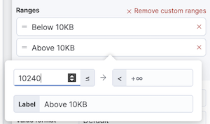

To select documents based on the number range of a field, use the Intervals function. When the ranges are non numeric, or the query requires multiple clauses, you could use the Filters function.
Specify the file size ranges:
  1. In the layer pane, click bytes.
  2. Click Create custom ranges, enter the following in the Ranges field, then press Return:
    • Ranges — 0 → 10240
    • Label — Below 10KB
  3. Click Add range, enter the following, then press Return:
    • Ranges — 10240 → +∞
    • Label — Above 10KB
      Custom ranges configuration
  4. From the Value format dropdown, select Bytes (1024), then click Close.
