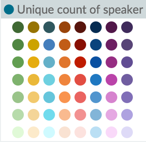

You can customize the colors of your visualization by clicking the color dot next to each label to display the color picker.
An array of color dots that users can select
Enter a string in the Custom Label field to change the display label.
