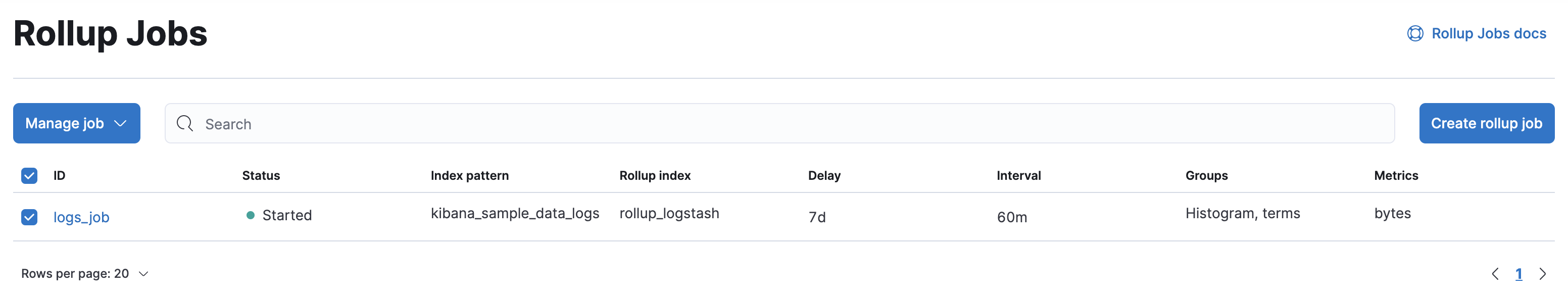

To get started, open the main menu, then click Stack Management > Rollup Jobs.
List of currently active rollup jobs

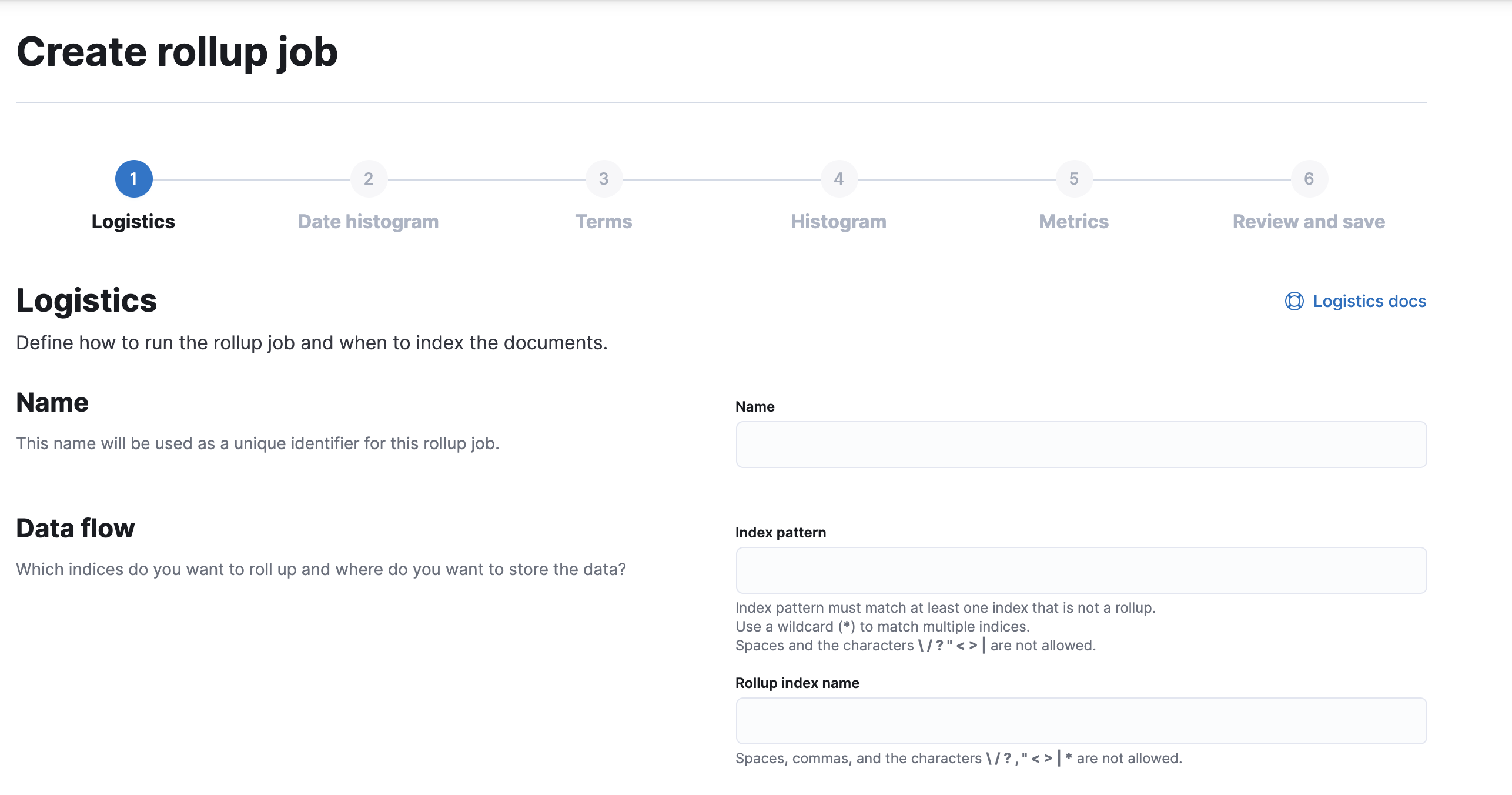

Kibana makes it easy for you to create a rollup job by walking you through the process. You fill in the name, data flow, and how often you want to roll up the data. Then you define a date histogram aggregation for the rollup job and optionally define terms, histogram, and metrics aggregations.
When defining the index pattern, you must enter a name that is different than the output rollup index. Otherwise, the job will attempt to capture the data in the rollup index. For example, if your index pattern is metricbeat-*, you can name your rollup index rollup-metricbeat, but not metricbeat-rollup.

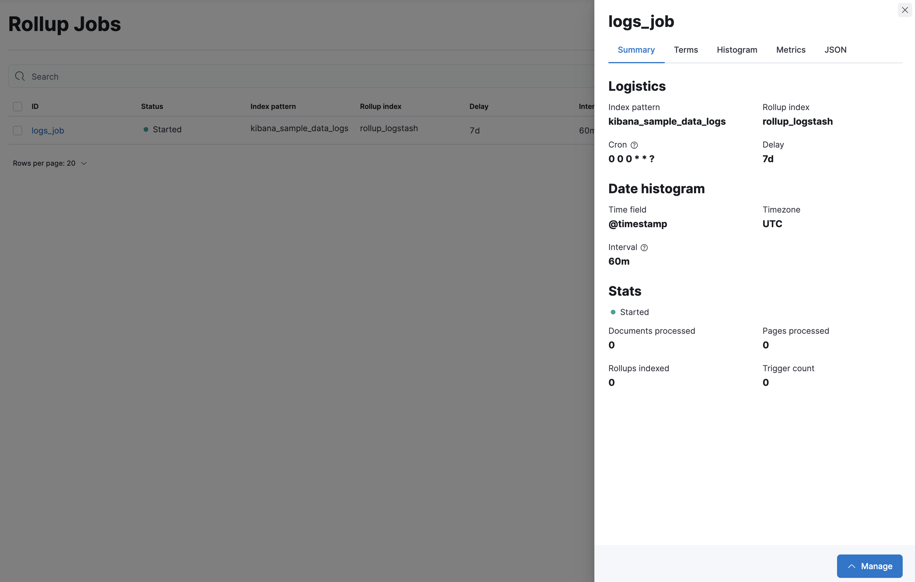

Once you’ve saved a rollup job, you’ll see it the Rollup Jobs overview page, where you can drill down for further investigation. The Manage menu enables you to start, stop, and delete the rollup job. You must first stop a rollup job before deleting it.
Rollup job details
You can’t change a rollup job after you’ve created it. To select additional fields or redefine terms, you must delete the existing job, and then create a new one with the updated specifications. Be sure to use a different name for the new rollup job—reusing the same name can lead to problems with mismatched job configurations. You can read more at rollup job configuration.

As you walk through the Create rollup job UI, enter the data:
Field Value
Name
logs_job
Index pattern
kibana_sample_data_logs
Rollup index name
rollup_logstash
Frequency
Every minute
Page size
1000
Latency buffer
7d
Date field
@timestamp
Time bucket size
60m
Time zone
UTC
Terms
geo.src, machine.os.keyword
Histogram
bytes, memory
Histogram interval
1000
Metrics
bytes (average)
On the Review and save page, click Start job now and Save.

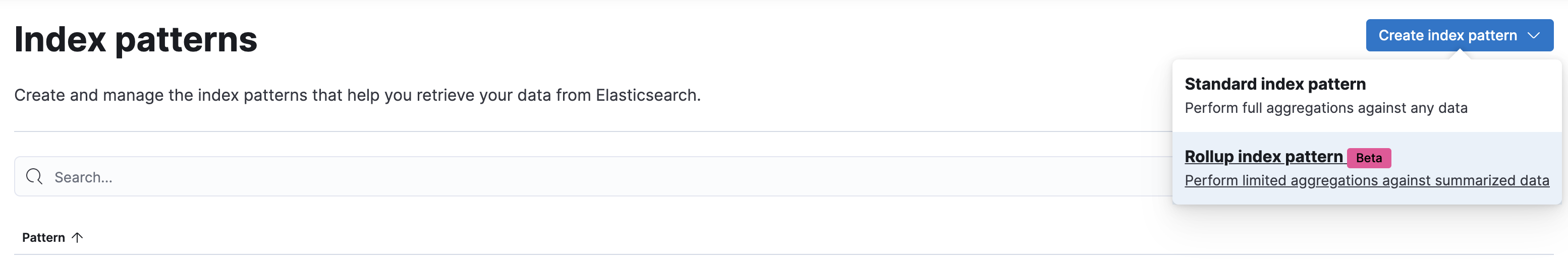

  1. Open the main menu, then click Stack Management > Index Patterns.
  2. Click Create index pattern, and select Rollup index pattern from the dropdown.
    ][Create rollup index pattern
  3. Enter rollup_logstash,kibana_sample_logs as your Index Pattern and @timestamp as the Time Filter field name.
    The notation for a combination index pattern with both raw and rolled up data is rollup_logstash,kibana_sample_data_logs. In this index pattern, rollup_logstash matches the rolled up index pattern and kibana_sample_data_logs matches the index pattern for raw data.

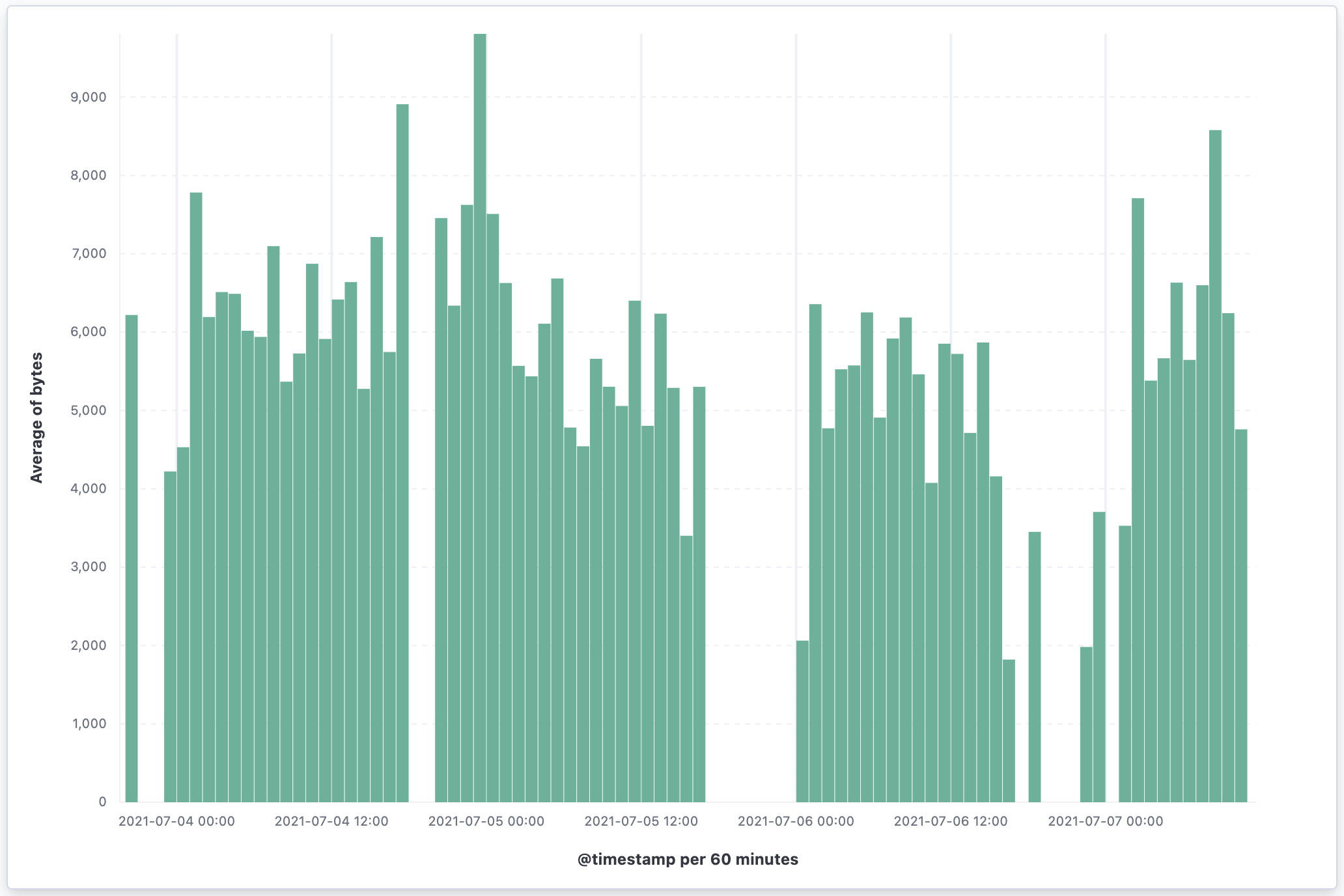

  8. Select Bar vertical stacked in the chart type dropdown.
  9. Add the @timestamp field to the Horizontal axis.
  10. Add the bytes field to the Vertical axis, defaulting to an Average of bytes.
    Kibana creates a vertical bar chart of your data. Select a section of the chart to zoom in.
