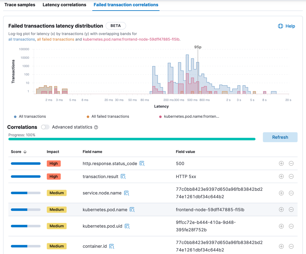

Find failed transaction correlationsedit
The correlations on the Failed transaction correlations tab help you discover
which attributes are most influential in distinguishing between transaction
failures and successes. In this context, the success or failure of a transaction
is determined by its event.outcome
value. For example, APM agents set the event.outcome
to failure
when an HTTP
transaction returns a 5xx
status code.
The chart highlights the failed transactions in the overall latency distribution for the transaction group. If there are attributes that have a statistically significant correlation with failed transactions, they are listed in a table. The table is sorted by scores, which are mapped to high, medium, or low impact levels. Attributes with high impact levels are more likely to contribute to failed transactions. By default, the attribute with the highest score is added to the chart. To see a different attribute in the chart, select its row in the table.
For example, in the screenshot below, there are attributes such as a specific node and pod name that have medium impact on the failed transactions.
![Failed transaction correlations](apm/images/correlations-failed-transactions.png)
Select the +
filter to create a new query in the APM app for transactions
with one or more of these attributes. If you are unfamiliar with a field, click
the icon beside its name to view its most popular values and optionally filter
on those values too. Each time that you add another attribute, it is filtering
out more and more noise and bringing you closer to a diagnosis.
